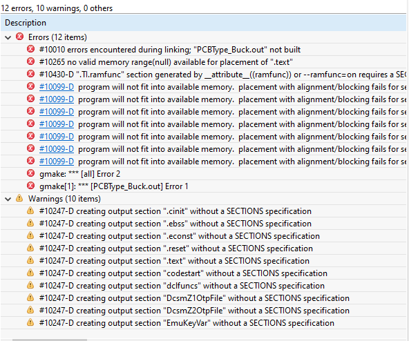

  • Richard,
    Thank you for your help.
    1. The problem is solved.
    2. First of all, I cannot understand which lines, sections etc. to be added to linker command file. The file is very complicated, if I add some lines it would give errors. Therefore, firstly, before trying to add some dclfunc sections, I just tried to change the linker command file as you offered.
    When I used "F2837xD_Headers_nonBIOS_cpu1.cmd" at c2000 folder instead of "2837x_RAM_lnk_cpu1" which is found at "C:\ti\ccs930\ccs\ccs_base\c2000\include" location, the errors and warnings occured as below figure.  (Note. No extra dclfuncs sections written.)
    (error #10430-D: ".TI.ramfunc" section generated by __attribute__((ramfunc)) or --ramfunc=on requires a SECTIONS specification to function.)
    3. At F28069_PID project, the linker command file is a file called "F28069_DCL.cmd". Therefore, I have two questions here
    3.1 While "F2837xD_Headers_nonBIOS_cpu1.cmd" is added to my project, do you offer me to directly use "F28069_DCL.cmd" file as a linker cmd file?
    3.2 Do you offer me to remowe "F2837xD_Headers_nonBIOS_cpu1.cmd" and use "F28069_DCL.cmd" instead?
    I really got confused about linker issue.
  • I did not mean, or say, to remove your existing linker command file.  I only said "... to add another linker file to your project.".  You need two linker command files - one to define where the generic program sections are placed, the other to define placement of the memory mapped registers.  Please take a look at the example I recommended - there are two .cmd files.
    To summarize, this is what you do:
    • You keep the linker command file you already had: "2837x_RAM_lnk_cpu1.cmd",  You only need to add dclfuncs to this file, as described in the other thread.  Do not add "F28069_DCL.cmd" - that's just the example.
    • You add the file "F2837xD_Headers_nonBIOS_cpu1.cmd" to your project.  Do not change it.
    Your linker warnings and build error should go away when you do this.
    Richard

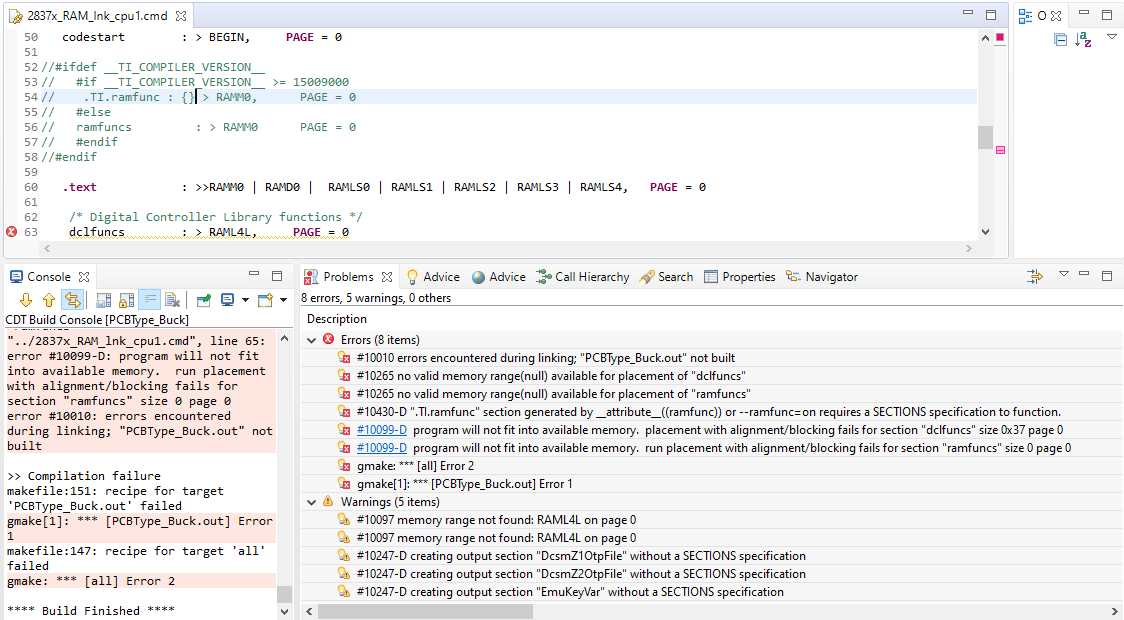

    I got what I need to do.
    • I keept my linker file "2837x_RAM_lnk_cpu1.cmd", and added some dclfuncs lines which is shown as below.  I commented ramfuncs at beggining.
    • I added "F2837xD_Headers_nonBIOS_cpu1.cmd" to my project and no change.
    However, I got following errors and warnings.

  • You are almost there.  The error is because you have not defined the memory block called RAML4L.  Change RAML4L to something which exists, such as RAMLS4, and it should link correctly.  You'll need to do this for both 'dclfuncs' and 'ramfuncs'.
    Richard

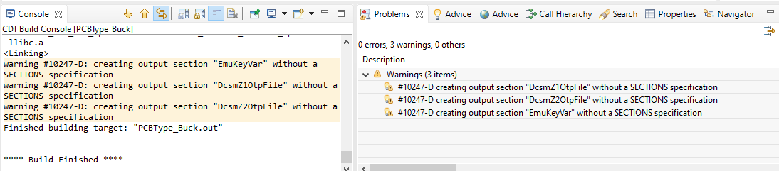

  • Dear Richard,
    Your offer solved my problem.. Thank you very much. I just have following warnings. How can I solve them?
  • You're welcome, and I'm glad you got it working.
    Regret I don't recognize those sections.  From their names I guess they have something to do with code security and booting.  There must be a header or source file in your project which is defining them in a #pragma; can you find them in your project and let me know the file name and where it came from please?  If it's TI reference software I can ask the author to comment.
    Otherwise, since they are warnings rather than errors your program may run correctly without worrying about them for the moment.  It's probably something you can return to later.
    Richard
  • It turns out these section names come from an older version of the support files for F28379D which was delivered in controlSUITE.  In newer versions of the support files, the DCSM OTP items have been removed and the EMU key items changed to fix a bug.  In my first reply to this thread I referenced the newest version of C2000Ware, so perhaps your older files became mixed in with the newer ones then?
    If you want a quick solution, then make sure you are using the linker command file "F2837xD_Headers_nonBIOS_cpu1.cmd" from your controlSUITE installation.  You'll also need the older versions of "globalvariabledefs.c" and "globalprototypes.h".
    However, the best way to fix this is to make sure you are using the latest versions of the support files, which are those in C2000Ware v3.01.  This way you take all the bug fixes we have done in later revisions.
    Richard
