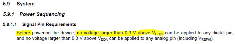

Is there a recommended power supply circuit that meets the following requirements?
The circuit diagram of LaunchPad converts 1.2V from 3.3V as follows.
However, I wasn't sure if this circuit could meet the specifications of the data sheet, because the protection diode was not connected.
Please let me know if there is a recommended power supply circuit.

  • Hi Sasaki,
    I believe you pasted the wrong requirement from the datasheet. Can you verify and re-post the section your concerned about?
    Maybe the below?
    I believe the LaunchPad power supply circuit should meet this requirement, but I can dig a little more just to double check. You may also want to look at the circuit used in the ControlCard. It uses step down converter TPS62420 for 5V --> 3.3V and 1.2V.

  • Hi Kevin-san,
    Thank you for your reply!
    Maybe the below?
    I made a mistake. The following is correct.
    C:\ti\c2000\C2000Ware_3_01_00_00\boards\controlCARDs\TMDSCNCD28379D\R1_3
    I got it.
    Let me reconfirm the following.
    Is this circuit a recommended circuit to meet this regulation?
    Sasaki

  • Kevin-san,
    This issue has been resolved.
    We believe that the power circuit of the ControlCard can satisfy the power down sequence.
    In addition, I think that it is better to divide the EN2 of TPS62420 by a resistor.
