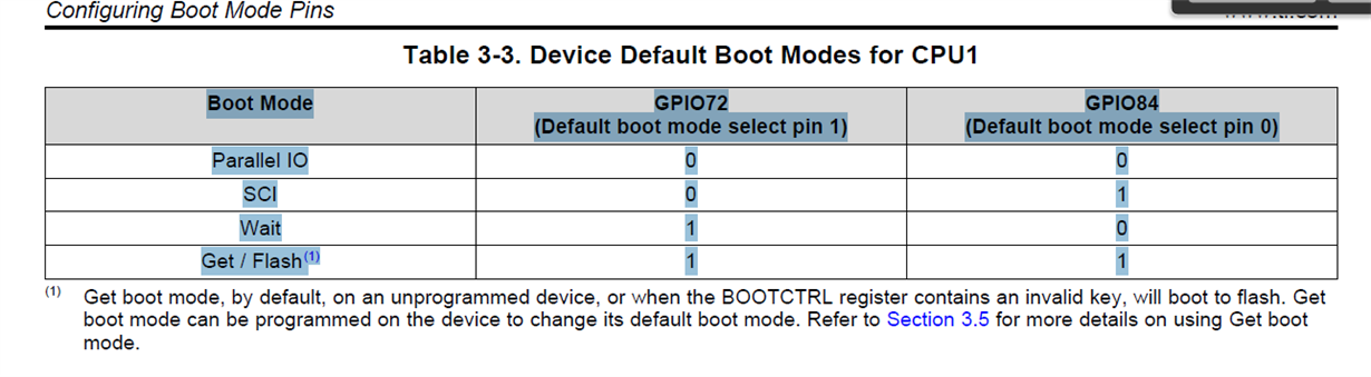

  • Hi Chris,
    thanks for your guide. i can find the source code for SCI and usb boot_rom.
    one question i still do not understand:
    1. when i want to upgrade firmware from SCI,
    first: i can choose the boot mode by two gpio,(gpio72 is 0 and gpio84 is 1), then reset mcu, it will boot from SCI refer to below figure
    second: and then use C2Prog.exe app or  ti provided app "serial_flash_programmer.exe"under "C:\ti\c2000\C2000Ware_1_00_05_00\utilities\flash_programmers\serial_flash_programmer" to upgrade firmware.
    third: after upgrading firmware complete, change back gpio72 to 1 and gpio84 to 1. then reset mcu, it will boot from Flash by default.
    the procedure for SCI bootloader is very clear to understand.
    for usb bootloader, i think it should be the same procedure as SCI bootloader. am i right?
    so:

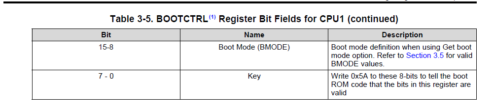

    2. when i want to upgrade firmware from usb,
    first: we should choose the boot mode by two gpio72 and gpio84(both are set to 1), and it will boot from Get boot mode,
    and then change BOOTCTRL in OTP value to set Key with 0x5A and BMODE with use boot(in standalone mode).
    My question is: OTP is one-time program and can not be changed frequently. so how can i enter usb boot mode frequently and choose back to boot from flash when firmware upgrade complete?
  • if can not enter usb boot mode by change BOOTCTRL in OTP, how can it enter usb boot mode?

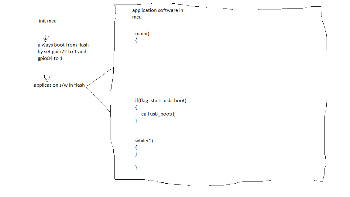

  • one solution provided by Sal in below figure:
    according to Sal's suggestion,  i draw the s/w flow chart in below. pls kindly give your comment. thanks.
  • Feng
    Yes, you want to follow Sal's suggestion. So you'll use the boot select pins to switch to SCI boot when needed, otherwise you boot to flash. Within the flash, as you laid out, you decide if you need to call the USB bootloader or not.
    Other option is to always to boot flash and have an additional decision point in the application code to call the SCI bootloader or USB bootloader.
    Best regards
    Chris

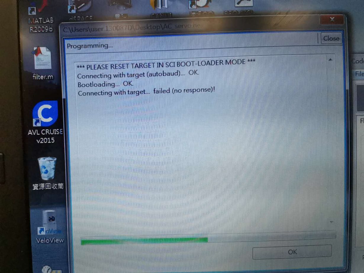

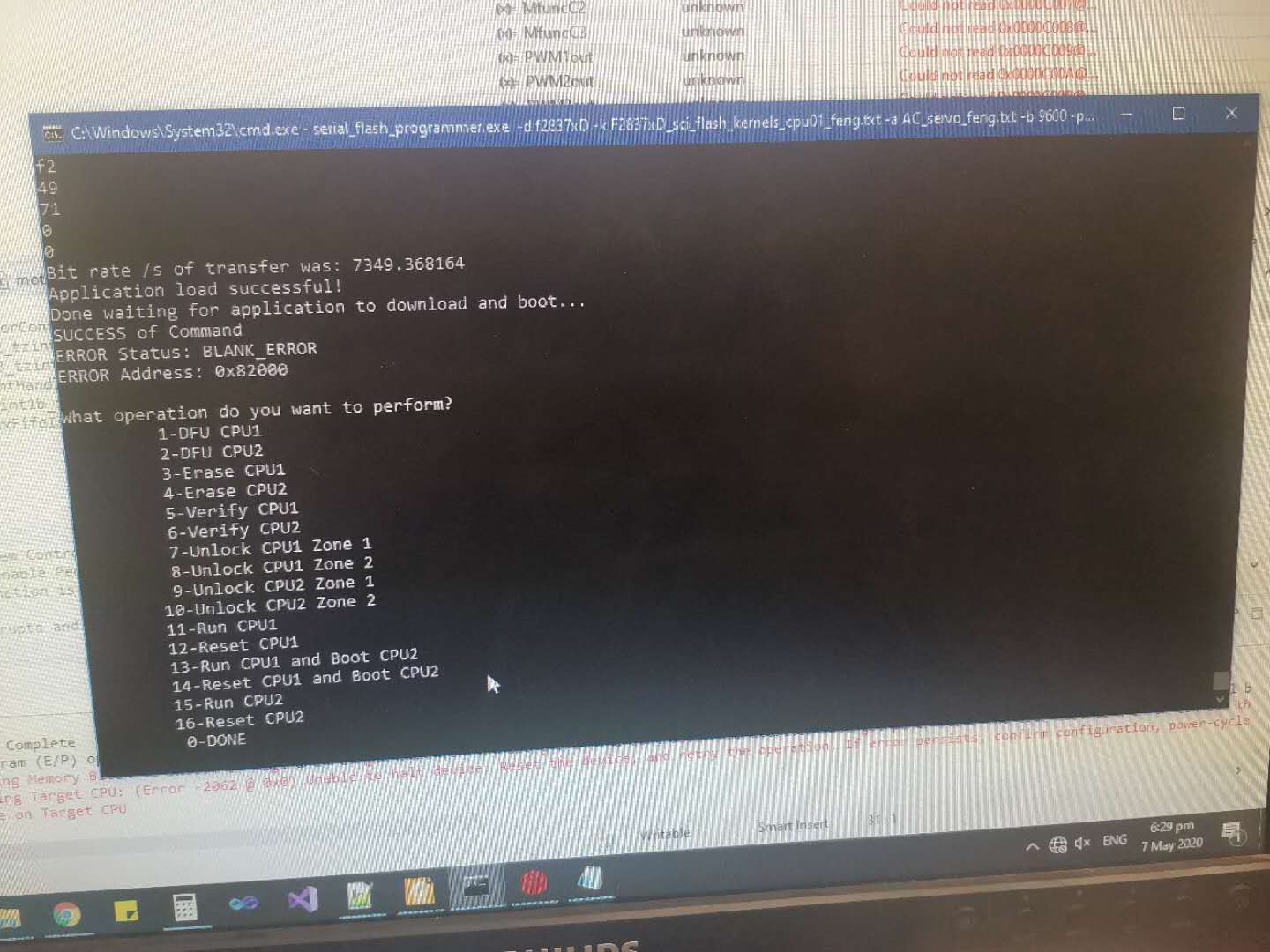

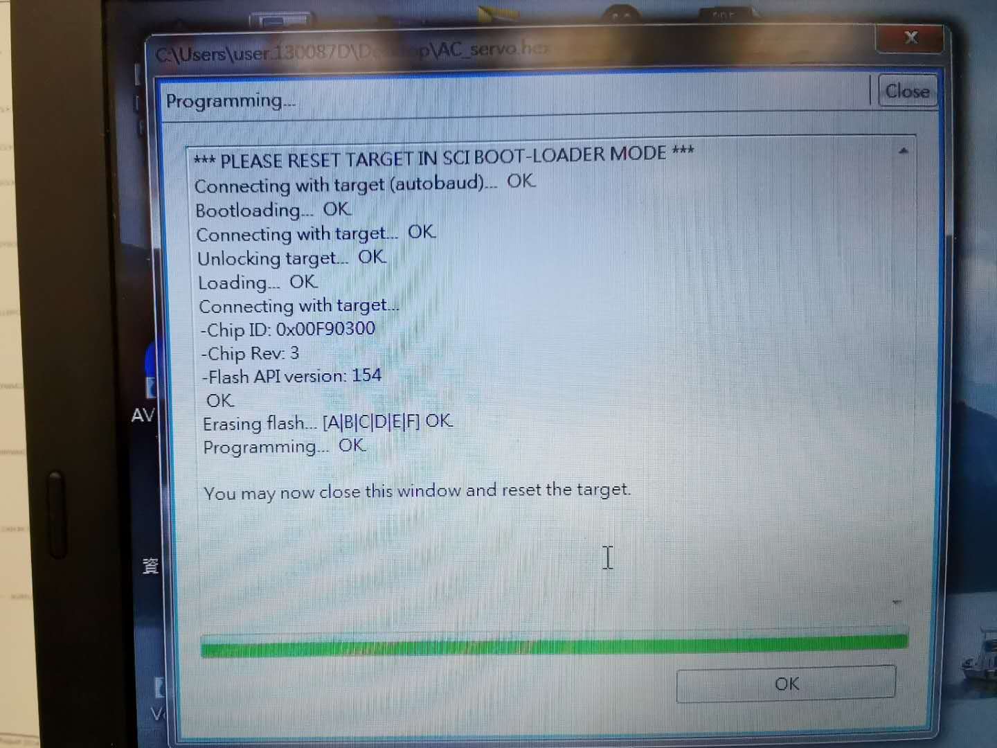

  • Hi Chriss,
    some progress updated to you:
    1. when branch to SCI boot by two gpio with gpio72==High and gpio84==Low,
    use C2Prog.exe to program the mcu, then the result is OK. pls refer to below figure:
    2.when branch to SCI boot from flash by calling func SCI_Boot(0),
    use C2Prog.exe to program the mcu, then the result is FAIL. pls refer to below figure:
    any suggestion for me to debug this?
    Feng

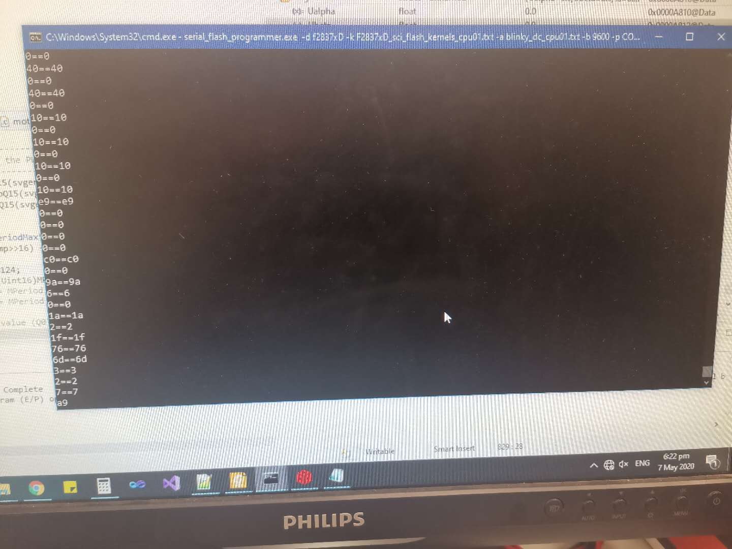

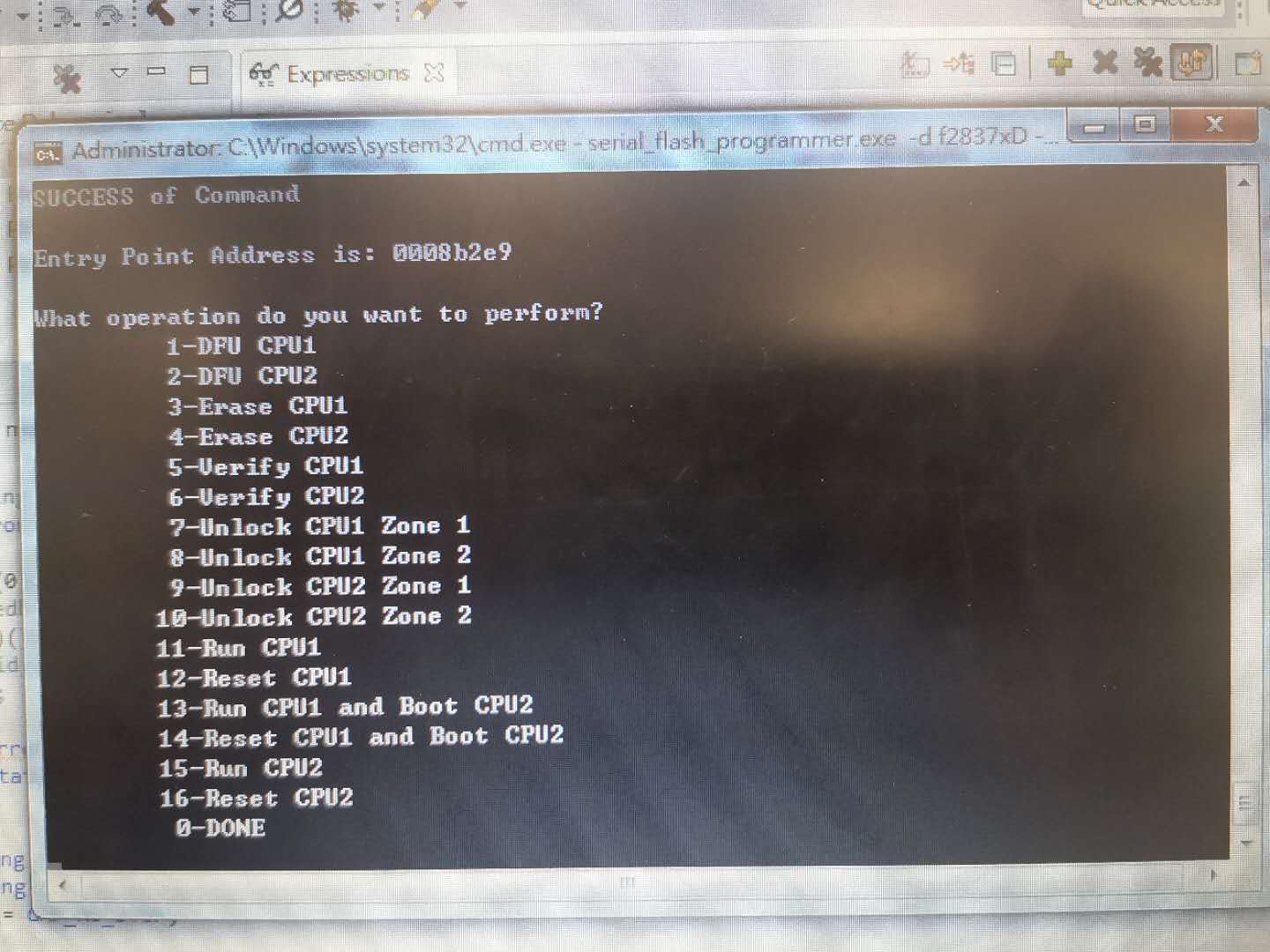

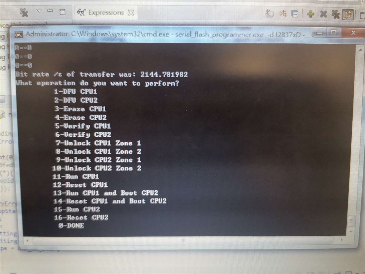

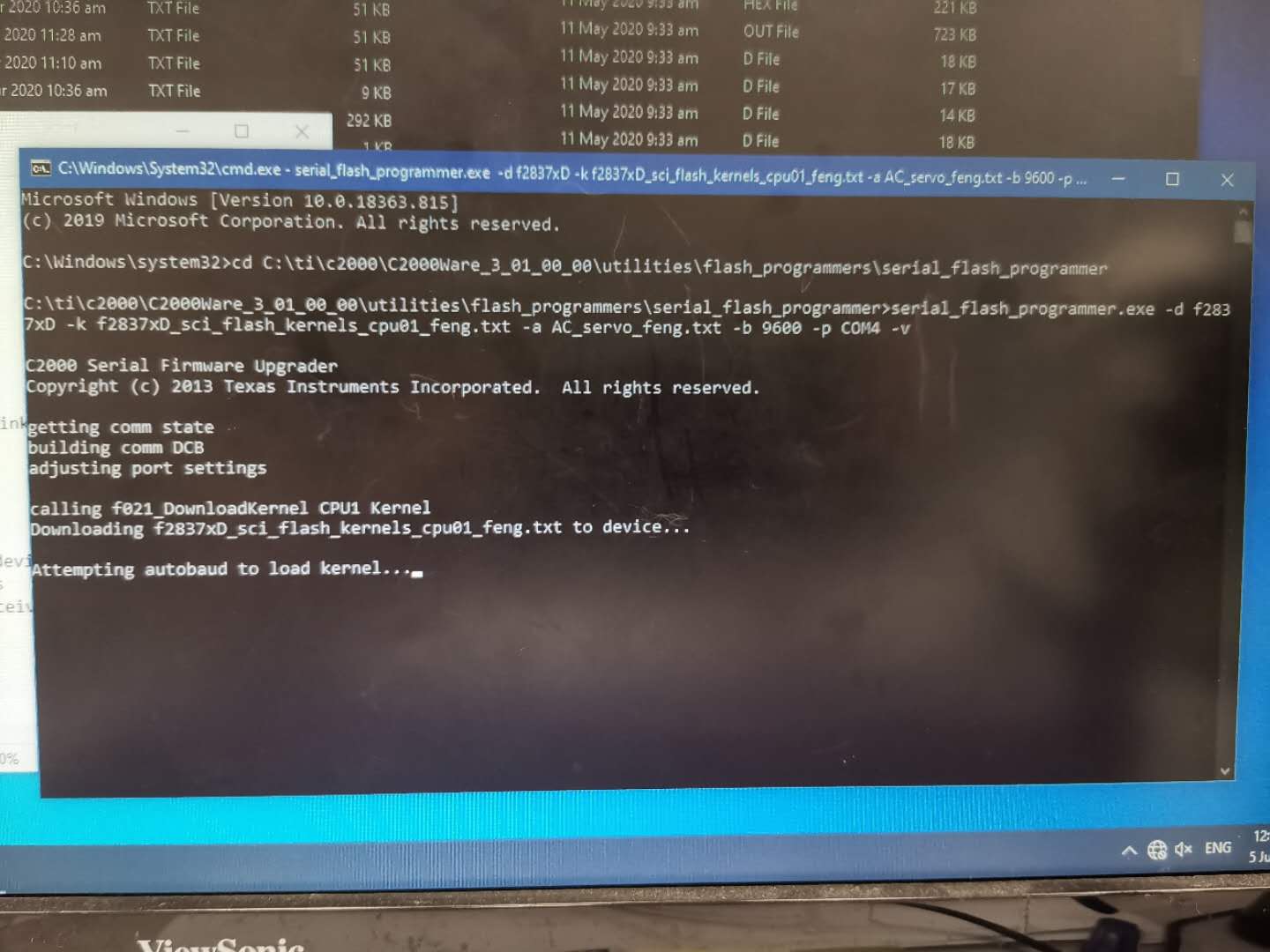

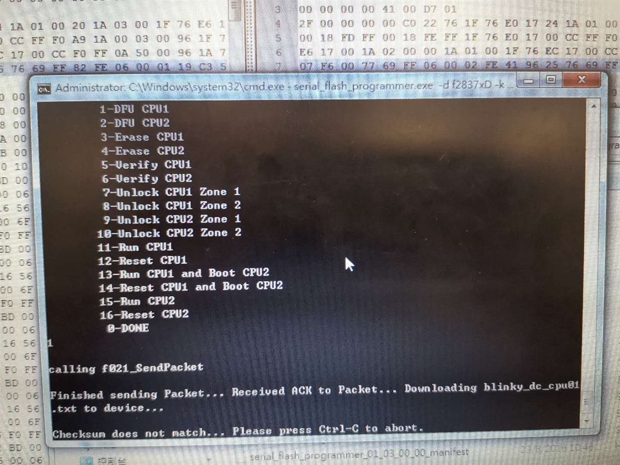

  • more progress updated to you:
    1. branch to SCI boot by gpio and use serial_flash_programmer.exe to program the mcu
    and the result is OK. pls see below figures
    step 1: it stop at below after execute serial_flash_programmer.exe
    step2: select "1" and when programming finished, it stops at the below:

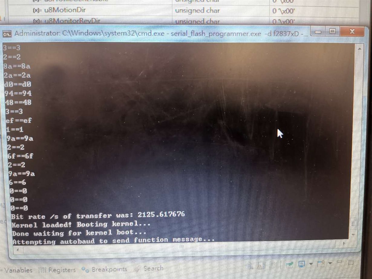

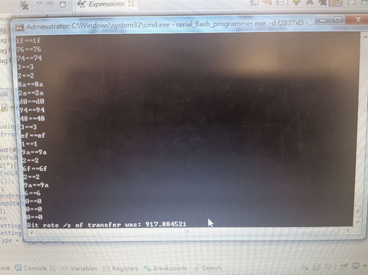

    2. branch to SCI boot by calling SCI-Boot() in flash and use serial_flash_programmer.exe to program the mcu
    and the result is FAIL. pls see below figures
    step 1: it stop at below after execute serial_flash_programmer.exe and halted, and has no any response anymore.
     would you pls give further advice? thanks.

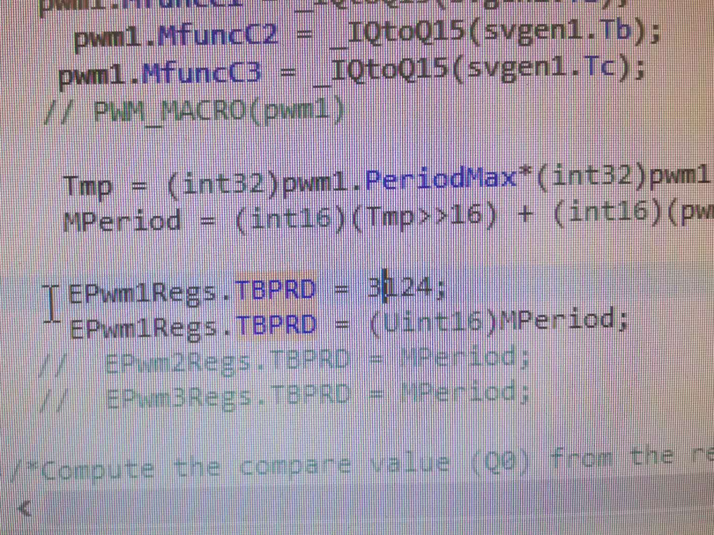

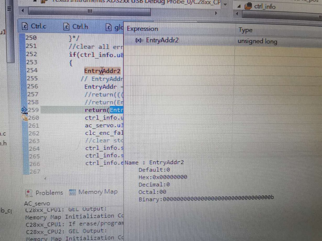

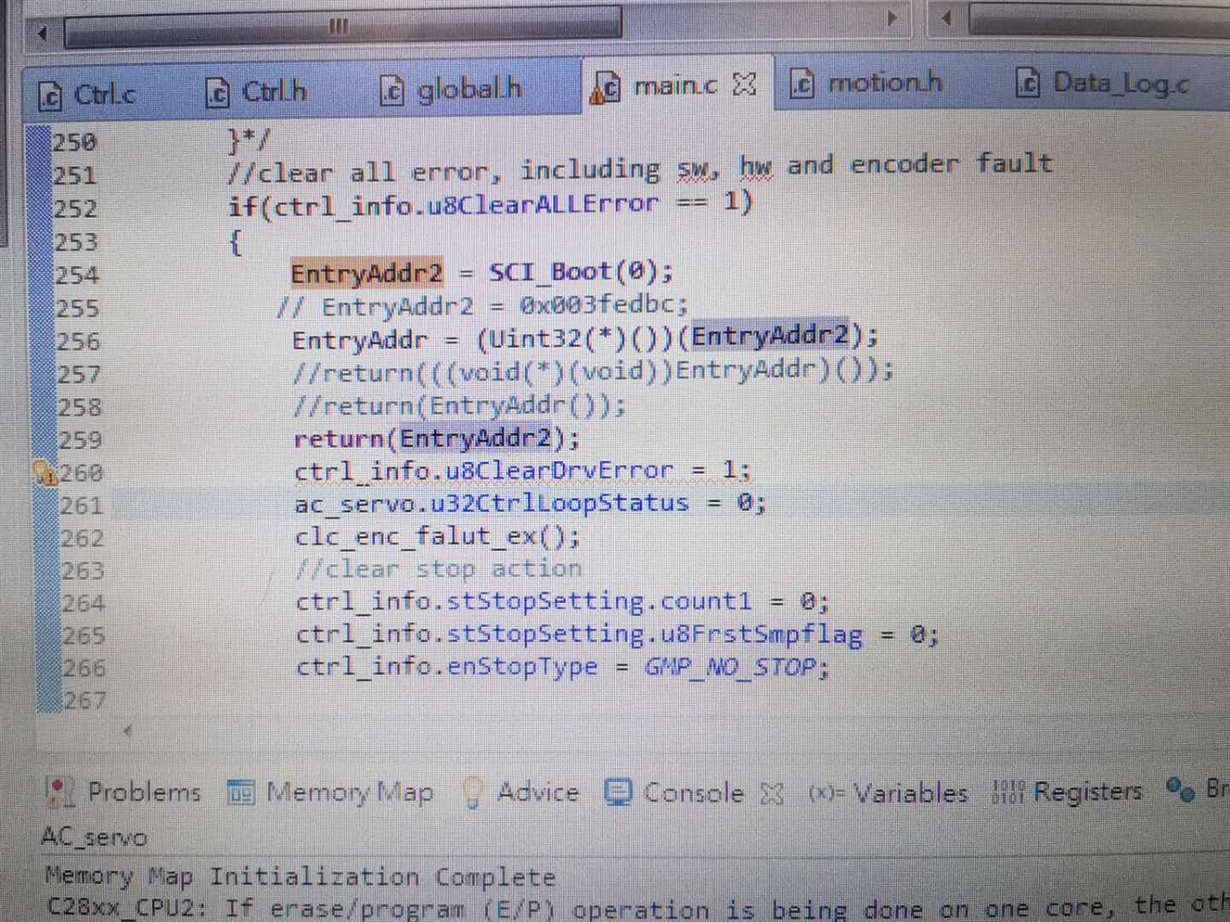

    3. my source code to call SCI_Boot() in flash:
    and I can see the return address when calling SCI_Boot(0) is 0x00000000. pls refer to below, is this correct?
    Feng
  • Feng
    Alright, lets debug using the serial flash programmer as I am more familiar. I'm fairly confident that when we resolve that, C2Prog will then also work.
    Can you re-run using the serial flash programmer with "-v" as part of command to enable verbose diagnostics?
    When you run with the SCI bootloader being called from flash, you're doing the same order? In terms of order I mean, the SCI bootloader is receiving the kernel and then kernel is receiving the application?
    I'd also check that your flash app and the kernel that is being loaded to RAM via the SCI bootloader call aren't trying to use the same RAM space. This is currently my most likely theory.
    Best regards
    Chris

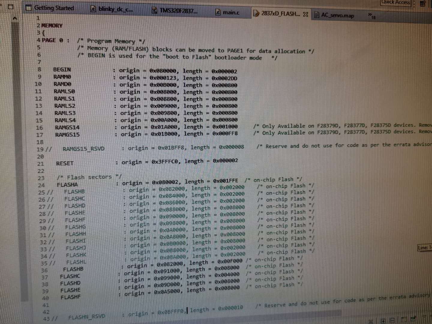

    Feng: how to check that?  I think it should be related with cmd file,so I attach it for your reference. and pls give me more details.
    Looking forward to you.
    Feng
    https://e2e.ti.com/cfs-file/__key/communityserver-discussions-components-files/171/2837xD_5F00_FLASH_5F00_lnk_5F00_cpu1.7z
  • Feng
    You should look at the kernel linker cmd file and the app that calls the SCI boot. It is likely they at least sharing the same stack memory (look in the SECTIONs part of the linker cmd file). Try re-assiging one of those to a different location.

  • Hi Chris,
    Feng: I will try to re-assign but too many of RAM are overlapped between app and kernel cmd.

  • Hi Chris,
    I reassign the cmd. pls find them in attached and help check whether it is correct or not.
    since I use the default kernel provided by ti under "C:\ti\controlSUITE\device_support\~Utilities\serial_flash_programmer", so I think it should be generated by the project under "C:\ti\controlSUITE\device_support\F2837xD\v170(or other version)\F2837xD_examples_Dual\F2837xD_sci_flash_kernels\cup01".
    so the "kernel.cmd" is from "C:\ti\controlSUITE\device_support\F2837xD\v170(or other version)\F2837xD_examples_Dual\F2837xD_sci_flash_kernels\cup01"

    //   RAMGS_ALL2   : origin = 0x011000, length = 0x003F00//0x006000
    /*   RAMGS3      : origin = 0x00F000, length = 0x001000
       RAMGS4      : origin = 0x010000, length = 0x001000
       RAMGS5      : origin = 0x011000, length = 0x001000
       RAMGS6      : origin = 0x012000, length = 0x001000
       RAMGS7      : origin = 0x013000, length = 0x001000
       RAMGS8      : origin = 0x014000, length = 0x001000
       RAMGS9      : origin = 0x015000, length = 0x001000
       RAMGS10     : origin = 0x016000, length = 0x001000
       RAMGS11     : origin = 0x017000, length = 0x001000
       RAMGS12     : origin = 0x018000, length = 0x001000
       RAMGS13     : origin = 0x019000, length = 0x001000*/
       CPU2TOCPU1RAM   : origin = 0x03F800, length = 0x000400
       CPU1TOCPU2RAM   : origin = 0x03FC00, length = 0x000400
    SECTIONS
       /* Allocate program areas: */
       .cinit              : > FLASHB      PAGE = 0, ALIGN(4)
       .pinit              : > FLASHB,     PAGE = 0, ALIGN(4)
       .text               : >> FLASHB | FLASHC | FLASHD | FLASHE      PAGE = 0, ALIGN(4)
       codestart           : > BEGIN       PAGE = 0, ALIGN(4)
       ramfuncs            : LOAD = FLASHD,
                             RUN = RAMLS0 | RAMLS1 | RAMLS2 |RAMLS3,
                             LOAD_START(_RamfuncsLoadStart),
                             LOAD_SIZE(_RamfuncsLoadSize),
                             LOAD_END(_RamfuncsLoadEnd),
                             RUN_START(_RamfuncsRunStart),
                             RUN_SIZE(_RamfuncsRunSize),
                             RUN_END(_RamfuncsRunEnd),
                             PAGE = 0, ALIGN(4)
       /* Allocate uninitalized data sections: */
       .stack              : > RAMM1        PAGE = 1
       .ebss               : >> RAMLS5 | RAMGS0 | RAMGS1 |RAMGS_ALL       PAGE = 1
       .esysmem            : > RAMLS5       PAGE = 1
       /* Initalized sections go in Flash */
       .econst             : >> FLASHF | FLASHG | FLASHH      PAGE = 0, ALIGN(4)
       .switch             : > FLASHB      PAGE = 0, ALIGN(4)
       .reset              : > RESET,     PAGE = 0, TYPE = DSECT /* not used, */
       Filter_RegsFile     : > RAMGS0,	   PAGE = 1
       SHARERAMGS0		: > RAMGS0,		PAGE = 1
       SHARERAMGS1		: > RAMGS1,		PAGE = 1
       ramgs0           : > RAMGS0,     PAGE = 1
       ramgs1           : > RAMGS1,     PAGE = 1
    #ifdef __TI_COMPILER_VERSION
    	#if __TI_COMPILER_VERSION >= 15009000
    	.TI.ramfunc : {} LOAD = FLASHD,
    						 PAGE = 0, ALIGN(4)
    	#endif
    #endif
       /* The following section definitions are required when using the IPC API Drivers */
        GROUP : > CPU1TOCPU2RAM, PAGE = 1
            PUTBUFFER
            PUTWRITEIDX
            GETREADIDX
        GROUP : > CPU2TOCPU1RAM, PAGE = 1
            GETBUFFER :    TYPE = DSECT
            GETWRITEIDX :  TYPE = DSECT
            PUTREADIDX :   TYPE = DSECT
       /* The following section definition are for SDFM examples */
       Filter1_RegsFile : > RAMGS1,	PAGE = 1, fill=0x1111
       Filter2_RegsFile : > RAMGS2,	PAGE = 1, fill=0x2222
       Filter3_RegsFile : > /*RAMGS3*/RAMGS_ALL,	PAGE = 1, fill=0x3333
       Filter4_RegsFile : > /*RAMGS4*/RAMGS_ALL,	PAGE = 1, fill=0x4444
       Difference_RegsFile : >/*RAMGS5*/RAMGS_ALL, 	PAGE = 1, fill=0x3333
    // End of file.
    MEMORY
    PAGE 0 :
       /* BEGIN is used for the "boot to SARAM" bootloader mode   */
       BEGIN           	: origin = 0x000000, length = 0x000002
       RAMM0           	: origin = 0x000122, length = 0x0002DE
       RAMD0           	: origin = 0x00B000, length = 0x000800
       RAMLS0          	: origin = 0x008000, length = 0x000800
       RAMLS1          	: origin = 0x008800, length = 0x000800
       RAMLS2      		: origin = 0x009000, length = 0x000800
       RAMLS3      		: origin = 0x009800, length = 0x000800
       RAMLS4      		: origin = 0x00A000, length = 0x000800
       RESET           	: origin = 0x3FFFC0, length = 0x000002
       RAMGS0      : origin = 0x00C000, length = 0x001000
       RAMGS1_code      : origin = 0x00D000, length = 0x000B00
       RAMGS2      : origin = 0x00E000, length = 0x001000
    PAGE 1 :
       BOOT_RSVD       : origin = 0x000002, length = 0x000120     /* Part of M0, BOOT rom will use this for stack */
       RAMM1           : origin = 0x000400, length = 0x000400     /* on-chip RAM block M1 */
       RAMD1           : origin = 0x00B800, length = 0x000800
       RAMGS1_data		:origin = 0xDB00, length = 0x400
       RAMLS5      : origin = 0x00A800, length = 0x000800
       RAMGS14     : origin = 0x01A000, length = 0x001000
       RAMGS15     : origin = 0x01B000, length = 0x001000
    SECTIONS
       codestart        : > BEGIN,     PAGE = 0
       ramfuncs         : > RAMGS0      PAGE = 0
       .text            : >>RAMGS0 | RAMGS1_code | RAMGS4,   PAGE = 0
       .cinit           : > RAMGS0,     PAGE = 0
       .pinit           : > RAMGS0,     PAGE = 0
       .switch          : > RAMGS0,     PAGE = 0
       .stack           : > RAMM1,     PAGE = 1
       .ebss            : > RAMGS1_data,    PAGE = 1
       .econst          : > RAMGS1_data,    PAGE = 1
       .esysmem         : > RAMGS1_data,    PAGE = 1
       Filter_RegsFile  : > RAMGS8,	   PAGE = 1
       ramgs0           : > RAMGS1_data,    PAGE = 1
       ramgs1           : > RAMGS9,    PAGE = 1
            PUTBUFFER
            PUTWRITEIDX
            GETREADIDX
       Filter1_RegsFile : > RAMGS10,	PAGE = 1, fill=0x1111
       Filter2_RegsFile : > RAMGS11,	PAGE = 1, fill=0x2222
       Filter3_RegsFile : > RAMGS12,	PAGE = 1, fill=0x3333
       Filter4_RegsFile : > RAMGS13,	PAGE = 1, fill=0x4444
       Difference_RegsFile : >RAMGS14, 	PAGE = 1, fill=0x3333
    // End of file.
    Feng
  • updated to you:
    when I use the kernel generated by the project from "C:\ti\controlSUITE\device_support\F2837xD\v170\F2837xD_examples_Dual\F2837xD_sci_flash_kernels\cup01
    and set GPIO72 Low and GPIO84 High to enter SCI boot,
    an error is popped up in below, means checksum does not match.
    however it works well if using the default kernel provided by ti under folder"C:\ti\controlSUITE\device_support\~Utilities\serial_flash_programmer".
    any difference between generated kernel and the default kernel?
  • Feng,
    Thanks for clarifying.
    So I've gone ahead and modified the thread Tags and Title - changed the part from F28379S to F28379D, since that is what you seem to be using.
    It's interesting that the default kernel file in ControlSUITE works, but if you build the corresponding project, it doesn't work.
    I'd request that you try a similar experiment with the latest version of C2000Ware. There's more traceability for us here.
    Project: C2000Ware_3_01_00_00\device_support\f2837xd\examples\dual\F2837xD_sci_flash_kernels
    Default file: C2000Ware_3_01_00_00\utilities\flash_programmers\serial_flash_programmer\f2837xD_fw_upgrade_example
    I use CCSv9.3 and Compiler TI v18.12.4.LTS. I'd suggest upgrading your CCS and Compiler.
    To make it quicker for you, I've attached both files here. There are differences between them - presumably because they were generated with a different CCS and/or Compiler version. But I would expect the behavior with both to be the same. The project file has _project appended, and the default file has _default.
    Please let me know.

  • Feng,
    Likewise, in your case, I see you are calling SCI_Boot(0). Is 0 a valid argument?  Valid arguments are SCI_BOOT and SCI_BOOT_ALTERNATE.
    // parameter SCI_BOOT for GPIO84,85; parameter SCI_BOOT_ALTERNATE for
    // GPIO28,29
    Sira
  • Hi Sira,
    I also notice this and change it to 1 from 0 , that means SCI_BOOT. but the result keeps the same failed.
    Now I upgrade the CCS version and try according to your suggest. it takes some time.
    Will update to you all soon.
    Feng

    1. branch SCI boot by gpio72 low and gpio84 high,
    result:
    the default kernel (F2837xD_sci_flash_kernels.txt)and default app (blinky_dc_cpu01.txt) to be downloaded is under  C2000Ware_3_01_00_00\utilities\flash_programmers\serial_flash_programmer\f2837xD_fw_upgrade_example
    generated kernel(called F2837xD_sci_flash_kernels_feng.txt)  is under C2000Ware_3_01_00_00\device_support\f2837xd\examples\dual\F2837xD_sci_flash_kernels
    generated app to be downloaded(called blinky_dc_cpu01_feng.txt) is under C2000Ware_3_01_00_00\device_support\f2837xd\examples\dual\blinky_dc
    default kernel           default app--------->OK
      generated kernel     default app--------->OK
     default kernel            generated--------->OK
    generated kernel      generated app--------->OK
    2 branch SCI boot by function call in flash, and use an io to trigger and enter the SCI_Boot(1) function call.
    result;
    a. failed, the error is in below:
    b. success: after debug, if I delete the codes, then it is okay now,
    code  to be delete:
    Epwm1Regs.TBRRD = (Uint16)MPeriod;
    Epwm2Regs.TBRRD = MPeriod;
    Epwm3Regs.TBRRD = MPeriod;
     and the successful result is in below:
    3. so my  question is why the three codes cause the boot fail? is there any difference with other code?
    Note: the three line codes are called in an PWM interrupt with 8k hz interval
    Look forward to your reply.
    Feng
  •  I can see the failed case happened during kernel is beening downloaded.
    It is very strange that it becomes okay if delete three line codes.
    do you have comment about this?
  • Feng,
    That is very strange indeed. Where are these 3 lines of code (in which function) relative to the SCI_Boot(1) call? I believe this is running from Flash, and MPeriod should be in RAM, so there should be no conflict, right?
    What made you delete these lines of code?
    Even in the case where you said it went through successfully, it prints "Error Status" and "Error Address".
    Sira
  • Hi, Sira
    Pls find my reply in below:
    That is very strange indeed. Where are these 3 lines of code (in which function) relative to the SCI_Boot(1) call? I believe this is running from Flash, and MPeriod should be in RAM, so there should be no conflict, right?.
    Feng:it is called in pwm ISR function call. and SCI_Boot(1) is called in Main() loop.
    Yes, it runs in flash.
    Mperiod is a global variable. Actually, there are also many similar global variables also called in the ISR function call.
    Feng: I debug step by step to commentary and finally found it becomes okay if I delete the three lines.
    Feng: no, it has no any response shown in my previous reply and it happens when the kernels is being downloaded.
    Any comment about this or how to debug it?
    Feng

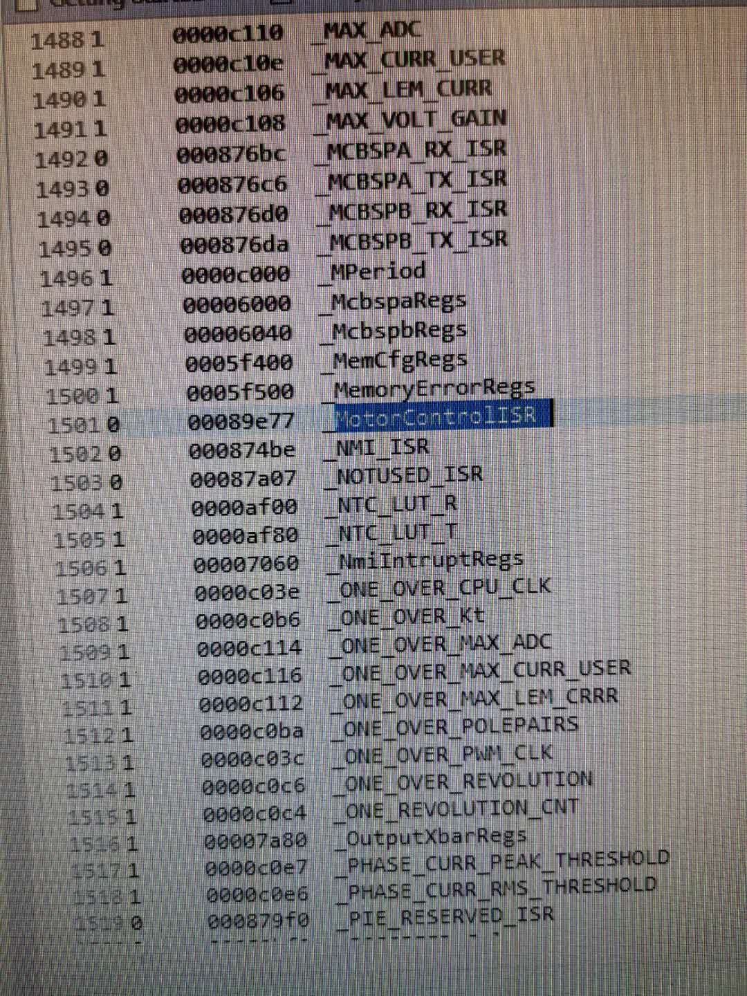

    how to check whether ISRS execute from RAM or FLASH? the CMD file I used is called 2837xD_FALSH_Ink_cpu1.cmd.
    And does it mean that ISRS does not have to be disabled if it executes from FALSH?Pls advise.
    Feng
  • Feng,
    You just need to look at the .map file and look for the ISR in it, and check if it is assigned a RAM or FLASH address. Sometimes, they will copied to RAM at load time. That will reflect in the .map file.
    Sira
  • Hi Sira,
    checked .map file, the ePWM ISR should be assigned to a FLASH address, pls see below map file and CMD file:
    .map file:
    CMD file:
    Feng
  • Feng,
    That confirms it then. You're updating the Flash application, so you can't be running those functions.
    Let me know how else I can help or if we can close the issue. Please mark as Resolved answer.
    Sira

     today  i try to recover sci flash kernels since successful test last time, an new error is trigger
    all setting keeps the same as before, same board,same version of ccs.so i have no ideal about this.
    i search from e2e forum, most of the threads said that the error "atteampting autobaud to load kernel..." means sci gpio is not correct.
    but for my case, i am using the same board, same kernel as before, which was successful.
    pls help.
