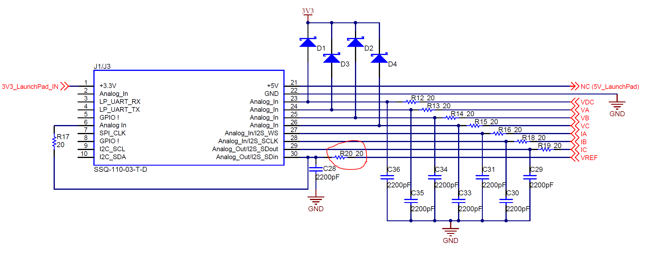

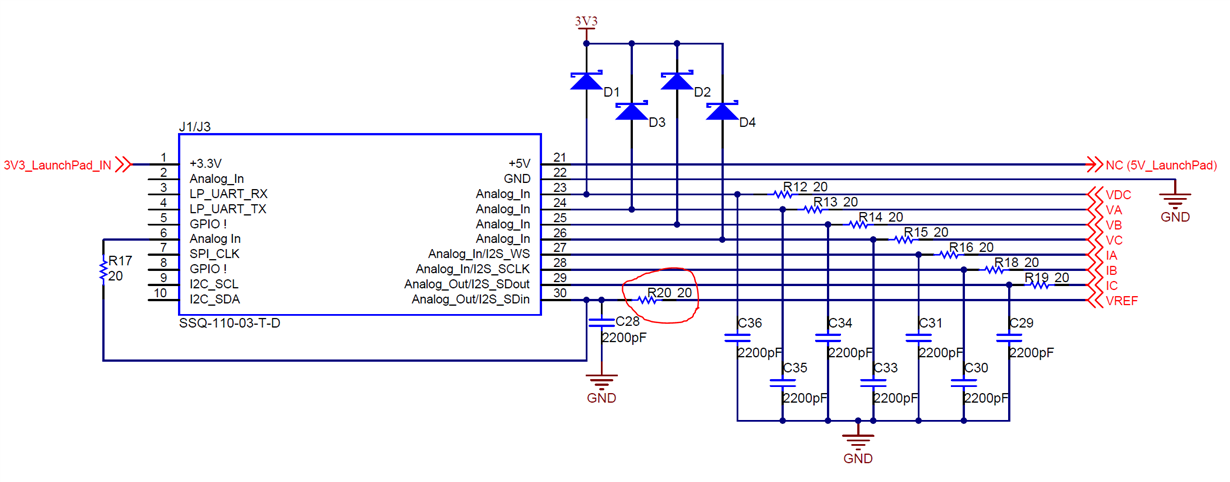

  • Ramesh, based on the documentation provided on page 27 of SPRACO3, it sounds like DACs A and B are supported by the 3PhGaNInv booster pack for debugging purposes:
    The documentation also talks about removing R20 for DAC monitoring purposes, which is on the DACA/B pins.  Here is the 3PhGaNInv booster pack side:
    And here's the Launch Pad side:
    This makes me think DACs A and B are intended to be used, not the PWM DACs.

    So it seems like all of the TI documentation suggests to use the in-built DACs, but probing pins J3-10 (DACA) and J7-10 (DACB) still doesn't show any signal.
  • I'm seeing another issue, I'm not reading in any current values: motorVars[0].currentAs is zero along with Bs and Cs.  The PWM signals work and I'm able to spin the motor open loop in BUILDLEVEL  = FCL_LEVEL2, but I'm not reading any currents.  It doesnt appear to be a hardware issue, a scope on ADCINCA2, B2, and C2 shows a time varying current signal.
  • I found a big clue, the current measurement issue goes away when powering the system through the LaunchPAD's 3.3V power (it works when JP1-JP5 are populated on the LaunchPAD and J5 on the BoosterPack is removed).  Current measurement doesn't work when powering the 3.3V line from the BoosterPack.
  • I think I found the reason that powering from the BoosterPack doesn't work. JP3 on the LaunchPad generates the 5V rail, which in turn generates the VREFHI reference which is used for the ADC reference.  This seems to be either a board design flaw or an error in the SPRACO3 documentation.
