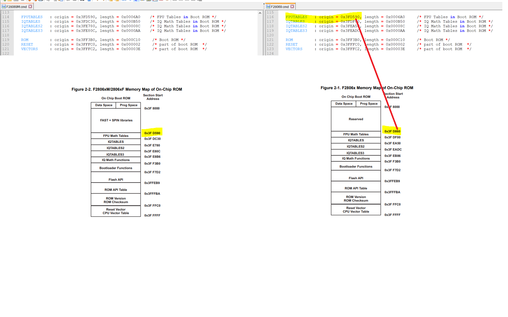

in our example code,
C:\ti\c2000\C2000Ware_2_01_00_00\device_support\f2806x\examples\c28\flash_f28069
in the cmd file F28069.CMD:
FPUTABLES : origin = 0x3FD590, length = 0x0006A0 /* FPU Tables in Boot ROM */
IQTABLES : origin = 0x3FDF00, length = 0x000B50 /* IQ Math Tables in Boot ROM */
IQTABLES2 : origin = 0x3FEA50, length = 0x00008C /* IQ Math Tables in Boot ROM */
IQTABLES3 : origin = 0x3FEADC, length = 0x0000AA /* IQ Math Tables in Boot ROM */
The memory address is different from TRM
FPUTABLES should start from 0x3F D860, and the same problem for IQTABLES.
We are using Non-M or F version, I want to confirm that TRM is correct, right?
  • Howard,
    I agree, there appears to be a disparity between the FPUTABLES origin in F28069.cmd and Figure 2.1 of http://www.ti.com/lit/ug/spruh18h/spruh18h.pdf
    Everything else appears to be OK. Please see the attached picture.
    So the question now is whether the .cmd file is wrong or is the TRM wrong. The length of FPUTABLES is 6a0, so it seems to me like the .cmd is wrong. It should be changed from 0x3FD 590 to 0x3FD 860.
    Is this causing issues at an application level for you? If yes, can you try the fix and see if it solves the problem?
    I will internally file a JIRA ticket to address it.
    Sira
