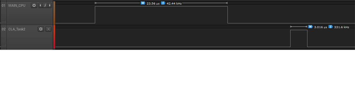

I have a (understanding) problem with the CLA vs. CPU calculate time.
We use a TMS320F28069. For testing and debugging I compare the absolutely (!) identical code. At first in the Main-CPU, second in a CLA-Task. I expected the same calculation time.
But my measurements shows a very much faster calc time for the CLA.
The difference is 3µs (CLA) vs. 24µs (CPU)!
To measure the time I toggle a GPIO.
The CLA-Task is measured also by a GPIO. Started by Sotwaretrigger (IACK), stopped by the CLA1_INT2_ISR Routine. The codesnippet below.
All needed Variables are in the CLA1DataRam-Area. Calculation is correct and works (in CLA and in CPU).

The main time for calculation is needed by this code. There are some Divisions. But why is this in the CLA so much faster?
delta_Z_o = ( ( Ch ) * ( P_Z_o - ( delta_Z_o_n1 / Rjc ) ) * deltat ) + delta_Z_o_n1;
delta_Z_o_n1= delta_ZK_o;
This formula is called 6 times (also with other variables).
 Compiler Optimization has no speed effect.
Do you have some Ideas how this should happen?

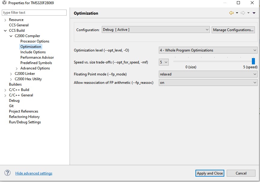

  • CPU calls division routine, which is quite slow:
    LCR          FS$$DIV
    Perhaps you didn't set C2000 Compiler->Optimization->Floating Point mode (--fp_mode) to relaxed. "strict" setting leads to FS$$DIV call.
    Edward
  • Hi Edward,
    thanks. You are right. I changed to relaxed. but the call of LCR    FS$$DIV is already present. See below in the dissassembly.
    The settings for Optimization:
    Disassembly:

  • Sorry, I fought EINVF32 instruction is not called directly (like DIVF32 when TMU is present), but is still a call to FS$$DIV, which then should use EINVF32 for fast divide operation. strict / relaxed mode I guess is not relevant for you and lack of TMU unit.
    Guru asked you if you are using *fast RTS library*. rts2800_fpu32.lib is not fast. You certainly need fast supplement lib for fast divide. Once you add it, make sure its priority is highest, to do so try using up/down arrows to move it to the top in C2000 Linker->File Search Path->Include library file ... list box.
    To make sure fast lib is working, try single stepping in debugger into FS$$DIV routine, there you should see EINVF32 instruction used.
    Edward
    The big question is already present:
    The (same) Code in the CLA must be as quickly as in the CPU, is this right?
    Thank you.
    Markus
  • As a general statement it depends on the code.  For pure 32-bit floating point math operations I would expect them to be similar.
    If the code, as an example, had fixed-point operations, a lot of branches, C28x leveraged a repeat block, then the CLA will not do as well as the C28x. This is because of the instruction set, addressing modes available to the CLA.
    Because in your case the C28x is taking much longer it seems something is not apples for apples.
    Another question on the C28x code, is it running from flash or RAM?
    Also to check that your code is pulling in the fast RTS library, take a look at the generated .map file and see which object libraries are being used.
    Lori
  • Hi Edward,
    Hi Lori,
    using the rts2800_fpu32_fast_supplement.lib has the most postiv effect.
    Before we used the rts2800_fpu32.lib
    Also a very good tip: Running from Flash vs. RAM.
    6,2µs (Ram) to 8,4µs (Flash)
    6,7µs (w/o Compiler Optimization; Ram)  to 9,2µs (w/o Compiler Optimization; Flash)
    Note: all old CPU measurements in the postings before will be made with running from flash (CLA Program always running from RAM)
