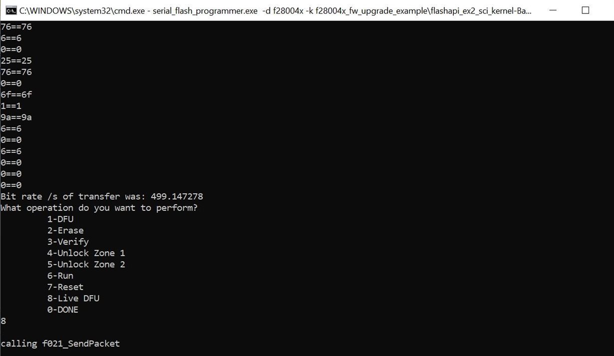

I followed the instructions in this document to flash my micro through SCI and it seemed to work properly until I got to the last bit and I was not prompted with the operation I wanted to perform (DFU in my case).
https://e2e.ti.com/cfs-file/__key/communityserver-discussions-components-files/171/3652.Serial-Flash-Programming.pdf
This is what is listed in the reference manual:
And this is what Mine looks like:
I have tried waiting but nothing ever pops up after this. How can I get the prompt I need to run the DFU?
Thank you for your help,
Trevor

  • I am using the TMS320F28377S Microcontroller with custom hardware. I have verified that the serial communication works properly from previous programs that I flashed using the jtag connector and the screenshot that I posted of my system shows that it does properly send and receive the data.
    I threw the necessary files into the same folder to make it easier for me. The command I am using is this:
    serial_flash_programmer.exe -d f2837xS -k F2837xS_sci_flash_kernel.txt -a my_program.txt -p COM5 -b 9600 -w -v
    I also tried without the -w -v and it finished after the line about the Bit rate. I also tried with -q -w -v and it did not show the compared hex numbers.

  • Unfortunately I am not offered a menu of options at all as shown in the screenshot in my original question. The last thing the command prompt says is Attempting autobaud to send function message...
    After I get this message I am not allowed to input anything at all. There is no menu of options. it looks like it is stuck in an infinite while loop trying to do something with autobaud and it is not working.
    is there a way to fix this issue? any help would be appreciated.
  • Trevor,
    Yes, I understand that. Just pointing out that when your issue does get resolved, you will see a different command window than what your initial message indicated.
    In your case, it looks like f021_DownloadKernel() function on the host side is executing properly. This function includes an Autobaudlock(), followed by loading the Kernel program to CPU1 RAM. Once this function returns, it once again attempts to Autobaud lock. This is where it is hanging.
    On the target side, once the Kernel is in CPU1 RAM, it does required initialization and then tries to Autobaud lock with the host.

  • Trevor,
    You looked at TI-OTP ECC address space.  Please see the next page (page 180 in datasheet) for Flash ECC range and confirm whether the ECC is programmed correctly or not.
    Could you attach your application map file as well?

  • Trevor,
    As Vamsi mentions, you missed the next page Pg 180 which contains the continuation of Table 6-2 and the per sector Flash ECC. That's what Vamsi wanted you to check.
    Sira

  • Trevor,
    That ECC space address for second bank is incorrect in the datasheet.  I will file a ticket and notify our documentation team to fix that.  Thank you.
    We will review your memory map and get back to you.

  • Trevor,
    1) Hope you are using the latest Flash kernels from C2000Ware_3_01_00_00.
    2) In your linker cmd file, please align all the sections mapped to Flash on 128-bit boundary. See the usage of ALIGN(8) in the linker cmd file at C2000Ware_3_01_00_00\device_support\f2837xs\common\cmd\2837xS_Generic_FLASH_lnk.cmd.
    Above is very important when using kernels to load your application. See if this helps any.
    3) Another minor thing in linker cmd: Please update the origin and length of RAMM0 as below:

  • Vamsi and Sira,
    This did resolve my issue but I am just curious, why does this matter when using the serial flash programmer but not when using Jtag? the program worked just fine without this modification when I was flashing with Jtag
    Thank you both for the help! it is really appreciated.
    Trevor

  • Trevor,
    Glad it helped.
    Flash wrapper logic in the device can program a max of 128-bits at-a-time when the address is 128-bit aligned.
    When I developed TI Flash tools (CCS Flash Plugin and UniFlash), I assumed that users may not align the sections on 128-bit boundary and designed them to handle that case as well.  Flash kernels does not handle this case.  Hence, I suggest users to align the start address of the sections on the 128-bit boundary.  This way, Flash kernels when it calls Flash API, will pass 128-bit address.
    Hope this helps.
    Thanks and regards,
    Vamsi
