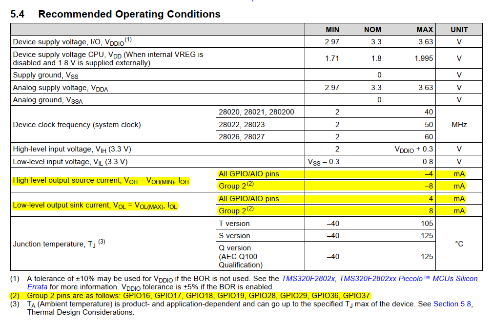

TMS320F28027: Output source/sink current ratings for I/O pins
Part Number: TMS320F28027
Is each of IOH and IOL the current rating per pin or the total current rating for multiple pins?
If it is total current rating for multiple pins, is the current rating for All GPIO/AIO pins the total current rating for all I/O pins except Group 2 GPIO pins?
