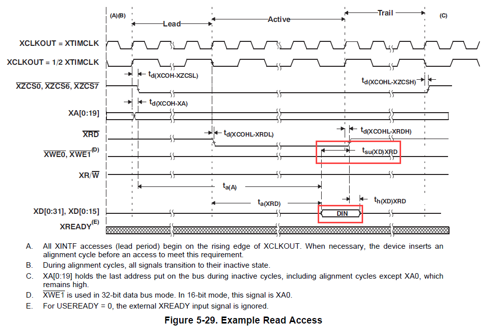

Customer finds that the data to read access is latched a XTIMCLK before RD rising edge, but not at the moment of RD rising edge.
They wonder if the mechanism is normal, and how to configure XINTF to latch the value at the moment of RD rising edge?
Attachment is the register configuration of XINTF. Could you please help to review it and answer the questions?

Rayna,
This information is included in the datasheet and XINTF user guide.
With respect to the XRD behavior, I would consider the latch operation to be completed when the signal is released back to high. The relevant setup time from the datasheet must be satisfied:
This is consistent with SRAM devices in general:
