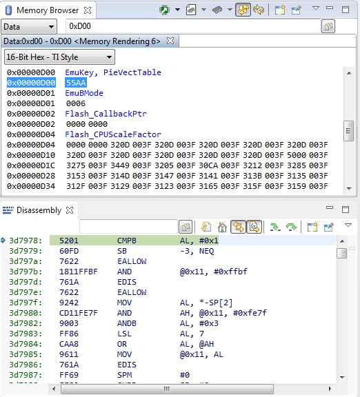

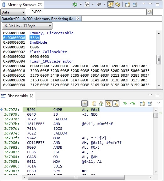

  • If I don't have it boot  to OTP (via 0x3D7BFE=0x55AA, 0x3D7BFF=0x006)  but have the boot loader stored in OTP and just let the boot process default to starting up in Flash A (0x3F7FF6)  and have the application in Flash A jump to OTP (0x3D7B54) on startup, all is well and the application runs fine (stored in Flash E-B, 28035) . It Works with  a power cycle or warm reset.   So I guess I'm missing something to get it to jump/run in OTP on a power cycle.
  • Ron
    It sounds like your boot loader in OTP doesn't have its entry point at 0x3D7800? That is where the OTP boot mode is going to branch to when it exits boot.
    Best regards
    Chris
  • Ah, so I need to swap Begin with SCIBOOTINIT?
            SCIBOOTINIT : origin = 0x3D7800, length = 0x000050
            SCIBOOT     : origin = 0x3D7850, length = 0x0002FE
            VERSION     : origin = 0x3D7B50, length = 0x000004    //2 words  // Current Version of BootLoader and date
            BEGIN       : origin = 0x3D7B54, length = 0x000002     /* Used for "boot to Flash" bootloader mode. OTP */
    I just tried the memory browser check, something is definitely amuck when I hit cpu reset, play, and pause..
  • So that was it!  Many thanks Chris!, I was totally looking in the wrong place.  Hopefully someone else can learn from my mistake.
