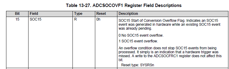

  • Hi Huihuang,
    I noticed that ADC setup is internal VREF mode so to get better results especially on the first conversions, recommend using a delay of 5000us to ensure bandgap settling.  This however is not the reason why ADCA stopped converting.  Based from your attached register dumps, there is SOC overflow and it shows that all SOCs associated with ADCA (SOC9, SOC6, SOC1 and SOC0) have pending conversions.  This happened because the triggers for ADCA occur at different periods (10us and 1ms) and if such is the case there will be a duration when all the 4 SOCs will be receiving triggers while conversion is still happening.  This is what causes the overflow flag to be set and this will prevent ADCA from converting and ADC will be in this state (frozen) unless the flag is cleared by writing to ADCSOCOVFCLR1.
    One way to deal with overflow is to regularly poll for the OVF flag and clear it as soon as a bit is set but with the current trigger set up on ADCA where 2 SOCs are  converting at faster 10us intervals and 2 channels at slower 1ms intervals, overflow may always happen and polling/clearing the SOC overflow flag will affect the throughput.  Another idea is to move the longer 1ms trigger period to ADCB if it is easy to modify the HW so that ADCA will only be triggered by 10us period and likelihood of having SOC overflow will be minimized.
    Joseph

    1.ADCC just use CPU TIMER0(1mS)  as SOC trigger , it is impossible Overfolw. You can refer to below code.
    ADC_setupSOC(ADCC_BASE, (ADC_SOCNumber)SOC_THS2_TEMPERATURE, ADC_TRIGGER_CPU1_TINT0, ADC_CH_ADCIN3, 10);
    ADC_setupSOC(ADCC_BASE, (ADC_SOCNumber)SOC_TAIR_TEMPERATURE, ADC_TRIGGER_CPU1_TINT0, ADC_CH_ADCIN4, 10);
    ADC_setupSOC(ADCC_BASE, (ADC_SOCNumber)SOC_THS_TEMPERATURE, ADC_TRIGGER_CPU1_TINT0, ADC_CH_ADCIN5, 10);
    ADC_setupSOC(ADCC_BASE, (ADC_SOCNumber)SOC_CHARGE_GUN_TEMP2, ADC_TRIGGER_CPU1_TINT0, ADC_CH_ADCIN8, 10);
    ADC_setupSOC(ADCC_BASE, (ADC_SOCNumber)SOC_CC_VOLTAGE, ADC_TRIGGER_CPU1_TINT0, ADC_CH_ADCIN14,10);
    ADC_setupSOC(ADCC_BASE, (ADC_SOCNumber)SOC_OBC_EN_DT, ADC_TRIGGER_CPU1_TINT0, ADC_CH_ADCIN1 ,10);
    2. Based on my understanding the SOC overflow should not stop ADC converting , but just hardware trigger was missed.
    Could you double confirm the SOC overflow will case ADC stop converting?
    when the issue happened , the ADC will always stop converting(the ADC result register  will not update keeping the last time result), but the SOC will always generated, just power off/power on the board then  the ADC will work again.

  • Hi Johnson,
    You are correct, not clearing the interrupt should not stop the ADC from converting however if the polling/clearing of ADCINT or OVF flag uses a while loop which is something like this:
    while(!ADCINTFLG.bit.ADCINT1);
          ADCINTFLGCLR.bit.ADCINT1 = 1; // clear the interrupt bit
    and the interrupts are happening quite often and are not serviced or not cleared fast enough then code will be stuck in the polling statement (while loop in example above).  It would appear as if the ADC stopped converting in this case.  Maybe this is what is happening with the code.  I don't think i have seen the code snippet where ADC results are ready to be read after EOC/ADCINTx.  Is it possible you can share that too?
    Joseph

    When issue happened, the ADCSOCOVF1 and ADCSOCFLG1 alwasy 0x243 that means SOC9,SOC6,SOC0,SOC1 generated, but overflow.
    (The ADCA SOC0 and SOC1 trigger by EPWM1_SOCA  ,SOC6 and SOC9 trigger by CPUTIMER0).

    Please also help to analysis the possibility that may cause the ADC stop converting.
