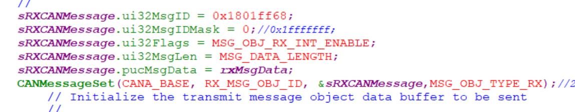

My customer used CANbox and TMS320F28377D to communicate with CAN.
He wanted to receive data from All ID not fixed ID .
After initializing a given ID, only the data corresponding to the initial ID can be received, and the data of other IDs cannot be received.
setting:   IDMASK = 0;      UMASK=0;
Please help.

    Looks like MSG_OBJ_USE_ID_FILTER used.  Can you verify the value of tCANMsgObject.ui32Flags and confirm that bit 3 is not set?  Bit position is derived from can.h as follows:
    //! This indicates that a message object will use or is using filtering
    //! based on the object's message identifier.
    #define MSG_OBJ_USE_ID_FILTER 0x00000008
    Joseph

  • Hi Susan,
    Using the driverlib functions and example as attached in your previous post, user will be able to receive other node IDs by enabling message ID filtering and setting the mask bits to 0.  Just modify the receive object setup as follows:
        CAN_setupMessageObject(CANA_BASE, 2, 0x1234, CAN_MSG_FRAME_STD,
                               CAN_MSG_OBJ_TYPE_RX, 0x00000000, CAN_MSG_OBJ_USE_ID_FILTER,
                               MSG_DATA_LENGTH);
    That should fix it.  Let me know if this works.
