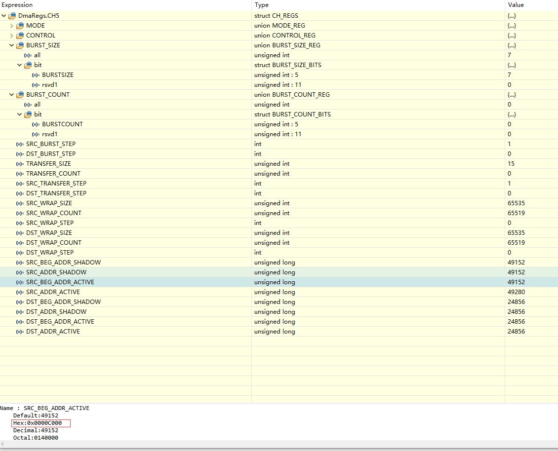

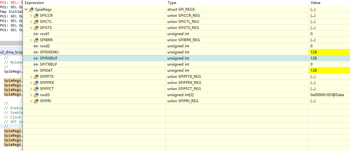

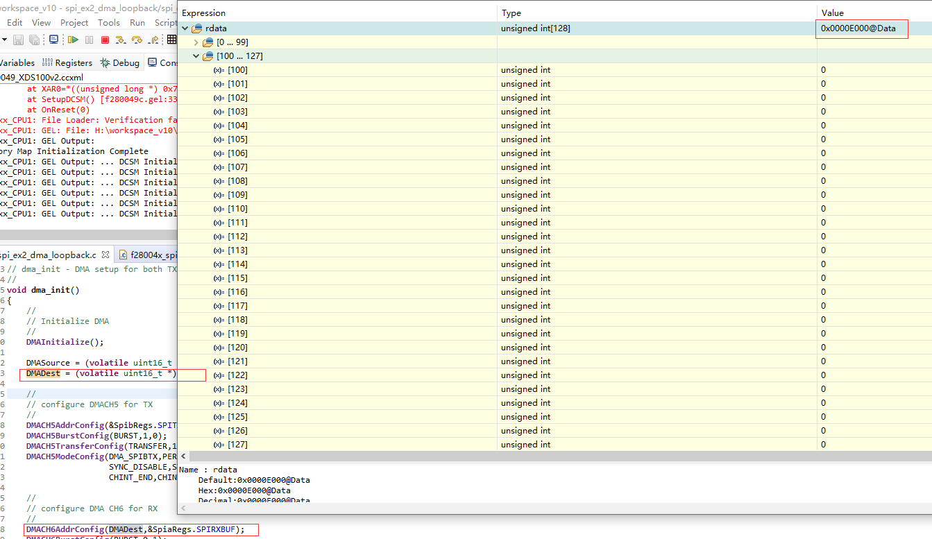

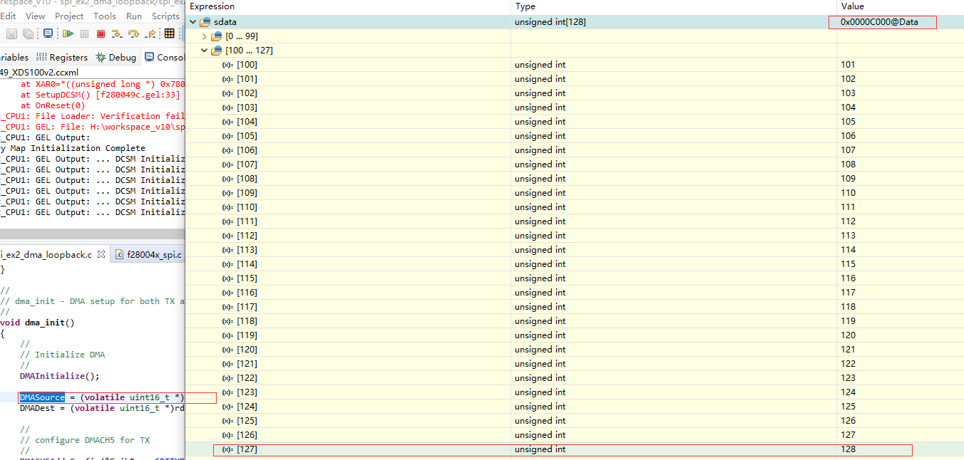

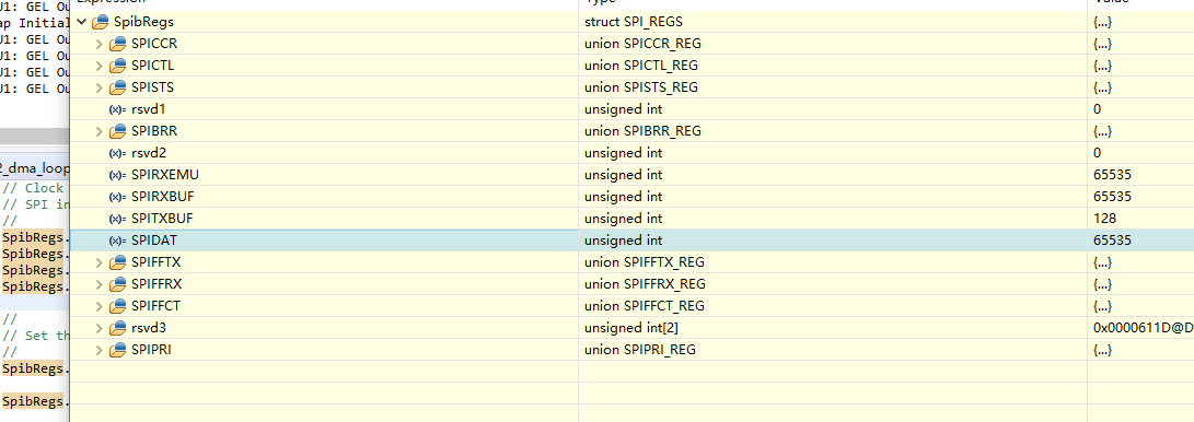

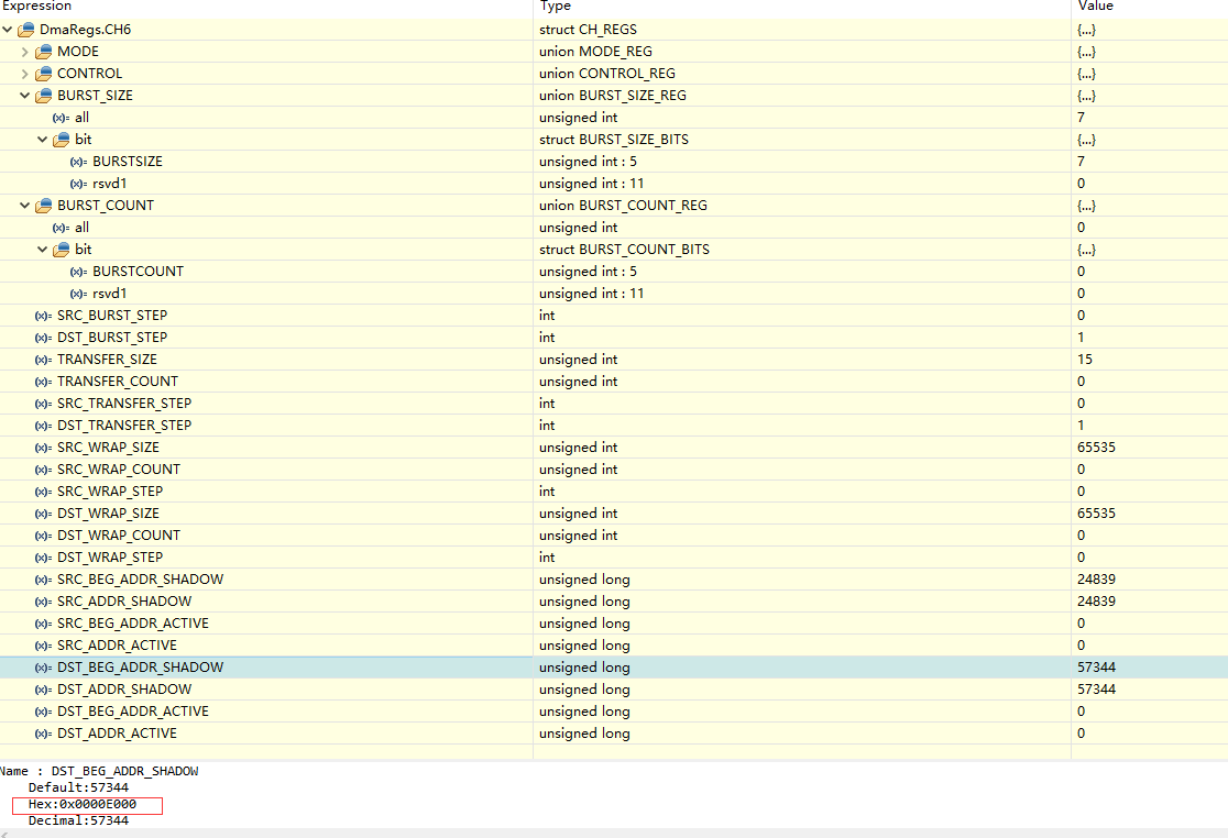

    sdata[128] and SpibRegs: DmaRegs.CH5 transfer [1,2.......127,128] from sdata to SpibRegs.SPITXBUF
    rdata[128] and SpiaRegs: DmaRegs.CH6 transfer received data from SpiaRegs.SPIRXBUF to rdata
    DMA registers and SPI registers:
    PS: I do not know how to pause CCS when receiving the first data
    Thanks!
    Looks like the SPIA FIFO is not enabled. Please set the bit SPIFFENA and try. Also it is recommended to do all teh SPI register configurations while SWRESET bit is cleared. Please do the FIFO register configuration after SWRESET
