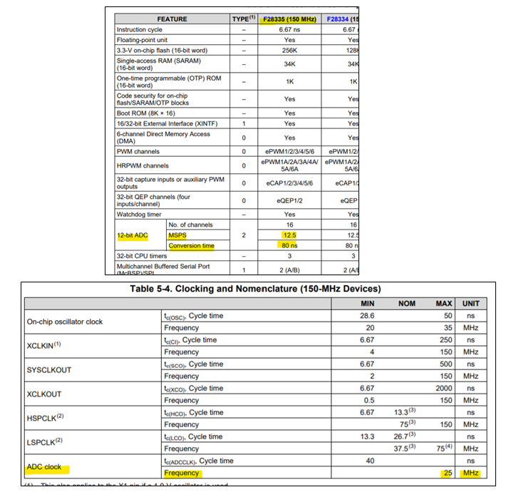

Hello experts,
I got question about ADC performance compared with F28837D and F28835.
ADC performance
F28837D : 12-bit ADC, MSPS=3.5, Conversion time=280ns, ADCCLK(Max)=50MHz
F28835 : 12-bit ADC, MSPS=12.5, Conversion time=80ns, ADCCLK(Max)=25MHz
It looks F28835 have better performance.
Are these not coparison at same condition?
Attached picture are F28837D datasheet P9/P104 and F28835 datasheet P7/P42
I would appreciate if you would give me comment.

  • Hi Ryo,
    F2837x family devices have 4 ADC modules vs one module on F28335.  This allows a higher sample throughput vs. F28335 as well as more simultaneous samples (4 vs. 2).
    There are also many other important ADC specifications in the device datasheet, most of which have improved to some extent between F28335 and F2837x.
    All that being said, the F28335 device and ADC are still very useful and competitive parts and we still see new design-ins with this part.

    Ok, I understand F28377 have 4 channel, this point could be advantage.
    Also, could tell me example of improvement point of F28837 compared with F28335?
    Regarding with conversion time, F28335 (80ns) looks having better performance compared with F28377(280ns).
    Let me ask same question, are these not comparison at same condition?
    If conversion time is at same condition, total processing performance are as below;
    F28835 : 12.5MSPS x 2ch = 25MSPS
    F28377 : 3.5MSPS x 4ch = 14MSPS
    Thanks and best regards,
    Ryo Akasshi
  • Hi Akasshi-san,
    The F28335 device has 2 x S+H circuits, but only one converter, so the max sample throughput is 12.5MSPS (two samples can be captured in parallel, but the ADC still converts them sequentially).
    The F2837x device has 1 x S+H circuit per ADC, and 4 ADC modules, so the total throughput is 14MSPS (4 samples can be captured in parallel and converted in parallel).
    As far as other specifications, the main ones would be accuracy (Gain and Offset error), linearity (INL and DNL), and AC performance (SNR, THD, etc.).  You can compare the datasheets for the two devices and see that these specifications are similar or have improved from F28335 to F2837x.
    We usually see customers for these devices sampling many signals (e.g. 3 motor currents and 3 motor voltages) vs a single high-speed signal (e.g. a radar return), so the parallel ADCs with higher accuracy are typically a little bit better choice (but the F28335 device still exists for customers that want a single high MSPS ADC).
