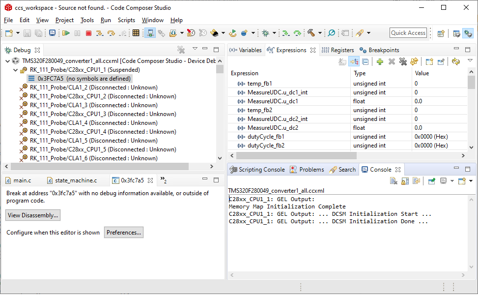

But using this script  CCS does not find the symbols. Like shown in the screenshot:
I can accses the registers and have a live view for there values, but I can't acces my variables. The values of the variables are just zero.
When I leave out the command: debugSession1.symbol.load( programToLoad ); I get the same state in the Debug window, but in the Expressions window in the values row its written: identifier not found: ...
How to get a connection to a running controller with proper variable accses??
By the way: The adress 0x3FC7A5, where CCS stops, is in the BootRom of my controller.
    The issue is that there are no debug symbols associated with the address where the target is halted.
    Try addressing #1 and have your DSS script connect non-intrusively. If that is correct, then you can remove line 30 in your script (the runAsynch() call). Then enable real-time mode (or have your script do it) and then see if the values of your variables look correct.
    The interesting thing is, the target is not halted. The target is running. Just the debug session or debug server are not working properly.

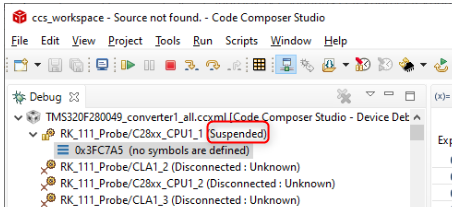

    The target is not running based on the screenshot you provided:
    It clearly says "Suspended" and the "Resume" button is available.

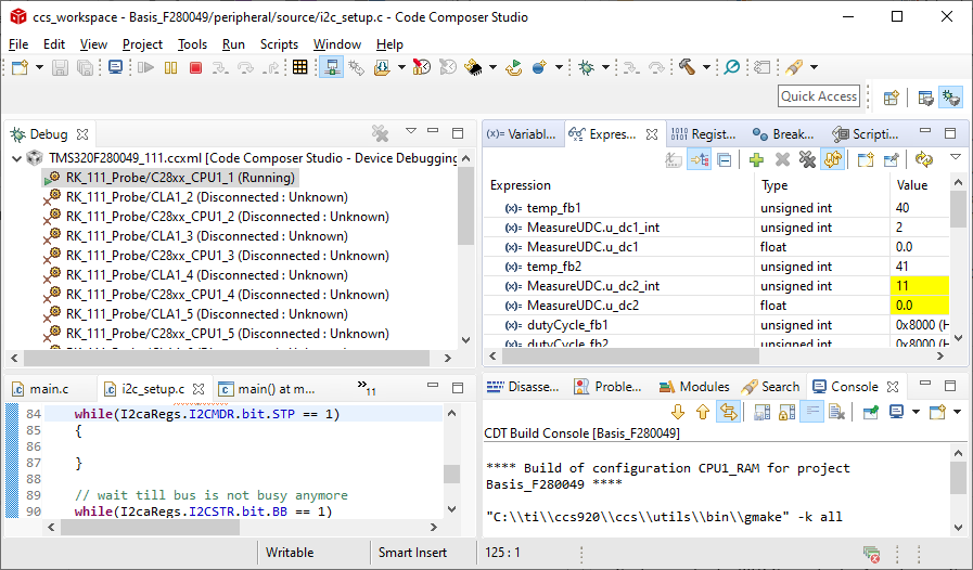

    After I run the script the device is halted, like you can see in the screenshot:
    When I press the resume button (F8) then the program runs continues to run. Like you can see here:
    But I have no clue, why it isn´t working like shown in your video.

    If we remove this checkmarks in the workspace automaticaly a launch-file (*.lauch) is created. But we woud have to do this for all 180 micocontrollers. How to automate this??
    We tried to disable "Halt On Connect" via java script:
    debugSession1.options.setBoolean("HaltOnConnect", false);
    But this isn't working!!!
  • Meanwhile we solved the problem.
    If we place "setBoolean("HaltOnConnect", false);" directly after "openSession" or directly before or after "connect" it isn't working.
    First of all we have to open all sessions, than set "HaltOnConnect" for all controllers to false and than connect for all controllers.
    You find a working version attached. Just rename Connect_111.txt to Connect_111.js.
