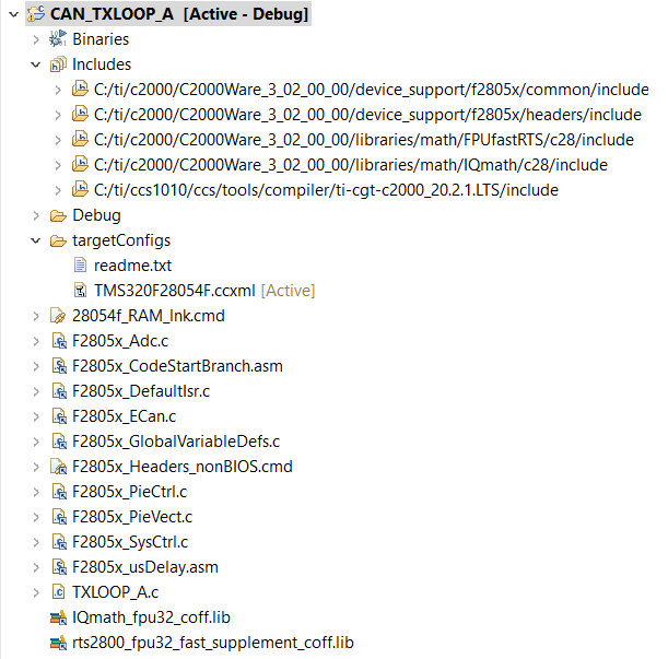

  • Thanks, I tried adapting the project for my MCU (28054f) and am running into problems. When I use the linker command file, "28054f_RAM_lnk.cmd", I get a warning "creating output section "ramfuncs" without a SECTIONS specification". I switch to the file "F28054f.cmd" and the warning is gone.
    In both cases, however, when I try to load the program onto the board, it does not reach the beginning of main. It builds and I see:
    C28xx: GEL Output:
    Zone 1 is Secure.
    C28xx: GEL Output:
    Zone 1 is Secure.
    But the program does not run. I have the ability to terminate the program, but not pause it. It never reaches the breakpoint at the beginning of main. I have no other errors. How do I configure the linker command file to get this to work?
  • I got rid of the warning by switching
    .sect "ramfuncs"
    in F2805x_usDelay.asm to
    .sect ".TI.ramfunc"
    No warning now, but I still have the same issue. The program does not run and there are no apparent errors.
  • Here's my file search path, does INSTALLROOT_2833x need to be changed? I can't find a valid replacement.
