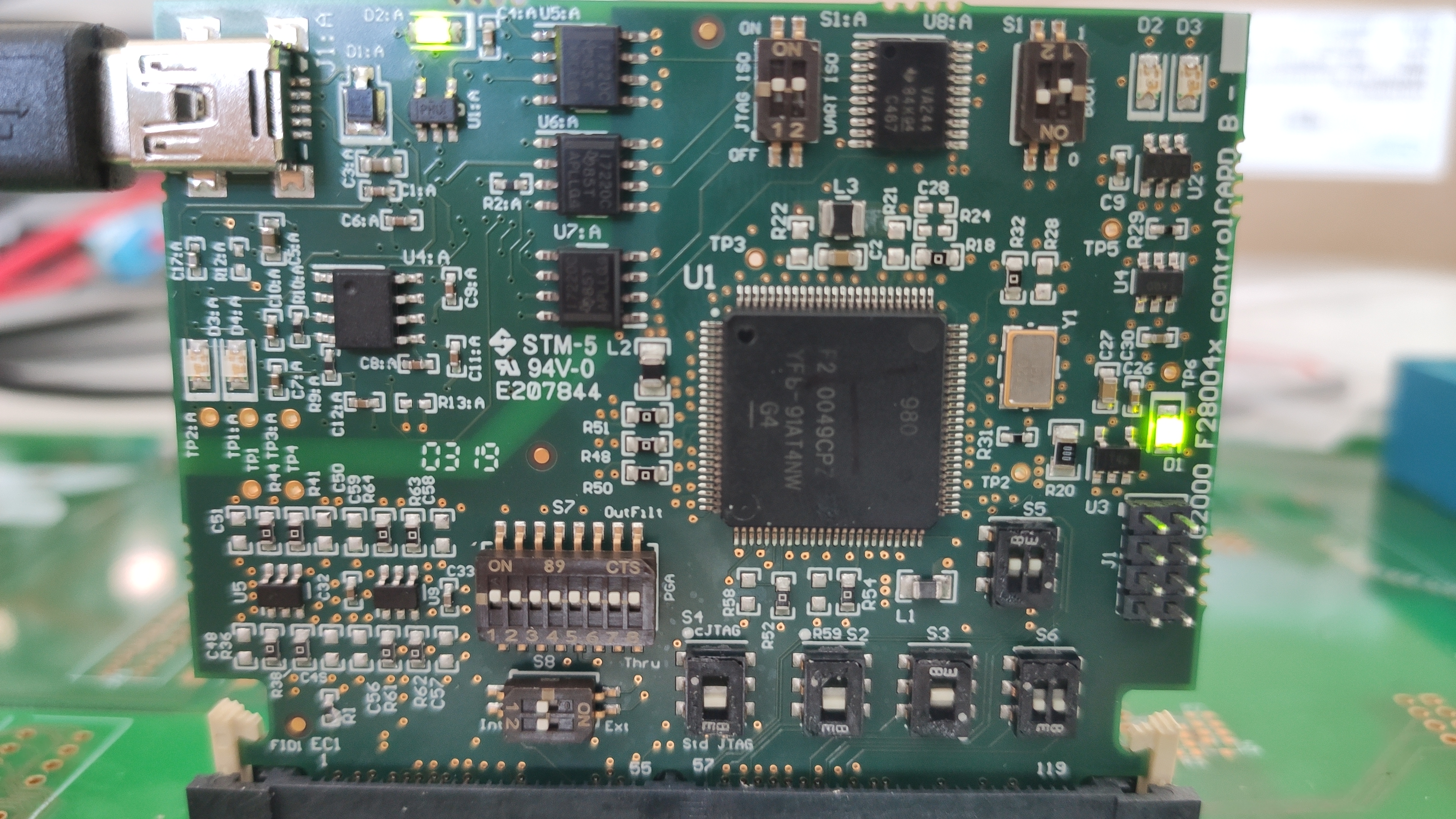

i would like to connect the controlcard F280049C to my computer but the connection test fails. I added the log to this article.
The controlboard is connected to a self designed mainboard with the following configuration.
HSEC8 - 120 Connection:
  • GND: 7, 47, 65, 83, 97, 111, 10, 22, 38, 46
  • 5V: 48, 84, 98, 112
  • Everything else are user specific signal connections
Switch configuration:
  • S1A: Switch 1,2: upper position (ON)
  • S1: Switch 1: lower position (ON), Switch 2: upper postion (OFF)
  • All other switches are on the default position.

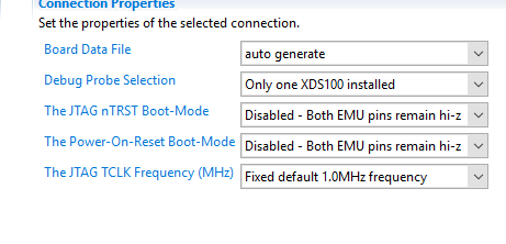

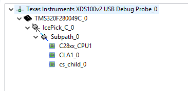

Software Konfiguration
  • Code Composer Version: 10.1
  • Texas Instruments XDS100v2 USB Debug Probe_0
  • TMS320F280049C_0

  • Patrick,
    While I am checking with controlCARD expert, I wanted to check with you if this controlCARD works ok with TI Dock Station or you have not tested it?
  • Hello Santosh,
    i didn't test it because we have no dock station.
    The LEDs on the controlCard are both ON.
    Best regards
    Patrick

    5. Have you correctly configured your target configuration? I can see its using XDS100v2, which is correct for the embedded emulator, but what target device are you using?
    What LEDs, there are about 6 on this controlCARD.
    Cody
    1. first use of this custom hardware
    2. embedded XDS100v2
    3. What are the voltages relative to GND(TP4)?
      1. TP1: 4,93V
      2. TP2: 1,2V
      3. TP3: 3,3V
    4. What are the voltage relative to EMU_GND(TP3:A)
      1. TP1:A: 4,7V
      2. TP2:A: 3,3V
    5. F280049C
    6. D2:A; D1
  • Patrick,
    this error is weird being that it seems like some data is coming back to the device but not all of it. Or that it is partially corrupted.
    The last test ran in your JTAG integrity scan seems to delay and increment the transmissions, I've never seen that before.
    Can you try reducing your clock frequency to 10KHz or 100KHz to see if it is a speed related issue?
    If that doesn't work, sometimes reprogramming the FTDI chip (the actually XDS100v2) can help. How to do that is  pretty easy, and is described in the following post.
    Cody
  • Hello Cody,
    yes this board is very curious.
    Firstly, I changed the speed to 10kHz but the output log is the same.
    Secondly, I reprogram the FTDI chip with the batch file. Very easy but the output log is the same as before.
    Maybe this behaviour helps to identify this issue:
    When I plug-in the USB of the controller into my computer, the current consumption via the HSEC8 connector is 194mA (5V). During the test the current consumption is 125mA. After the JTAG test the current consumption is only 49mA. I connected the voltage source of a power supply NGE100 directly under the HSEC8 connector to the 5V/GND plane. This voltage is buffered by a 47uF capacitor.  After reconnection of the USB the current consumption via the HSEC8 connector is 194mA. Toggling the output of the power supply doesn't change the current consumption.
    During this tests the voltages on the controlCard are stable.
    Patrick
  • I solved my issue.
    Something was wrong with the connector.
    I re-soldered the connector and the current consumption is at every condition around 50mA, now.
    Thanks Coby for the fast answers.
