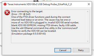

The customer is trying to connect the control card with XDS100v2 USB Debug Probe.
That, it is always showing : Error connecting to the target: (Error -151 @ 0x0). The message is shown in below pic.
I have asked the customer to check all the switches on control card which are all on correct positions, also the voltages on board and change the USB cable.
Besides, follow the troubleshooting guide for this error as below document.
We have tried the method as mention, just didn't reinstall the CCS yet.
However, the problem is still there. May I have any comment on this ?

Johnny,
occasionally the XDS100v2 device will have an issue and need to be reprogrammed. Start by reprogramming.
This post describes the process well:
Cody
Hi Cody,
Thanks for your help.
Indeed, since it is reprogrammed, the XDS100v2 device could connect.
