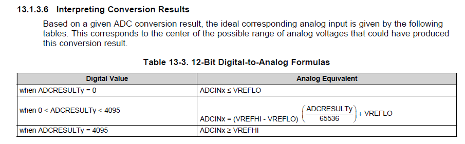

I was reading the ADC chapter of SPRUI33B, section 13.1.3.6: Interpreting Conversion Results. In the second row and second column of the table, it seems the value 65536 is a mistake, it should have been 4096. Am I right?
Thank you.
Hi Gobind,
Yes, that was a mistake. Please pull the latest copy of the TRM from ti.com, SPRUI33C. That portion has been corrected.
