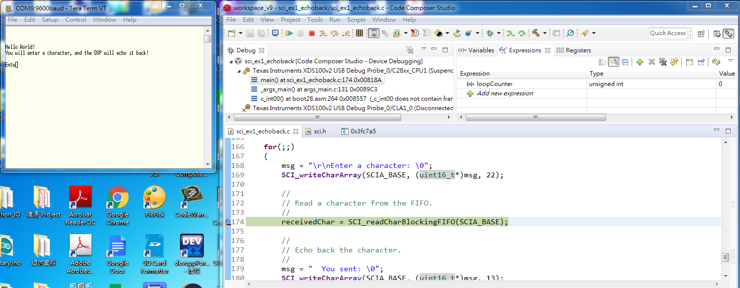

I Can’t Receiver in SCI function while I run the project example with sci_ex1_echoback in C:\ti\c2000\C2000Ware_DigitalPower_SDK_2_00_01_00\c2000ware\driverlib\f28004x\examples directory.
But the transmit function is correct, the capture and pin connections as following:
GPIO28 is SCI_A-RXD and in Pin 76 of HSEC pin, Connecting to Txd of PC.
GPIO29 is SCI_A-TXD and in Pin 78 of HSEC pin, Connecting to Rxd of PC.
The gnd of Docking Station is connected to gnd of RS232.
The RS232 application in PC is Tera Term or Putty.
There is no characters in PC’s application while I typing characters.
Where could be the problem is?
Any one help will be much appreciated.

    Thank you for your question! You are correct that the transmit function is working properly, as Terra Term is showing the output from the device. When you suspend the debug window (Run->Suspend in Code Composer Studio) what function is this code stuck in? Could you provide a screenshot of the Debug tab once the program is suspended? If it is stuck in the "SCI_readCharBlockingFIFO" function, then it may be that no data is reaching the device.
    In order to debug this further, would you be able to connect a logic analyzer or oscilloscope to the TX and RX pins of the C2000 device to monitor the data coming in and out? This will allow us to quickly dismiss several potential issues.

  • Dear Vince,
    Thanks for your reply.

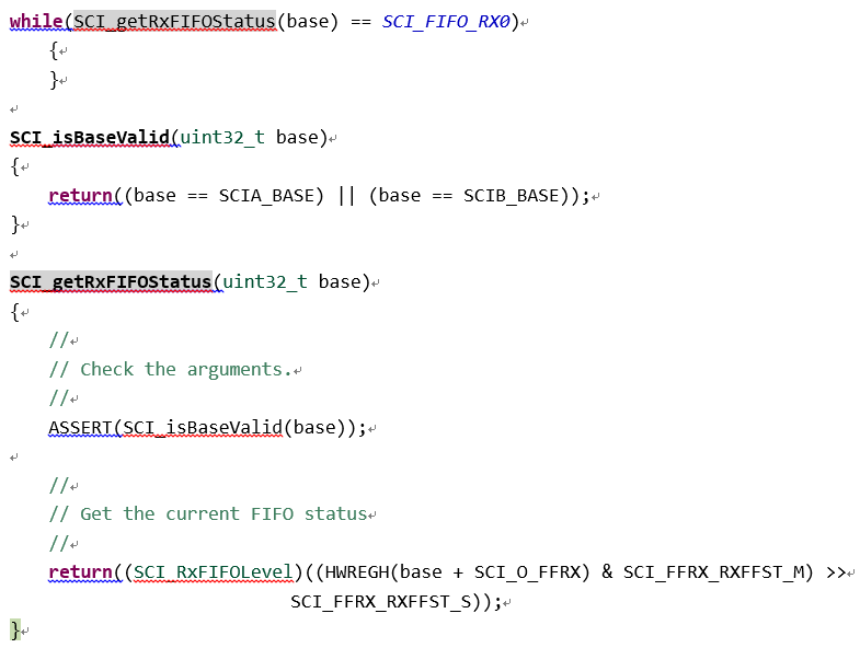

    I set the break point in the “while” loop for For_LOOP in main routine to execute the program.
    while (SCI_getRxFIFOStatus(base)== SCI_FIFO_RX0);
    The strange thing is that the Tera Term cannot completely display the msg string "\ r \ n \ n \ nHello World !\0", as shown in the figure below.
    Then click >> Y , click  , then <F8>
    The msg string is completely displayed now.
    Then, I type a character, after active the Tera Term Windows.
    The program stops in 1 of the following 3 programs.
    If Step_Into <F5> is used, the program will circle around those 3 routines, and the characters input by the PC keyboard cannot be read.
    May I know:
    1. Why can't the msg string be output all at once?
    2. How to change this program so that the characters input by the PC keyboard can be read normally.

    I appreciate your follow up message and the details you provided! Answers below:
    A: When using the "step" functions of the debugger, a step forward can sometimes interrupt the SCI output and prevent the rest of the string from completing. In a normal run of the code (without breakpoints and without stepping through) all text will be displayed properly, as no debugger suspend requests are issued.
    A: It looks like the device is stuck waiting for incoming communications to the device. Could you monitor the C2000-SCIRX line and see if data from the PC is reaching the C2000? It is possible that the RS232 and/or Terra Term is only able to receive, but not able to send data (could also be a setting in Terra Term).
    Please provide oscilloscope or logic analyzer plots of the C2000-SCIRX line so we can potentially narrow down the issue to software/hardware! Thanks!
