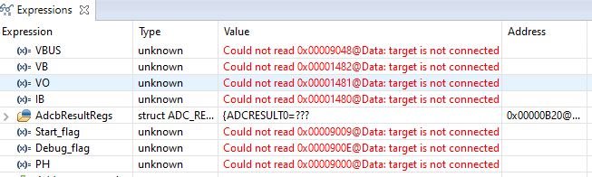

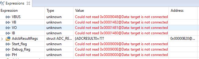

  • Hi Santosh,
    I installed the latest CCS (Version: 10.1.0.00010) and ran the program. I still see the error while operating my power circuit:
    C28xx_CPU1: JTAG Communication Error: (Error -150 @ 0x0) One of the FTDI driver functions used during configuration returned a invalid status or an error. (Emulation package 9.2.0.00002)
    C28xx_CPU1: Failed to remove the debug state from the target before disconnecting. There may still be breakpoint op-codes embedded in program memory. It is recommended that you reset the emulator before you connect and reload your program before you continue debugging
    Expressions:
    Avishek
  • Avishek,
    Are you able to run simple C2000ware example and Blinky_led? Are you seeing the issue only in your custom application or simple application also does not work?
  • Hi Santosh,
    As per your suggestion, I ran the blinky_led code from C2000ware, it works fine. In my application, when I am running the signal circuit (sensors and gate drivers) only, I can see the EPWMs working just fine. But as soon as I turn on the main HV power circuit, I hear the USB connect/disconnect error and see this error.
    Avishek

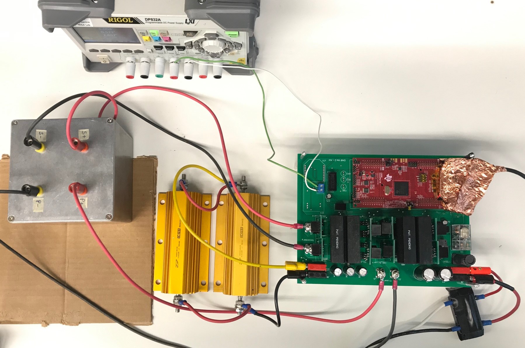

    What is the JP1 and JP3 setting on your board? I will recommend you to review Launchpad F28379D user's guide section 5.2 for isolated power supply.
    https://www.ti.com/lit/ug/sprui77c/sprui77c.pdf?ts=1597663484222&ref_url=https%253A%252F%252Fwww.google.com%252F
  • Hi Santosh,
    I'm providing external 3.3V to power up the launch pad, using the on-board boost converter to provide 5V (using JP6) and keeping jumper settings for JTAG/USB isolation. So here are my jumper configurations:
    JP1 - No
    JP2 - No
    JP3 - No
    JP6 - Yes
    Thanks & regards,
    Avishek
  • Avishek,
    Despite the isolation is sounds like we are still getting some noise coupling from your active circuit that is putting the FTDI/XDS100v2 into an unknown state, and/or corrupting the JTAG signals into the FTDI chip.
    I think we need to attempt to provide some type of EMI shielding to the area of the PCB that contains the FTDI/USB connection; not sure if you have any EMI gaskets or blockers handy?  It looks like all the major vendors like mouser/Wurth/even Amazon have some varieties of these.
    I'll see if I can pull some others into this thread to offer their suggestion based on experience.  At the end of the day we may need a more robust/enclosed external JTAG pod that brings the active circuits away from the power/noise source.
    Matthew
  • Hi Mathew,
    Thanks for sharing your insight/advice to resolve the issue. FYI, In my active power circuit I have a HF transformer operating at 50 kHz. I have kept it inside a metal box (Faraday cage) for EMI shielding and placed it physically away from the rest of the electronics on my PCB. I have attached pictures of the setup FYR.
    I had some EMI shielding tape (copper foil) handy. I wrapped it around the area of the launchpad that contains the FTDI/USB connection with proper insulation on the underlying components. I operated my setup with this arrangement. I still hear the USB connect/disconnect sound as soon as I operate the active circuit and see the FTDI driver errors (154 & 150) I shared in the forum earlier. I'm not sure if I did the shielding correctly, awaiting your comments/advice.
    Thanks & regards,
    Avishek

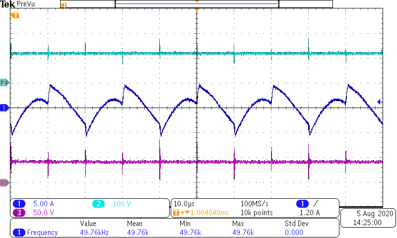

  • Avishek,
    These EMI type issues are always challenging, and change depending on the power electronics topology and board layout.
    I'd like to determine if the C2000 MCU is still running correctly or only the emulation connection is being effected.
    Is it possible to program the flash with some code that can run the power electronics w/o interaction from CCS?  If we can observe that this can control the system, even when switching, then we can rule out that the EMI is getting into the signal path at the device, and solely at the XDS100v2 interface.
    Matthew
  • Hi Mathew,
    Thanks for your response. I just wanted to let you know that I am able to run open loop tests on my power electronics hardware successfully even with the program running in the CPU. I can confirm this by monitoring couple of key waveforms such as the input/output voltage, transformer primary current. The transformer current looks periodic with frequency same as the switching freq. (50kHz) which confirms that the switching signals are not affected. Its just that the JTAG signals are getting corrupted and the emulation is failing to transmit the real-time readings from the sensors to the PC via USB.
    Avishek
  • Abhishek,
    You will need to work in Flash mode (JTAG disconnected). I am going to close this thread.
