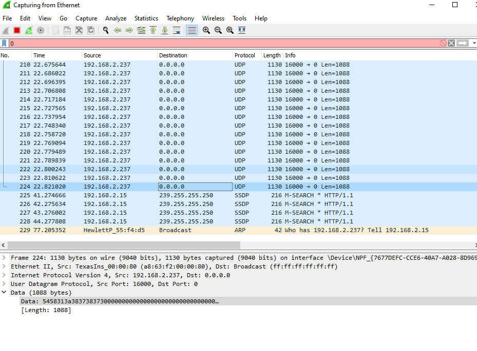

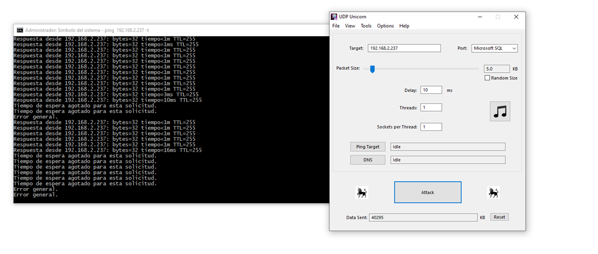

I am creating a lwip UDP server, and at the same time I am pinging the  device. Everything seems to work, however, in some situations (not always) an ICMP packet is lost, and then all the traffic (both UDP and ICMP) is delayed, until slowly, it falls appart and stops working.
To illustrate, I post a capture:
As you can see, to every ping request number N, there is a reply to N-1. It happens the same to UDP packets. Many times, there is a ping reply, when a UDP is sent as well.
IS it possible to debug it?

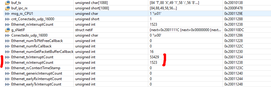

    When this happens, what happens in the application on F2838x side. Are the packets received at driver check Ethernet_rxInterruptCount if it's incrementing or not?
    If it shows increment, then it is at stack/upper layer level.
    Then check lwip_stats to look at which layer is not receiving or acknowledging. The statistics at different layers link,IP,TCP/UDP , ICMP should throw some light on where the packets are getting dropped.
    There is no direct solution to such problems, it just needs some level of debug since we did not encounter such scenarios during our webserver example.

    When it stops Ethernet_rxInterruptCount does not increase. Surprisingly, the program keeps running and even I can set breakpoints, and the main loop works as always.
    It seems something with Ethernet / Lwip memory problem. HEre are the CM ETH variables,as you can see it fails after many packets.
    Do you mind if I send you my code for debugging?

    I attach the CM Registers in case it is needed
    One interesting thing about this error, is that only RX channel is broken, sonce if I debug the program, and force the variables value to send same packets, the device sends it and they are watched on the Network.
    However,  I cannot even ping the device, because the ARP is not answered, it seems  like it had dissapeared from the network:
    I was able too to capture an ARP request just before the error and lose of communication from TI device, probably it is an ARP related error.
    Thank you

  • I am not sure if there is a problem in f2838xif.c since the Ethernet Rx interrupt count did not increase post the issue, the hardware/driver should receive the packets before it hits f2838xif.c.
    Also it is strange that F2838x stack is asking to 192.168.2.237 which is not found in the network at all. Please debug on those lines if what is making it query to 192.168.2.237.
    Sudharsanan
  • Hello  and thank you for your answer.
    Your observation is right, since Ethernet_receiveISR is not triggered anymore. But the reason why, I think it lies on the f2838xif.c mem management. Have you checked the registers?

    We have replicated the issue easily and quickly with these two configurations in UDPUnicorn (there are many more which take more time!!):
    • 10kB packets at 1ms
    • 10ms and Random Size
  • BTW, stop the UDPUnicorn Attack and resume once in a while (like 10 seconds) since, because of the upd sending, ARP packets are responded. But if these UDP packets stop, the ARP are never answered on the F28388D again.
