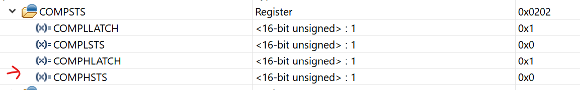

    1. I have tried connecting pin63 of J7. It's not working.
     2. I think it should be pin 64 of J7. I have also tried that previously.
    3. In that example project I can see COMPSTS as an invalid register.
  • Frank,
    I've got the issue. It doesn't work if 3.3V/GND is used as signal at ADCINB6. If the voltage is changed by potentiometer then it works fine. Is impedence an issue?

  • Finally realized what was the issue.
    I was trying one of DAB projects. That project sets up board protection using cmpss with some tripping mechanism.
    That configuration was not being cleared when I flashed the example.
    I changed the setting to flash in FLASH memory instead of RAM and added configuration to reset after flash.
    Now it's all working fine.
