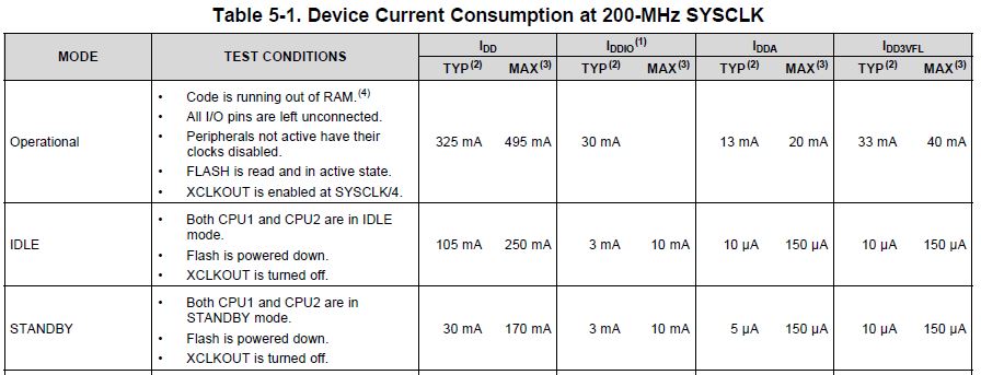

Hello, I'm trying the IDLE low power mode example using XINT1 (#define WD_WAKE commented).  I have a current measurement at JP1 on the launchxl-F28379D board and I'm watching GPIO1 to see when the DSC wakes.  I would like to understand why the 3.3V rail current at JP1 is much high than expected before waking.  Before wake the current is 142mA and after wake it is 159mA.
From the datasheet I expected Idd to change from 80mA to 245mA approximately.  Assuming a 85% efficiency in converting 3.3V to 1.2V I expected to see approximately a 71mA change at the 3.3V rail based on the following; (245mA -80mA) * 1.2V/3.3V /0.85 = 71mA .
By reducing the PLL multiplier the scope shows significant current savings.  I was hoping to see the same from IDLE since it gates the CPU clock.  Any help with this C200Ware LPM example would be much appreciated, thanks.

    The problem as stated is that the current difference between the IDLE and Operational state is not what it should be:
    Regardless of the other loads on the board the difference between IDLE and Operational should be seen (for a difference measurement the other loads cancel out).  Could you please consult with someone with a hardware background so the issue becomes clear.

    • You now say that IDLE "does not save that much current" by gating the CPU and that STANDBY "gives biggest current savings".  Can you explain that in the context of datasheet table 5-1?
    • You are suggesting the STANDBY example, what current savings does that example provide when measured as previously described?

    From the beginning we know that the IDLE instruction was executed, current consumption reduced a bit but not the documented 225mA.  STANDBY only provides an incremental 75mA as per the table above and not usable in my case due to loss of peripherals.  As stated, GPIO1 was scoped as per the example documentation, so it is also already know that the XINT1 ISR had run.  Your test that IDLE executes and the ISR runs doesn't contribute any new information toward reproducing the datasheet documented current savings.  Thank you but I don't want your help any further.

    You will achieve 225mA of current saving by going in IDLE mode if your operational used case is consuming 325mA of current. IDLE test case that you are using from C2000Ware is not representative of Operational testcase that was used to compute datasheet current limits for Operational Currents. Datasheet operational current takes into account worst case numbers where device is running using all the resources (please refer foot note #4 of the table above in DS).
    Your comparison of currents after coming out of IDLE mode to the operational currents in the Datasheet is not a one-to-one comparison. Device is not suppose to consume 325mA current if not in Low Power mode, operational current varies with the used case condition, and what is reported in the DS is worst case used case numbers that can be used to design regulators.
