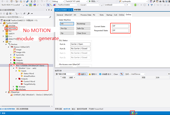

NOTE: The project run in CM core.
When i scan my borad by TwinCAT3,have no "EtherCAT device(s) added" windown appear,and no MOTION model generate.

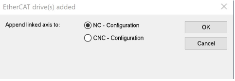

In my experience, when the EtherCAT slave EEPROM is programmed to support CiA402 and the associated ESI is in TwinCAT, then a pop-up should come up when the slave is detected to select NC. I recommend verifying the above info and starting a new TwinCAT project.

The EEPROM is programmed by EEPROM Programmer of ssc tool.And the xml which generate by ssc tool is in TwinCAT.
When a slave with EEPROM that indicates CIA402 support (which you should have based on what you've communicated) is discovered by TwinCAT 3, it will show a popup window that asks to select NC or CNC. If you aren't seeing it, try a new workspace. If that doesn't work, you may need to reach out on ethercat.org to get assistance from TwinCAT experts.

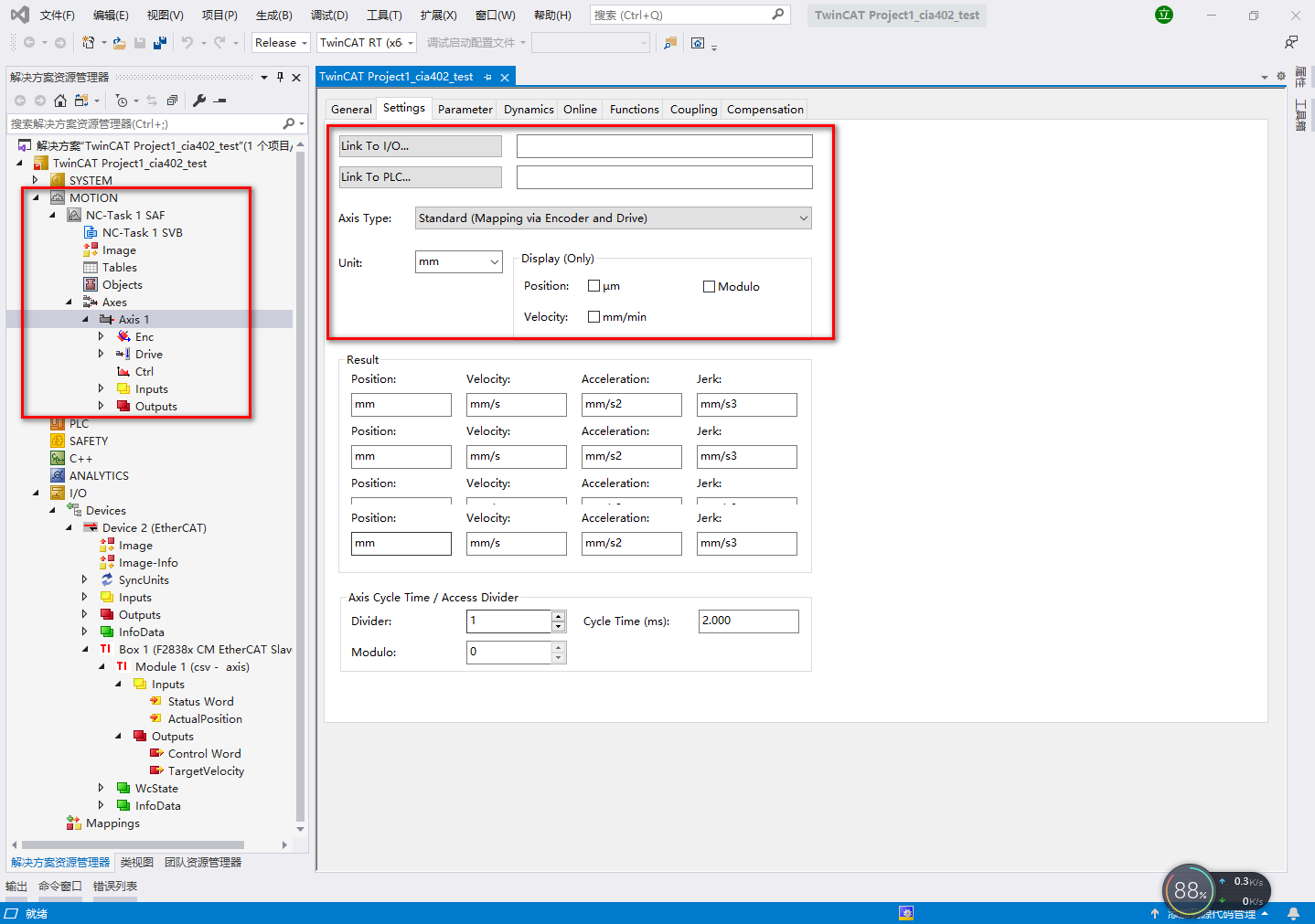

I believe the method to do it manually is to right click on the MOTION node in the solution explorer and choose "Add New Item". This should give you a pop up box to choose the Motion Configuration. This will then automatically create a task and other items.

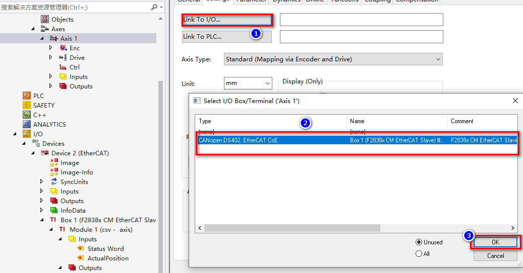

Follow the details in this guide in section 10.4: https://download.beckhoff.com/download/document/io/ethercat-development-products/an_et9300_v1i8.pdf

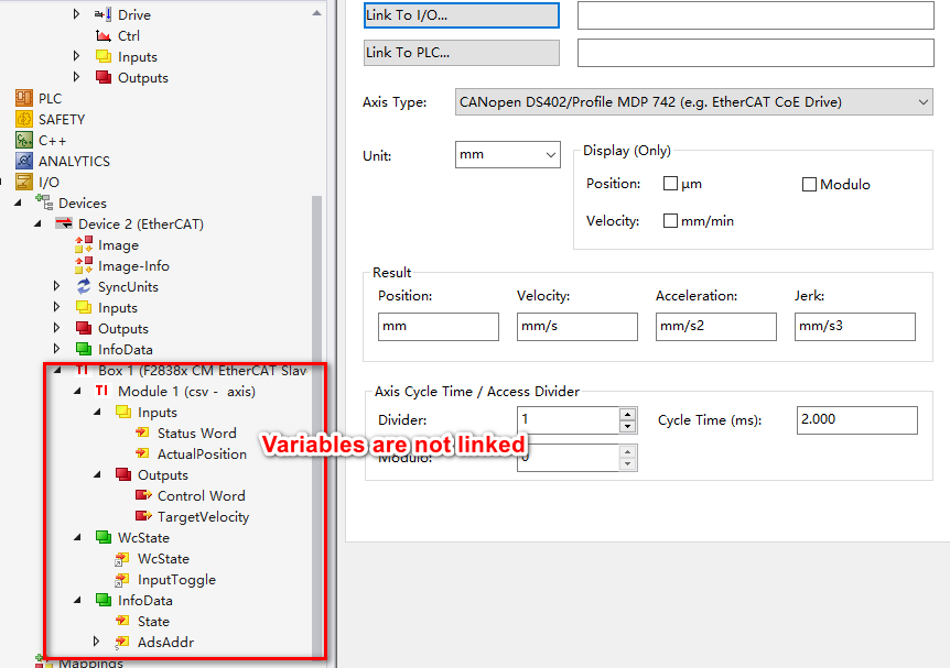

I Link the variables according to the document of you mentioned( https://download.beckhoff.com/download/document/io/ethercat-development-products/an_et9300_v1i8.pdf )
But Another problem arises.
The actual velocity and actual position is always 0.

Have you activated the configuration (which includes the linking, tasks, etc)? https://infosys.beckhoff.com/english.php?content=../content/1033/tc3_plc_intro/2953964811.html&id=
Once that is done, review that you've using the control word correctly. Info is in that previous link to the doc that you used.
