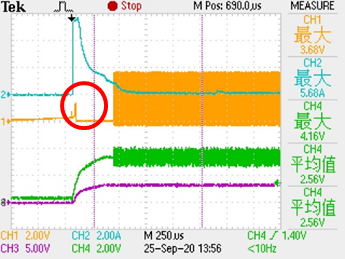

  • Hi tlee,
    I will check this next week. Because of repeated hang problem, my customer did more experiments and he captured below power sequence figures.
    • CH1: External oscillator output(to XCLKIN)
    • CH2: The current of 5V input(before 3.3V regulator)
    • CH3: GPIO-18 for function test.
    • CH4: +3.3V
    1. Oscillator output waveform type 1
    2. Oscillator output waveform type 2
    My customer gets two different oscillator output waveforms(the red circles of above figures), he would like to know is there any side effect of the different waves above(CPU cannot boot up well)?
    -Luke
  • Luke,
    The oscillator glitch is not ideal because it is occurring before the 3.3V supply is powered up, but it is short enough in duration, and close enough in time to the 3.3V ramp that I would not expect it to cause a problem.
    -Tommy
