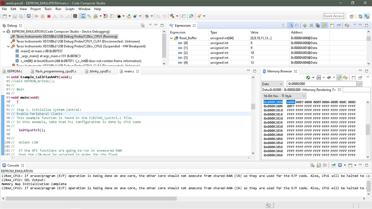

     Now I can write/Read the Flash Sector memory by EEPROM Emulation Method .But after the power  off my values are get erased not retained on Sector .
    To check values are retained or not done the blink code based on read value .  After the power off  its not works ,so my values are get erased .
    Why its gets erased? Please provide an solution to solve this problem..
    Readbuffer[0] has eight before power off.
    Code i have done for check the value retain on sector or not
    Thanks & Regards,
    Rani
  • Rani,
    Glad you are able to program now.
    Regarding content getting erased:
    • Please check your code to make sure that erase is not included somewhere.
    • Also, check if you are erasing it as part of project launch/load.
    • The read_buffer variable you are showing is in RAM - hope you are not reading it after power cycle and before reading the flash.  Please check.
    Thanks and regards,
    Vamsi

    Checked the all the function , erase function is not present .wonder how Flash B(0x82000) sector get erased after reset/ power off...
    Before power off /reset my values are written on that.
    I am not sure the way  of  creating .cmd file are correct or not .please give me suggestion how to do it properly .
    Thanks & Regards,
    Rani
  • Rani,
    Regarding erase: After power cycle, when you again load your code in to CCS, it erases the flash and loads your code to flash.  I think it is getting erased during this process.  You can control which sectors you want CCS to erase when you load the code in flash. Go to CCS debug view -> Tools -> On-chip Flash.  In the On-chip Flash GUI, you will see erase settings.  Instead of the default setting that erases entire flash, you can chose the option that erases the necessary sectors -> This will erase only the sectors where you code is going to be programmed (this should not collide with the sectors that you program using flash API in your application).
    Regarding the linker warnings: In your linker command file snapshot that you posted above, I see flash API is included correctly in line # 156.  Why are you including API library again in lines 143 to 153?  You can remove it.
    Thanks and regards,
    Vamsi
  • Vamsi,
       After changing  the Flash setting i can assure that my data are retain on Flash Sector B . While loading its not getting erased , values are retained on that . But when i make it reset or plugin /plugout of  USB cable its works .  Again if i am load the code i can see value are retain on memory.
    First time loaded the value , 2nd time just read the data from memory and making LED blink its works fine ....
    But Make it RESET/ After power cycle its not works(LED is not blinking) ....

        SeizeFlashPump();
    // Jump to RAM and call the Flash API functions
          int j=0;
       // EEPROM_GetSinglePointer(1);
           data = 1;
           RESET_BANK_POINTER;     // Reset Bank Pointer to enable search for current Bank
           RESET_PAGE_POINTER;     // Reset Page Pointer to enable search for current Page
              //   EEPROM_ProgramSingleByte(data);
           flag=1;
        while(1)
            if(flag==1&& (*Bank_Pointer)==0xFFFF) // after power up  set flag=1
            EEPROM_Write(7);
            for(j=0;j<10;j++);
            if(flag==1)
            Read_Buffer[0]=EEPROM_Read();   // reading flash
           flag=0;
           ReleaseFlashPump();
               if(Read_Buffer[0]==7)
                   GPIO_WritePin(BLINKY_LED_GPIO, 0);
                   DELAY_US(1000*500);
                   GPIO_WritePin(BLINKY_LED_GPIO, 1);
                   DELAY_US(1000*500);
    // Example_Done - For this example, once we are done just stop here
    #pragma CODE_SECTION(Example_Done,ramFuncSection);
    void Example_Done(void)
        __asm("    ESTOP0");
    // End of file
