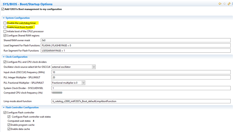

  • Yes, SYS/BIOS will create an equivalent code start function. You can try opening the .map file that gets generated when you build with the SYS/BIOS Boot module enabled and see if it's being placed correctly at the flash entry address (BEGIN). Can you show me what settings you've used for the Boot module?
    Whitney
  • These are the settings I made when the FLASH option is disabled. Then I use my codestartbranch function shown above. Otherwise I have activated the two yellow marked options. My codestartbranch is excluded for the compiler. Below I show the two .map files.

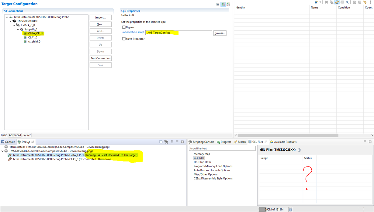

  • Okay, good to know that BEGIN is at least populated with the init function. Can you also double check the boot mode selection pins on your board to make sure they are set to Flash boot?
    One thing that can be helpful in debugging standalone boot issues like this is to power cycle the board and then connect to it in CCS using a .ccxml file that has the GEL file removed. Without the GEL file, it won't do a reset upon connecting and so the state of the PC will be preserved. You can then load symbols and see where it has gotten stuck.
    Whitney
  • I can assure you that the pin configuration is correct. As already mentioned the program starts correctly when using the codestart_branch shown above.
    I have deleted the .gel file in the .ccxml file. But then a default folder will be selected automatically. Anyway, the controller seems to reset when I connect to the target. At this point I can't get anywhere without further help from Texas Instruments because I don't have access to the assembler code that is called in the codestart_branch generated by the sys/bios.
  • It's okay that it repopulated the "Initialization script" field--it's still not pointing to a .gel file so that's what we wanted. The reset it's referring to isn't necessarily one caused by the debugger connection.
    When you hit the suspend button, where does it halt? If the address appears to be where your application is, load the symbols for your .out. If it appears to be in boot ROM, load the symbols for it (they're in C2000Ware\libraries\boot_rom\f28004x\revB\rom_sources\ccs_files\cpu\Release).
    The code generated by SYS/BIOS can be found in the build folder in your CCS project in a directory called configPkg if you want to look at it. The ti_catalog_c2800_initF2837x_Boot_init function in app_p28FP.c is probably most of interest in this case. If you're specifically looking for that ti_catalog_c2800_initF2837x_begin section, you can see it in SYS/BIOS in \packages\ti\catalog\c2800\initF2837x\Boot_asm.s28.
    I'm wondering if the watchdog disable isn't happening soon enough. If you add a watchdog disable to Boot_asm.s28 like there is in your other code start file, does it boot?
