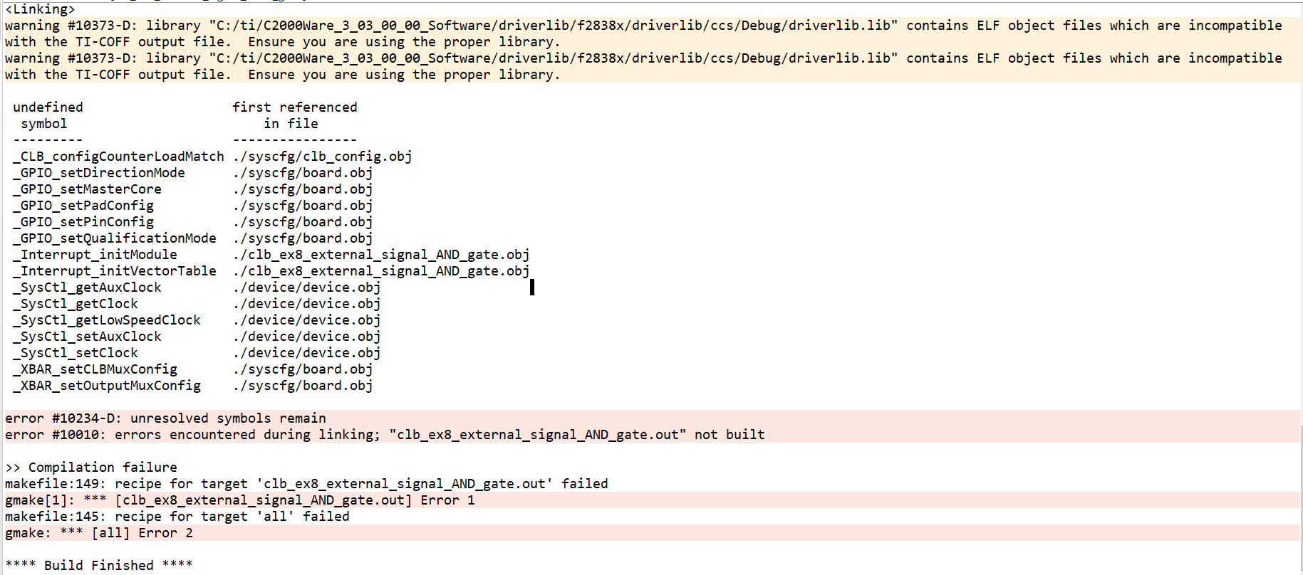

Hi
Nima,
i could not able to resolve the above errors.
Could you please help me where to change project property settings to resolve above problem.

still showing similar errors , Not working after following your procedure.
what else i can do?
Clb is not working with "COFF" format , working with "ELF file format only" in compiler version 20.
In complier version 18 "ELF" is not selectable only option is to select "coff" hence not able to build.
Harshit
This is not a CLB tool issue. If you are switching to from ELF format to COFF format or vica versa, the DRIVERLIB.LIB project you have linked, should also be the COFF or ELF format to match the project setting.
That is the issue.

How we can check and make DRIVERLIB.LIB for ELF or COFF file format as project setting , is any tutorial exist?

There is a CCS project for the driverlib project.
C:\ti\c2000\C2000Ware_3_03_00_00\driverlib\f2838x\driverlib
You can rebuild that with CCS with COFF.
Also, if you download the latest C2000Ware and latest CCS + the simulation TDM compiler specified in the CLB User's Guide, everything will build perfectly out of the box with ELF.
