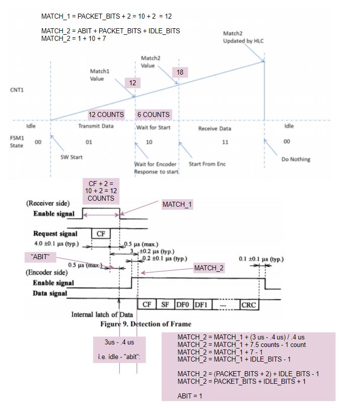

    In source code for T format there is function which set up value for Match1, match2 and R0 register in Counter, HLC:
    tformat_configureCLBLen((PACKET_BITS + 2), sendClks,receiveClks + dummySPIClks);
    with  sendClks = ABIT + PACKET_BITS + IDLE_BITS; and receiveClks = n * PACKET_BITS ;
    the definition:
    #define PACKET_BITS 10
    #define IDLE_BITS 7
    #define ABIT 1
    I understand the defined values for ABIT, PACKET_BITS, IDLE_BITS  and parameter sendClks, receiveClks  pass into tformat_configureCLBLen () function
    are based on T format protocol rule ( data length, send - receive timing, baudrate)  - figure below:
    But because I don't have the detail T format specification protocol, so I am confused when leverage when code for Nikon A format,
    With my Nikon A format encoder: each transmission frame has length 18 bit, baudrate is also 2.5Mbs, and has signal timing like picture below
    t1 = 7.2us (18 bit command), t2  = 1us(min), t3 = 1.5us(min), t5 = 3us, t6 = 21.5us (in this case three field- 18 bit data), t7 = 200ns = t8.
    I don't  understand clearly how to calculate the define  value for IDLE_BITS  and ABIT
    So Is that ok if I do below:
    #define PACKET_BITS 18
    #define IDLE_BITS  7 =>> ??
    #define ABIT 1      ==??
    sendClks = ABIT + PACKET_BITS + IDLE_BITS; and receiveClks = 3 * PACKET_BITS ;

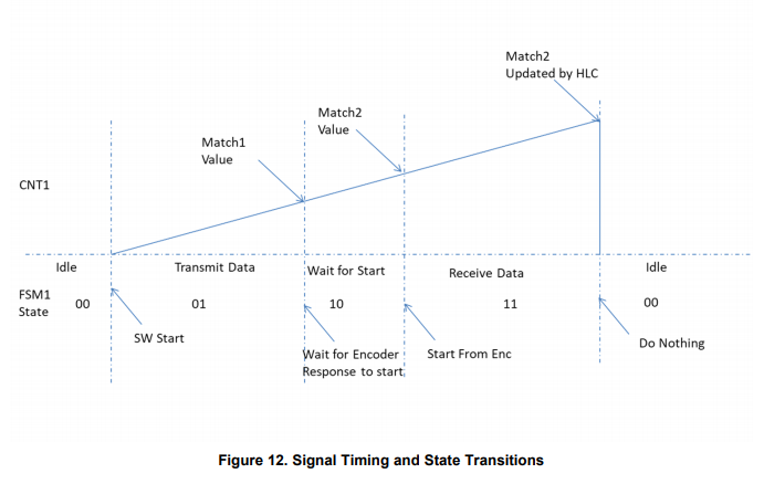

    Let me take a closer look and get back to you by end of Wednesday US time.  Your screenshots didn't come through - can you repost them for my reference?
    Lori
  • Lori,
    Sorry for upload screenshots that not come through.
    Here screenshots are:
    State Transiition
    1,
    A format protocol and timing:
    Which is: t1 = 7.2us (18 bit command), t2  = 1us(min), t3 = 1.5us(min), t5 = 3us, t6 = 21.5us (in this case three field- 18 bit data), t7 = 200ns = t8

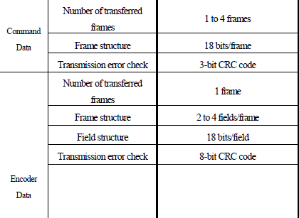

  • Lori,'
    Thanks for your reply, I have read the encoder spec that you sent and compare with a format spec. And I also adjusted for number of bits and crc...... in source code library and try to test with a format encoder, but communication between MCU and encoder would be not working. I think there are some features in source code library of T format that I don't understand clearly so I want to make clear them:
    1. About the defined value for ABIT, and IDLE_BITS, can you explain more about them? ( I mentioned in previous reply)
    "I don't  understand clearly how to calculate the define  value for IDLE_BITS  and ABIT
    #define ABIT 1      ==??
    tformat_configureCLBLen((PACKET_BITS + 2), sendClks,receiveClks + dummySPIClks); ""
    In the t-format document, Figure 9 has a timing diagram.
    • ABIT is just "a bit" - one .4 us clock since the interface runs at 2.5Mbps.  It allows defining match2 in terms of PACKET_BITS and allows for adjustment.
    • IDLE_BITS is the 3us from the end of CF to the start of the encoder's response 3us / .4 us = 7.5 so the designer used 7 counts.
    Hopefully this will help:

    I seem to have my interface mostly working with an A-format encoder. I'm having trouble with the CRC though. Did you have to make any changes besides changing the POLY1 to 0x1D?
    Ben
  • Ben
    "I seem to have my interface mostly working with an A-format encoder. I'm having trouble with the CRC though. Did you have to make any changes besides changing the POLY1 to 0x1D?"
     - I have just only reused the function "PM_format_generateCRCTable()" for generate CRC - 8bit table  from source code of library.
     - I wrote my own function to calculate CRC 8 bits for answer message from encoder, and CRC 3 bits for command messages ( my a format encoder need command message with 3 bit CRC - you can see on the datasheet I attached)
    - Yes, with CRC 8bit I changed POLY1 to 0X1D.
