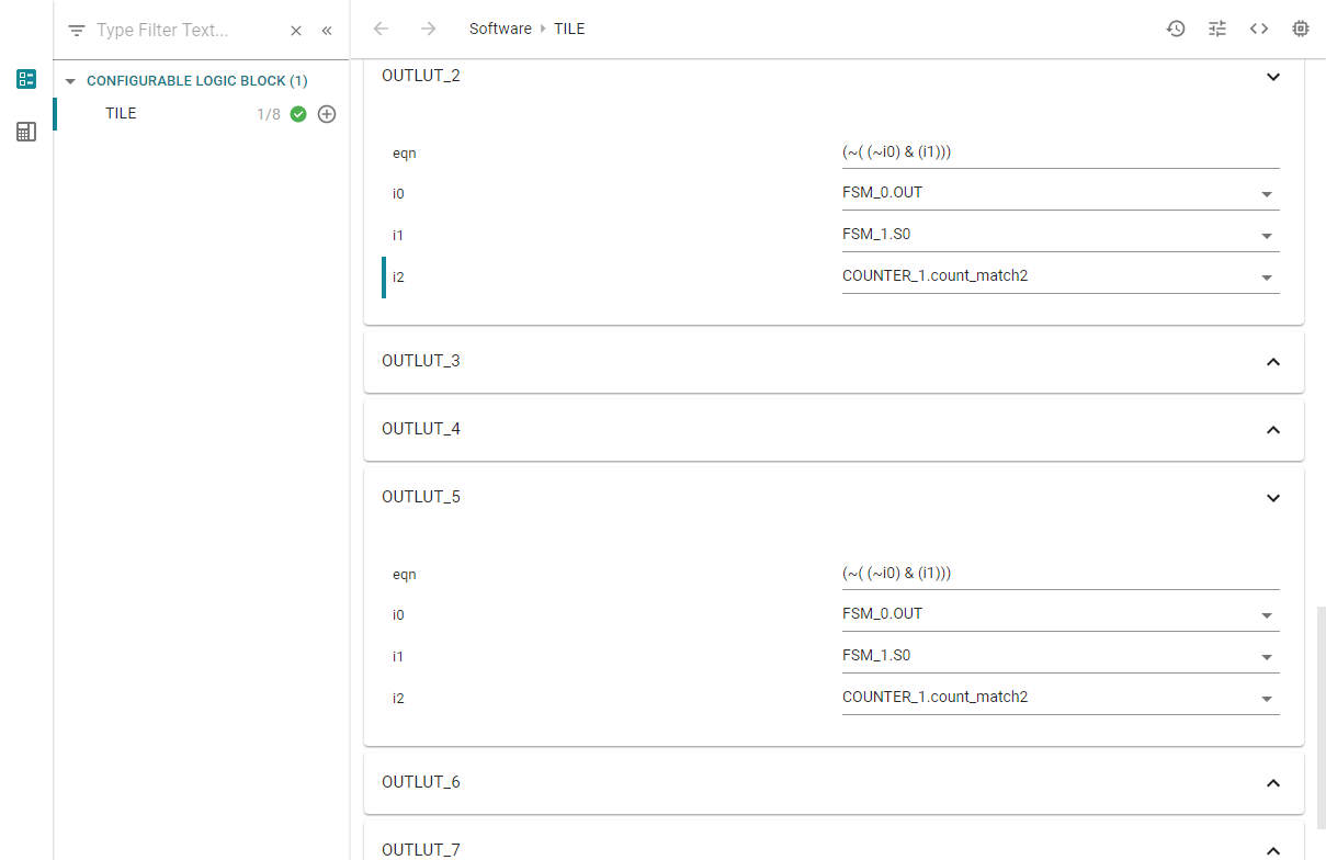

    Now I made some progress in the pin change, but there is a problem.
    GPIO7 (clocking singal from) is generated in the CLB4_OUT2_0 and I want to change it.
    The CLB4_OUT5_1 can access to the output xbar so I think if I replicate the OUT5 from OUT2 and then I can get the clocking signal from any output xbar pin.
    The diagram is as follows.
    And I did the simulation, the signals from top to botom is the out2 to out 5.
    The I choose the GPIO14 which can access the CLB4_OUT5_1 via OUTPUTXBAR3.
    The resuls is different from the simulation. OUT2, OUT4 and OUT5 are shown.
    I am not sure why there is a 3us notch before the clocking signal in the green waveform (GPIO14).
    Many thanks
    Best wishes
    Lei
    Lei,
    This could be caused by the GPIO setup of the pin.  This is not accounted for by the CLB simulation.  Is everything as you expect for the next transmission?
    -Lori
  • Hi Lori,
    I have checked the GPIO configuration.
    GPIO14 is set the same as GPIO7.
    The notch exists every time when the transmission begins.
    By the way, what is the CLB output 3.
    Best wishes
    Lei
  • Lei,
    Good to hear that your modifications match the original.  I don't think this notch will impact the communication.   The transmission of the request from the interface should be fine.  Are you seeing differently?
    This is the enable for the pwm pin - ref Figure 2-8. CLB Outputs – HLC Event0 and EPWM Output Enable
    Lori
