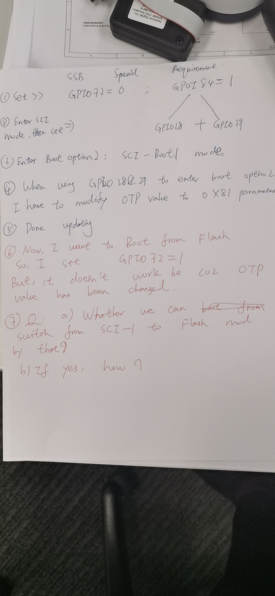

  • Hi Hareesh,
    Here is Dylan, FAE who in charge of this customer.
    I have listed the full detail about customer special requirement with following picture. Please kindly find it and ignore all the other stuffs. And we just need two answers from you. Thanks!
    If you think the picture is not clear, I have listed all the details about customer requirement here:
    Step 1: Customer has set GPIO72=0 & GPIO84=1 >> Then, it will enter SCI mode
    Step 2: Customer has set GPIO28 & GPIO29 >> Then, it will enter boot option 2 which is SC-BOOT 1 mode
    Step 3: When using GPIO28 & 29 to enter boot option 2, customer have to modify OTP value to 0x81 parameters
    Step 4: Done system upgrading by booting from SCI
    Step 5: Customer now want to boot from flash. Thus, they set GPIO72=1. However, it doesn't work because OTP value has been changed and OTP value can be changed once.
    Note: Based on customer current situation, they are not willing to change external hardware circuit. Thus, they are seeking for SW solution to achieve this function.
    Support Need:
    1) Do you have any suggestions we can exit the SCI Boot 1 Mode and switch to Flash mode based on above information?
    If yes, how to implement it?
    Thanks!
    Dylan

  • Hi Dylan,
    Can you please explain why can't you use default SCI boot pins (GPIO84/GPIO85) ?
    Coming back to your query, once you have programmed the OTP to choose SCI BOOT1 option, Get Mode (GPIO72/GPIO84 =1) will always choose that option. If you look at SCI boot flow (see below), if you do not provide the valid KEY then it should boot to FLASH. Is that something you can try see if that works ?
    Vivek Singh
  • Hi Vivek,
    To echo your first question, customer don't know GPIO84 will be available to use after they set GPIO72=0 & GPIO84=1 to enter SCI mode at beginning. And they found the SCI-Boot 0 SCITXDA used GPIO84 which has conflict to the first step (enter the SCI mode). Therefore, they decide to use SCI-Boot 1 Mode, but not SCI-Boot 0 (default mode). They have already set up the hardware circuit of this one, therefore they are not able to change back.
    To response your suggestion, you can refer to Hareeesh's response on 5:31PM 16th of Dec. It states that OTP is one-time-programmable memory. Once programmed, it cannot be changed. our customer has already change the OTP value to 0x08 value when enter to SCI-Boot 1 mode at the beginning. But now, they want to switch to boot from flash. The flow chart you mentioned the precondition to jump to flash is to set an un-valid key value (not 0x08). But, now we are not able to change OTP value anymore.
    So, to be conclude, under such situation, could you just give a confirmation whether we have any ways to achieve customer requirement? I only need the answer for this question, the else our customer don't care.
    Thanks!
    Dylan
  • Dylan,
    This bad KEY is not in OTP but  on SCI communication which is sent by external host. Look like we need a call to discuss this further.
    Vivek Singh
  • Hi Vivek,
    Great! Could we have a webex meeting now? I will send calendar to you if it is OK.
    Thanks!
    Dylan
  • Hi Vivek,
    Appreciated for your help! Customer already know how to do it.
    Thanks!
    Dylan
