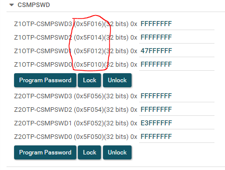

2. The CSMPSWD seems stores in OTP, but the address of CSMPSWD in Uniflash can't match with OTP address range, why?

    That address is for KEYx registers which user can update with correct password value to unlock the Zone.

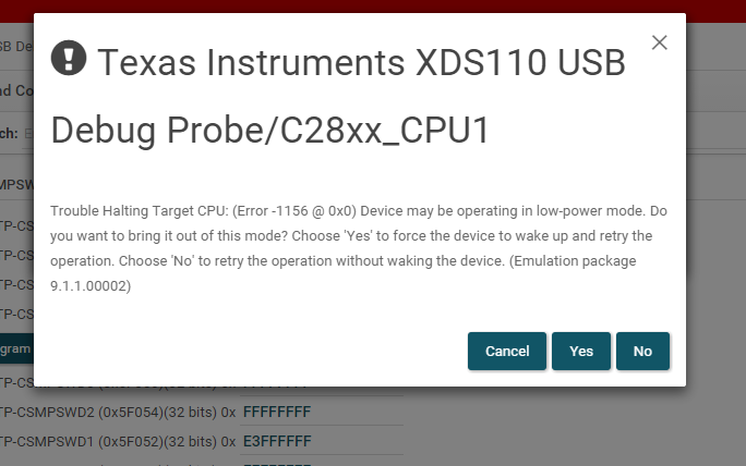

    But the device seems can't be unlock through uniflash and JTAG even I using correct key to unlock it, It shows a message as below, can you please help me know how to unlock device?
    It shows a error message after click on "Unlock" botton,
    When I using CCS for testing connection, it could connect correctly.

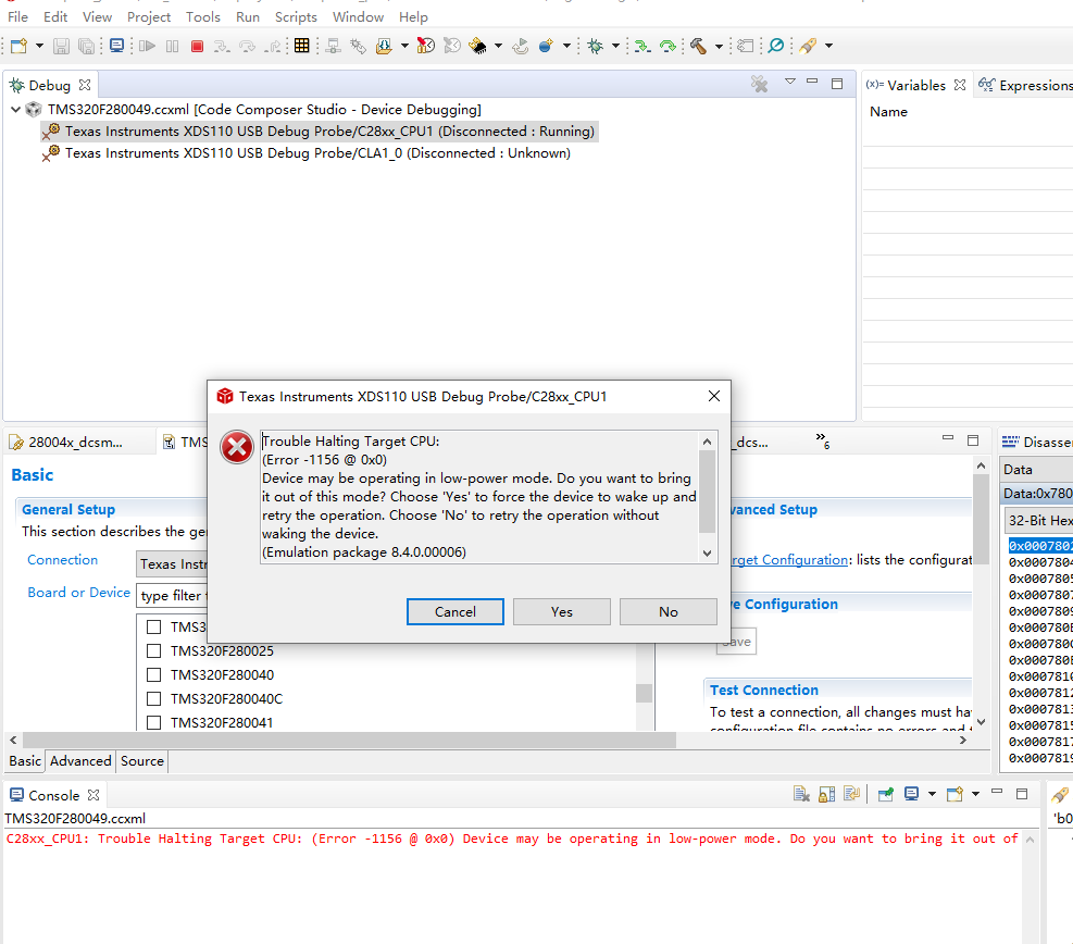

  • When I trying to connect device through CCS debug session, it reminds the device is in low power mode.
    I'm pretty sure that device is runing since I could communicate with device via UART.
  • Jack,
    If you have programmed the security setting in device then you need to change the BOOTMODE pin setting to be in WaitBoot (please refer BOOT ROM section in TRM for detail on bootmodes) and then try to connect after reset (power cycling the board).
    Vivek Singh
  • Hi Vivek,
    Thanks for your suggestion.
    I figured out this relates to my code that calls ROM flash api. It looks that it has to unlock device before call rom flash api, but rom is unsecure. Is it possible to set ROM as secure to zone1?
  • Hi Jack,
    No, we can not secure the ROM. You have to load the flash API in one of your flash sector if want to perform secure flash operations.
