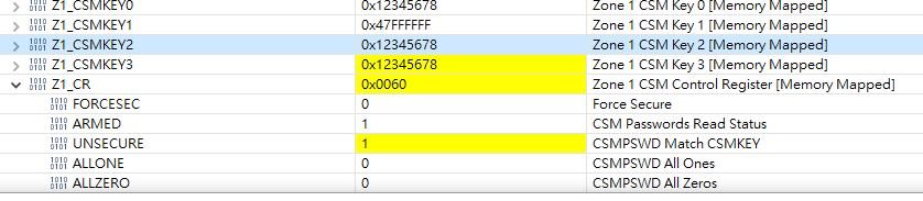

    I used following command from uniflash to program dcsm settings, it did program the setting into OTP , however
    C:\ti\uniflash_5.1.0\dslite.bat --mode flash -c C:\Users\vincentyllin\Desktop\uniflash_cmdline\TMS320F280049.ccxml -e -g C:\Users\vincentyllin\Desktop\uniflash_cmdline\program.txt -v -s Z1B0OTPGPREG1=5AFFFFFF -s Z1B0OTPGPREG2=5AFFFFFF -s Z1B0OTPGPREG3=FFFFFF03 -s Z1B0PSWDLOCK=FB7FFFF0 -s Z1B0CRCLOCK=4BFFFFFF -s Z1B0CSMPSWD3=12345678 -s Z1B0CSMPSWD2=12345678 -s Z1B0CSMPSWD1=47FFFFFF -s Z1B0CSMPSWD0=12345678 -s Z1B0GRABSECT=AAAAAA55 -s Z1B0GRABRAM=0000AAAA -s Z1B0EXEONLYSECT=0000FFF0 -s Z1B0EXEONLYRAM=000000FF -s Z1B1GRABSECT=AAAAAAAA -s Z1B1EXEONLYSECT=0000FFFF -s Z2B0OTPGPREG1=5AFFFFFF -s Z2B0OTPGPREG2=5AFFFFFF -s Z2B0OTPGPREG3=FFFFFF03 -s Z2B0CRCLOCK=0FFFFFFF -s Z2B0PSWDLOCK=BF7FFFF0 -s Z2B0GRABSECT=555556AA -s Z2B0GRABRAM=0000AAAA -s Z2B0EXEONLYSECT=0000001F -s Z2B0EXEONLYRAM=000000FF -s Z2B1GRABSECT=55555555 -s Z2B1EXEONLYSECT=00000000 -b Z1PasswordProgram -b Z2PasswordProgram -b Z1Unlock -b Z1B0AllProgram -b Z1B1AllProgram -b Z2B0AllProgram -b Z2B1AllProgram
    However I run into similar problem with this post 2 years ago.
    https://e2e.ti.com/support/microcontrollers/c2000-microcontrollers-group/c2000/f/c2000-microcontrollers-forum/866630/ccs-tms320f280049-dcsm-programed-and-set-for-flash-boot-but-the-processor-will-not-startup
    where MCU's flash registers show error in the 0x78014 , 0x78014, like the link shown above.

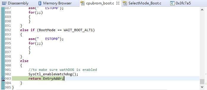

    I am not sure if this is a bug my MCU/Uniflash ,so I decide to find a new f280049 mcu and  program dcsm without touching pswdlockand crclock with following commnad
    C:\ti\uniflash_5.1.0\dslite.bat --mode flash -c C:\Users\vincentyllin\Desktop\uniflash_cmdline\TMS320F280049.ccxml -e -g C:\Users\vincentyllin\Desktop\uniflash_cmdline\program.txt -v -s Z1B0OTPGPREG1=5AFFFFFF -s Z1B0OTPGPREG2=FFFFFFFF -s Z1B0OTPGPREG3=FFFFFF03 -s Z1B0CSMPSWD3=12345678 -s Z1B0CSMPSWD2=12345678 -s Z1B0CSMPSWD1=47FFFFFF -s Z1B0CSMPSWD0=12345678 -s Z1B0GRABSECT=AAAAAA55 -s Z1B0GRABRAM=0000AAAA -s Z1B0EXEONLYSECT=0000FFF0 -s Z1B0EXEONLYRAM=000000FF -s Z1B1GRABSECT=AAAAAAAA -s Z1B1EXEONLYSECT=0000FFFF -s Z2B0OTPGPREG1=5AFFFFFF -s Z2B0OTPGPREG2=5AFFFFFF -s Z2B0OTPGPREG3=FFFFFF03 -s Z2B0CRCLOCK=0FFFFFFF -s Z2B0PSWDLOCK=BF7FFFF0 -s Z2B0GRABSECT=555556AA -s Z2B0GRABRAM=0000AAAA -s Z2B0EXEONLYSECT=0000001F -s Z2B0EXEONLYRAM=000000FF -s Z2B1GRABSECT=55555555 -s Z2B1EXEONLYSECT=00000000 -b Z1PasswordProgram -b Z1Unlock -b Z2Unlock -b Z1B0LINKPOINTERProgram -b Z1GPREGProgram -b Z1OTPBOOTCTRLProgram -b Z1B0GRABProgram -b Z1B0EXEONLYProgram -b Z1B1LINKPOINTERProgram -b Z1B1GRABProgram -b Z1B1EXEONLYProgram -b Z2B0LINKPOINTERProgram -b Z2GPREGProgram -b Z2OTPBOOTCTRLProgram -b Z2B0GRABProgram -b Z2B0EXEONLYProgram -b Z2B1LINKPOINTERProgram -b Z2B1GRABProgram -b Z2B1EXEONLYProgram
    after program , It still stuck in boot-rom,
    1. Load the boot-rom symbol
    2. Change bootpin_config_key to 0xA5
    3. Successfully read OTP and gointo case of flash boot with 0x80000 as entryaddress
    4. return 0x80000 as starting address
    5. went into illegal interrupt after
    However if I unlock dcsm z1 with mcu register before return EntryAddr, it has no problem boot into my flash image
    Am I not able to run flash image when the flash sector is secure by Z1 as EXEONLY?
    It was working fine before dcsm is programmed, now I set Z1 to protect first image with exeonly  and Z2 protect second image with exeonly,
    Do I need to unlock Z2 before boot into second image ?
    No, code should be able to jump to secure function from unsecure so unlocking Z2 is not needed.
