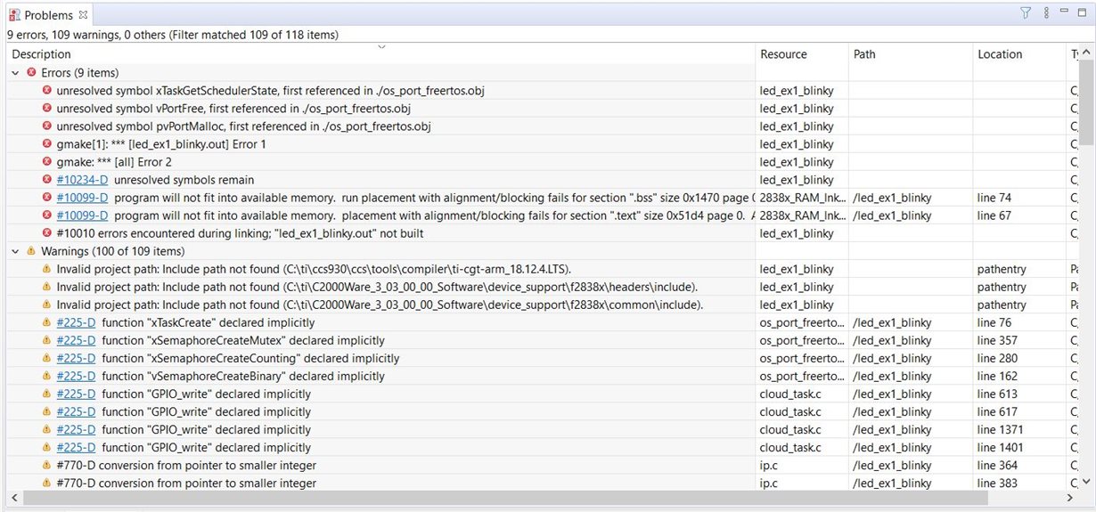

Hello, I have a TMS320F28388D rev MCU063A with docking station and am trying to make ethernet function. I have the issue that my program will not fit into avalable memory. I am not sure how to modify the 2838x_RAM_Ink_cpu1.cmd  file. Can someone help me? I also need help understanding what this file even does, I am very new to this. I am also getting alot of warnings which I am not sure how to correct. The code was originally used with a TI_ARM compiler on an MSP432e401y that I am trying to port over to my MCU. I ran into packed struectures which I removed because I read that c2000 doesn`t support packed structures.
Console output below:
**** Build of configuration CPU1_RAM for project led_ex1_blinky ****

Building target: "led_ex1_blinky.out"
Invoking: C2000 Linker
"C:/ti/ccs1011/ccs/tools/compiler/ti-cgt-c2000_18.12.4.LTS/bin/cl2000" -v28 -ml -mt --cla_support=cla2 --float_support=fpu32 --idiv_support=idiv0 --tmu_support=tmu0 -Ooff --define=DEBUG --define=CPU1 --diag_suppress=10063 --diag_warning=225 --diag_wrap=off --display_error_number --gen_func_subsections=on --abi=eabi -z -m"led_ex1_blinky.map" --stack_size=0x100 --warn_sections -i"C:/ti/ccs1011/ccs/tools/compiler/ti-cgt-c2000_18.12.4.LTS/lib" -i"C:/ti/ccs1011/ccs/tools/compiler/ti-cgt-c2000_18.12.4.LTS/include" --reread_libs --diag_wrap=off --display_error_number --xml_link_info="led_ex1_blinky_linkInfo.xml" --entry_point=code_start --rom_model -o "led_ex1_blinky.out" "./arp.obj" "./cloud_task.obj" "./cpu_endian.obj" "./date_time.obj" "./dhcp_client.obj" "./dhcp_common.obj" "./dns_cache.obj" "./dns_client.obj" "./dns_common.obj" "./ethernet.obj" "./f2838x_codestartbranch.obj" "./f2838x_cputimers.obj" "./f2838x_defaultisr.obj" "./f2838x_globalvariabledefs.obj" "./f2838x_gpio.obj" "./f2838x_piectrl.obj" "./f2838x_pievect.obj" "./f2838x_sysctrl.obj" "./f2838x_usdelay.obj" "./httpcli.obj" "./icmp.obj" "./icmpv6.obj" "./igmp.obj" "./ip.obj" "./ipv4.obj" "./ipv4_frag.obj" "./ipv6.obj" "./ipv6_frag.obj" "./ipv6_misc.obj" "./ipv6_pmtu.obj" "./led_ex1_blinky.obj" "./mdns_common.obj" "./mld.obj" "./modbus_client.obj" "./modbus_client_misc.obj" "./modbus_client_pdu.obj" "./modbus_debug.obj" "./modbus_server.obj" "./modbus_server_misc.obj" "./modbus_server_pdu.obj" "./nbns_client.obj" "./nbns_common.obj" "./nbns_responder.obj" "./ndp.obj" "./ndp_cache.obj" "./ndp_misc.obj" "./ndp_router_adv.obj" "./net.obj" "./net_mem.obj" "./nic.obj" "./os_port_freertos.obj" "./slaac.obj" "./sleep_freertos.obj" "./socket.obj" "./str.obj" "./tcp.obj" "./tcp_fsm.obj" "./tcp_misc.obj" "./tcp_timer.obj" "./udp.obj" "./FreeRTOS/list.obj" "./FreeRTOS/queue.obj" "./FreeRTOS/tasks.obj" "./FreeRTOS/port/port.obj" "./FreeRTOS/port/portasm.obj" "../2838x_RAM_lnk_cpu1.cmd" "../f2838x_headers_nonBIOS_cpu1.cmd" -llibc.a
<Linking>
warning #10210-D: creating ".sysmem" section with default size of 0x400; use the -heap option to change the default size
"../2838x_RAM_lnk_cpu1.cmd", line 74: error #10099-D: program will not fit into available memory. run placement with alignment/blocking fails for section ".bss" size 0x1470 page 0. Available memory ranges:
RAMLS5 size: 0x800 unused: 0x800 max hole: 0x800
"../2838x_RAM_lnk_cpu1.cmd", line 67: error #10099-D: program will not fit into available memory. placement with alignment/blocking fails for section ".text" size 0x51d4 page 0. Available memory ranges:
RAMD0 size: 0x800 unused: 0x0 max hole: 0x0
RAMD1 size: 0x800 unused: 0x0 max hole: 0x0
RAMLS0 size: 0x800 unused: 0x0 max hole: 0x0
RAMLS1 size: 0x800 unused: 0x0 max hole: 0x0
RAMLS2 size: 0x800 unused: 0x0 max hole: 0x0
RAMLS3 size: 0x800 unused: 0x0 max hole: 0x0
RAMLS4 size: 0x800 unused: 0x0 max hole: 0x0
undefined first referenced
symbol in file
pvPortMalloc ./os_port_freertos.obj
vPortFree ./os_port_freertos.obj
xTaskGetSchedulerState ./os_port_freertos.obj
error #10234-D: unresolved symbols remain
error #10010: errors encountered during linking; "led_ex1_blinky.out" not built
>> Compilation failure
makefile:210: recipe for target 'led_ex1_blinky.out' failed
gmake[1]: *** [led_ex1_blinky.out] Error 1
makefile:206: recipe for target 'all' failed
gmake: *** [all] Error 2
**** Build Finished ****
  • Hi John,
    The linker command file is used during the link stage of the project build where the linker combines object files and allocates sections into the target system's configured memory. The linker command is used to allocate code sections into specific areas of memory.
    Refer to the following link Linker Command File Primer . It covers the basics of linker command files, focusing on the MEMORY and SECTIONS directives.
    The error which you are observing indicates that the code section (.text) is too large and will not fit into the specified sections. You can try using compiler optimization (-o2) option in the project properties to see if this resolves the issue. If not, then you will have to reduce the code size so that it fits into the available memory range.
