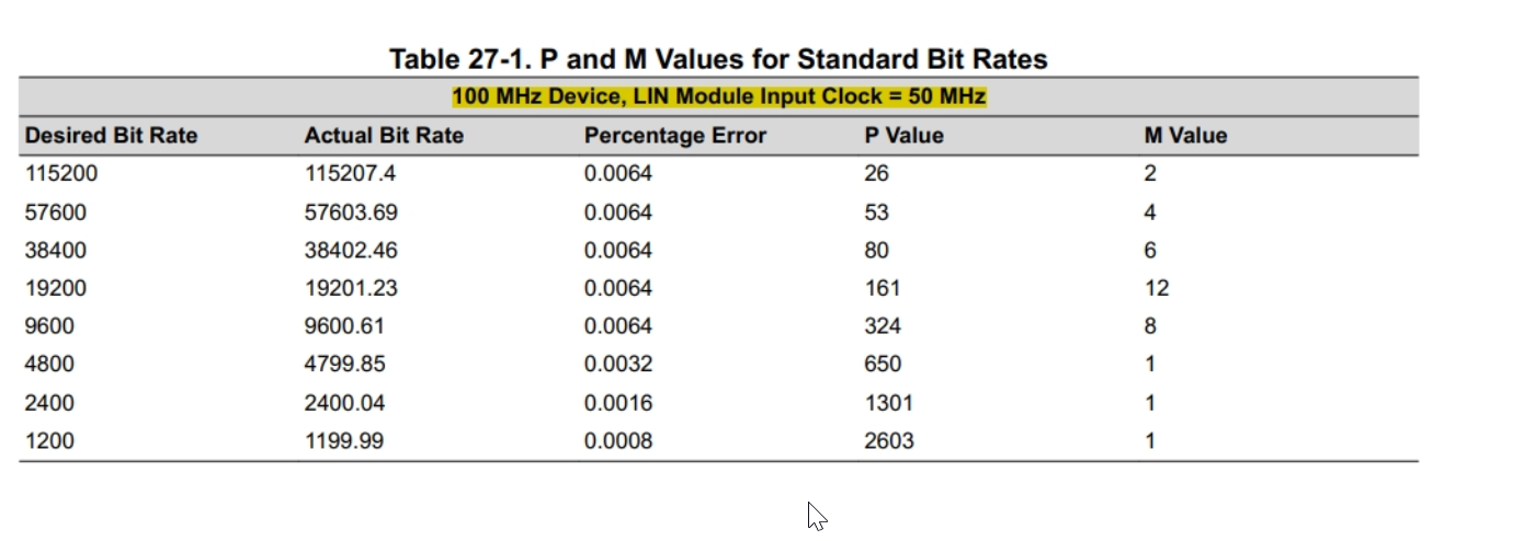

From the TRM, the LIN module input clock is 50MHz, which is one-half the CPU clock (SYSCLKOUT). any register to set this frequency division? or it is a fixed value from one-half the CPU clock (SYSCLKOUT)? I did not find where 50MHz derive from.

  • Hi Quote,
    Thanks for your reply, input clock to the LIN is 100MHz or is 50MHz? actually my customer do the configuration for baud rate according to 50MHz as the below table showed,  it will fail to communicate, but if they use 100MHz for calculation, then it will work.
    For example, if they set P value as 53, M value as 4, then selected 57600 as bit rate according to the below table, then if the PC GUI set baud rate as 57600, then it will fail to communicate, but if PC GUI set  baud rate as 115200bps, then it will communicate successfully.

  • There is the following in the System Control and Interrupts chapter of the TMS320F28004x Real-Time Microcontrollers Technical Reference Manual (Rev. D) which shows that the clock source to the LIN module is PERx.SYSCLK:
    In the Local Interconnect Network (LIN) chapter of TMS320F28004x TRM should mention of VCLK should be changed to PERx.SYSCLK?
  • PERx.SYSCLK is 100MHz, but LIN module input clock is 50MHz as the TRM mention.it seem it is not clearly how 50MHz clock come from.
  • Hi Strong - Table in TRM chapter needs to be corrected, VCLK is same as PERx.SYSCLK, there is no divider in the path. Table should indicate LIN input clock = 100MHz. We will file a ticket to get this updated for next release.
