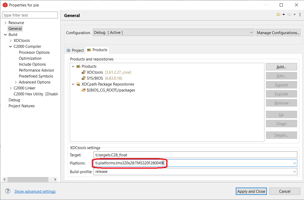

    In CCS go to File -> New -> CCS Project, pick one of the F28004x parts, and grab whatever example you want to start with from the templates and examples box. I picked TMS320F280049C and the "pie" example.
    When the example is created, go into the project properties and correct the device variant in the general settings Project tab to your F28002x part and switch the output format from COFF to EABI. On the Products tab however, change the XDStools platform back to the F28004x since BIOS won't recognize the F28002x.

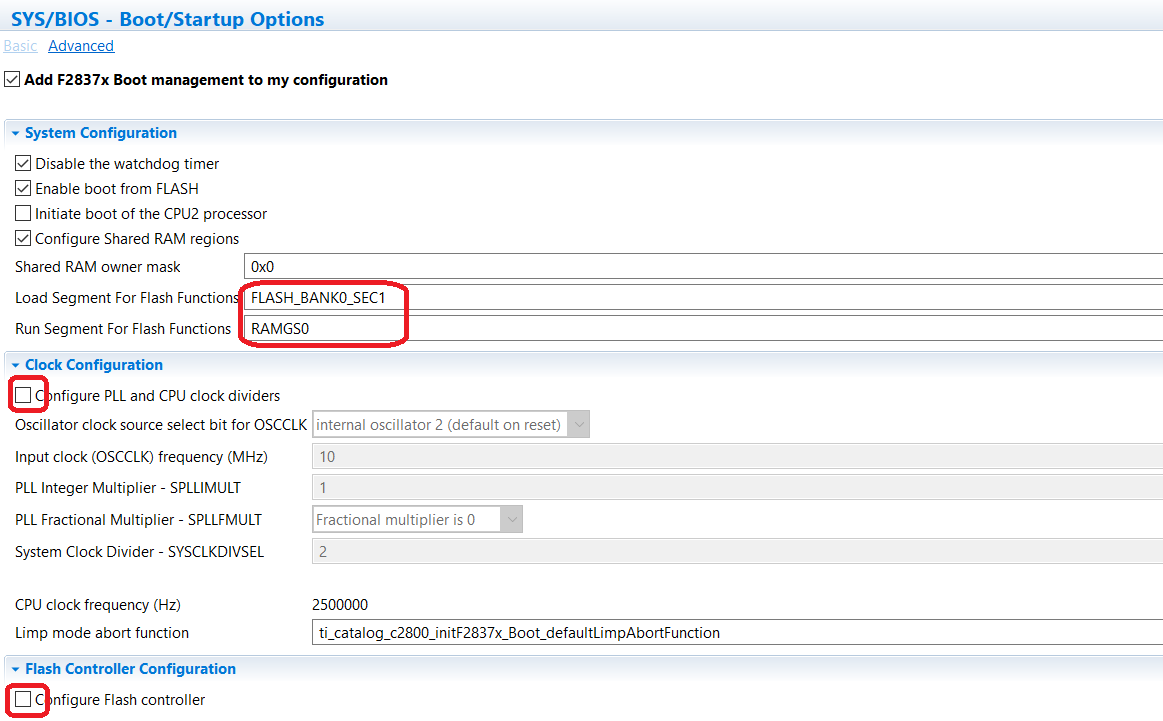

    If you try building at this point, you'll see a few linker errors related to the default "flashfuncs" settings using memory names that don't exist in your .cmd file. Correct these settings in the .cfg file to use ones that actually exist.
    While you're editing the Boot module, also disable "Configure PLL and CPU clock dividers" and "Configure Flash controller". This is the one place where I believe there is some incompatibility between the F28004x SYS/BIOS implementation and the F28002x. You can just call driverlib's SysClk_setClock() and Flash_initModule() functions instead either in main() or earlier if you use one of the SYS/BIOS reset function hooks.
