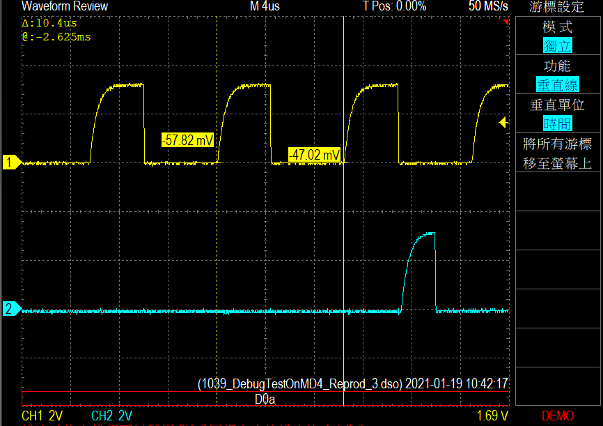

Sometimes it just worked fine, but sometimes it received data and put a "NACK". After logic analysis, it is inspected that some byte seems to "lack a clock pulse" probably as shown below :
In normal situation, you will see like :
When it works abnormally, you will see like :
Why's that? Did you have any suggestion?

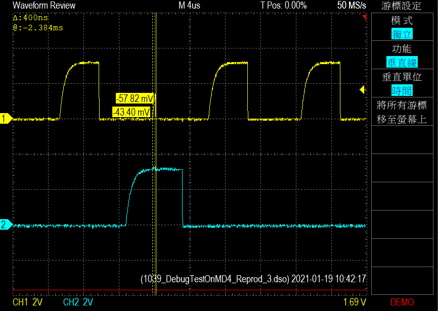

    Today I found another strange problem. CM-I2C module occassionally lack a clock like the picture below:
    I guess it seems to get into the same situation like the original problem I posted. But this time, it made EEPROM chip stuck and software thought the whole process ran out.

    Ninth SD-Cx clock pulse in your oscilloscope picture looks like noise glitch. This is possibly affecting the I2C state machine. I woutd think finding ways to remove noisy glitch to get over the issue.
    With pull-up resistor looking good, I would try adding series resistors (around 20 - 30 ohms) and 50pf on SCL / SDA lines.This should eliminate noisy glitches.

    Sometimes it reproduce the condition like the previous observation (the spike about 400 ns). The condition of clock missing is not fixed at certain step in program. It occurred uncertainly.

    I don't agree that spike came from other devices. After that spike missed, you can see the SCL held low for a certain period just like other normal pulses in the later duty. On the other hand, probably CM-I2C drained that bus for 400 ns and release it. Even the rising time of that signal is familiar to the normal pulses if you watch it in detail.

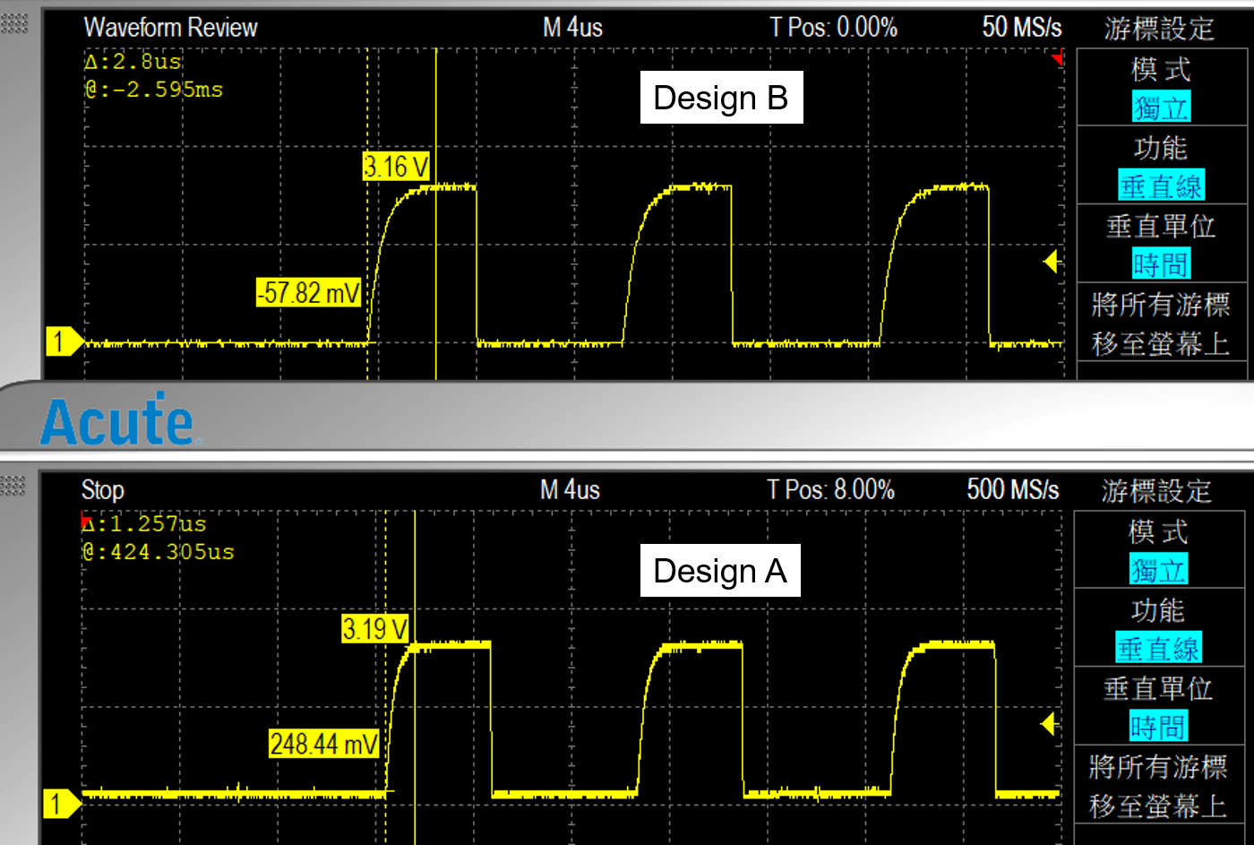

    I got news with your suggestion. "Clock missing" still happened when we changed our pull-up resistor into 1.6 kohm. Suggestion with capacitor serial-connection has not been tested yet. In my arrogant opinion, if it is actually caused by EMI noises, capacitor serial-connection might be not helping.
    I observed I2C bus with another circuit design (later called design A) which never happened that condition which means "clock missing". The rising time of pulses seems to be less than the circuit (later called design B) which usually happened that condition.
    May this condition be the key of "clock missing"? Does TI guarantee that CM-I2C module shall work fine with the certain rising time of SCL pulses?

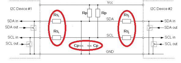

    Design A (with 1.6 Kohm pull resistor) has faster rise time compared to Design B (with 3.3 Kohm pull resistor). This behavior is expected because a stronger pull-up will charge the bus capacitor faster. It however doesn't help with reducing noise. That can be only achieved with including ferrite beads, series resistor and increasing bus capacitor which acts as low pass filter. When you increase your bus capacitance, you generally need to have a stronger pull-up to have faster rise time.
    I would try series termination resistor 33 ohms and bus capacitance of say 50pF and see whether problem goes away. If not you may need to try playing around with different combination of series resistor / bus capacitance.
    Rs1, RS2 are the series termination resistors. These series resistor has to be placed as close as possible to device pins.
    Cp is the bus capacitance
