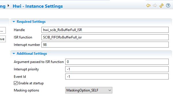

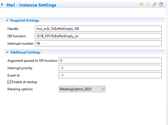

I am porting over a SCI driver and protocol handler to a SYS/BIOS project.
Do I need to configure a HWI for the SCI interrupts? Or can I just use my existing driver to set up the interrupts and ISRs.
Here's how I configure the interrupts and ISR
      case SCIB_UART_PORT:
            PieVectTable.SCITXINTB = (PINT)&SCIB_FIFOTxBufferEmpty_isr;
            PieVectTable.SCIRXINTB = (PINT)&SCIB_FIFORxBufferFull_isr;
            PieCtrlRegs.PIEIER9.bit.INTx3 = 1;
            PieCtrlRegs.PIEIER9.bit.INTx4 = 1;
            IER |= M_INT9;
            break;
        will any of these be overwritten by SYS/BIOS?
        If doing it this way is an issue, could you please show me the steps to set up an HWI?  See below. Did I set them up correctly?
        What else do I need to do?
       Stephen
  • I'd recommend using a Hwi, especially if you want to be able to call SYS/BIOS functions from inside the ISR. Your Hwi setup looks fine. Make sure to remove the code that writes to PieVectTable from your application. SYS/BIOS is going to fill the vector table with its Hwi dispatcher which will call the ISR function, so writing to PieVectTable yourself with overwrite the SYS/BIOS configuration which can cause scheduler issues.

  • Hello whitney,
    thanks.
    Do I still ack the PIE (e.g.   PieCtrlRegs.PIEACK.all |= PIEACK_GROUP8; // Must acknowledge the PIE group)  at the end of the ISR or does sys/bios do that?
    Stephen
  • Also, will sys/bios do all the following:
          IER |= M_INT9;
  • Yes, by default, SYS/BIOS will perform the ACK, configure the PIE vector table, and enable the interrupts in both the PIE and the CPU (IER).
    If you don't want SYS/BIOS to automatically do the enable, you can uncheck that "Enable at startup" box and then use the Hwi_enablePIEIER and Hwi_enableIER functions to enable it later in the application.
    Whitney
