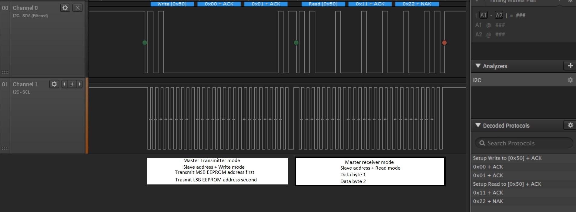

  • Ashish,
    RandomRead needs master transmitter (which transmits EEPROM address to be read) + Repeated start in master receiver mode to read EEPROM contents as shown below. Your example doesn't seem to show master transmitter + master receiver. I just see master receiver mode.

  • Ashish,
    I have clearly specified in the I2C logic analyzer image on how exactly you need to perform EEPROM random read.
    Did you check with EEPROM manufacturer whether you are sending the address in right format? Does your EEPROM expect the address in the same format?

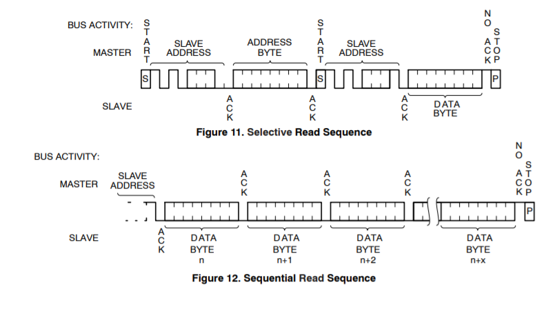

  • Hello Manoj,
    Here is snapshots from Datasheet of my EEPROM, in here RandomRead is named by selective read
    As you can see it is sending 8 address bits and 8 data bits.
