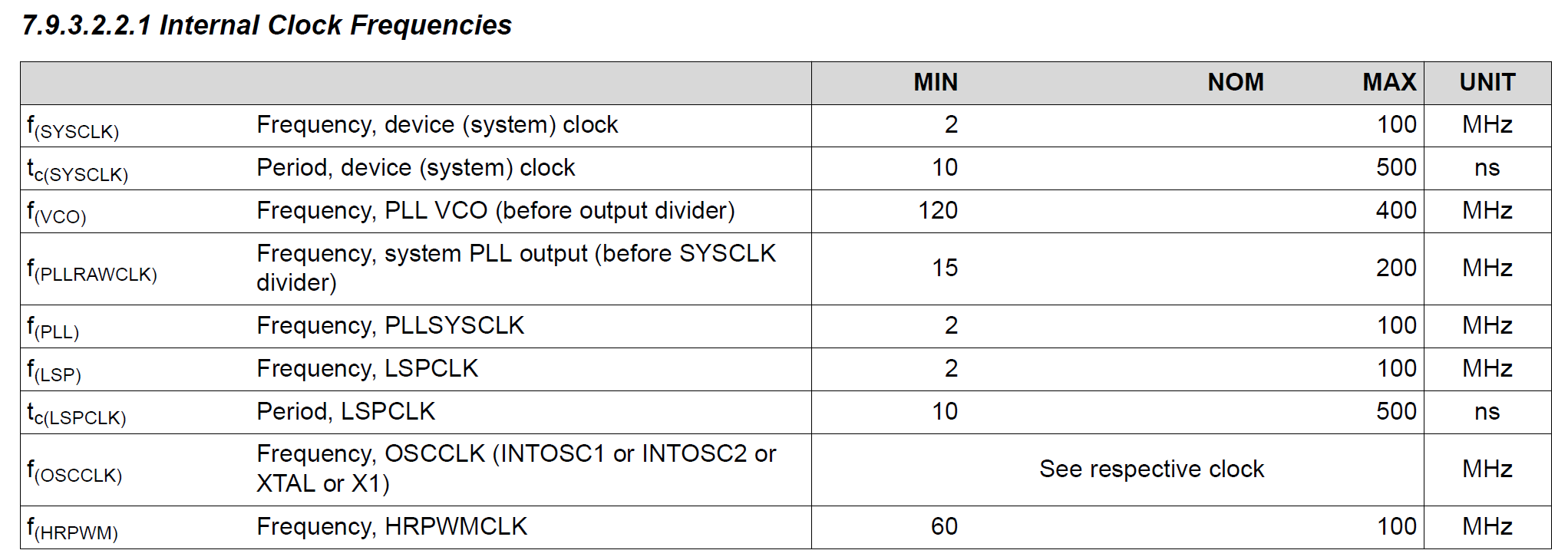

I am supporting customer configuring F280048 project.
And they use an 16MHz XTAL_OSC
according to the datasheet, PLL structure.
I think there are two method to achieve it.
one is
// PLLSYSCLK = 16MHz (XTAL_OSC) * 25 (IMULT) * 1 (FMULT) / 4 (PLLCLK_BY_4)
SysCtl_setClock(SYSCTL_OSCSRC_XTAL |
SYSCTL_IMULT(25) |
SYSCTL_FMULT_NONE |
SYSCTL_SYSDIV(4) |
SYSCTL_PLL_ENABLE);
the other is
// PLLSYSCLK = 16MHz (XTAL_OSC) * 12 (IMULT) * 0.5 (FMULT) / 2 (PLLCLK_BY_2)
                 SYSCTL_IMULT(12) |
                 SYSCTL_FMULT_1_2 |
                 SYSCTL_SYSDIV(2) |
                 SYSCTL_PLL_ENABLE);
and I found they both meet the clock spec,
did you find any mistake?
which one do you recommend?
BR
Emma
  • Hi Emma,
    Both PLL setups are fine but I would choose the second method and avoid running VCO at the maximum limit.  Having VCO at 200MHz (12.5 * 16MHz) is running it at NOMINAL conditions which is better than running VCO at 400MHz (25 * 16MHz) right at the edge of the operating range.
    Joseph
