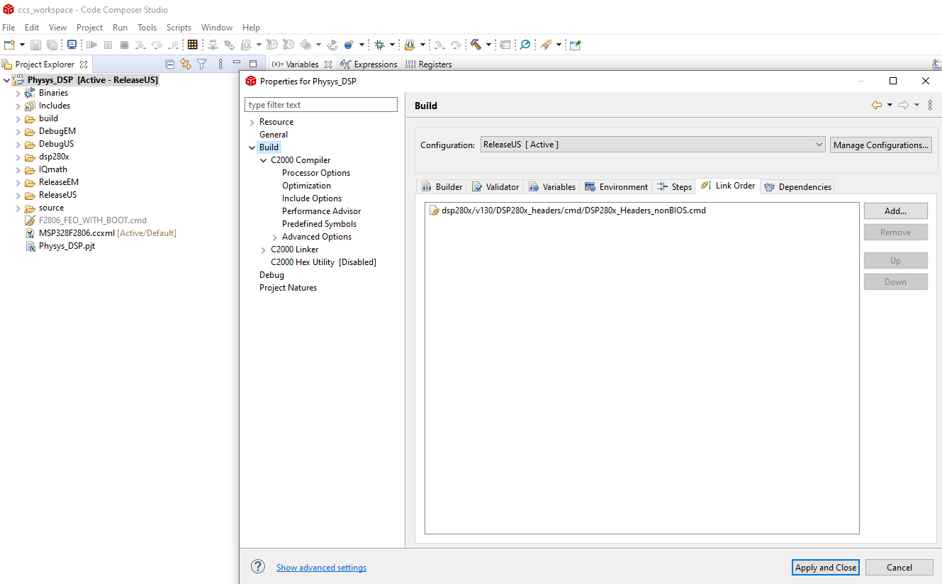

I transfered a legacy CCS project to the current CCS and have some trouble with the linker script.
After importing the build properties already show several configurations (which is expected) but no Linker command file is selected. If I select the desired linker command file I get errors such as:
"RAML0 memory range has already been specified"
also in the resulting *.map file I can see two entries for several things which makes me assume that somehow another linker command file is being used. If I exclude my cmd from the project the build runs through successfully.
Is there a log file or anything that could tell me what cmd is currently being used?
Further trouble occured when I enables the C2000 hex utility. Suddenly I can't build anymore with the same error as above. Disabling it again solves the issue. I do need that hex file though.
Another thing I thought about are the default linker scripts used when I select a specific part. I assume that linker script is overwritten if I use my custom one? Anyway, I cannot even find a TMS320F2806 in there. All I could find are TMS320F2806x devices.

Can you check the "Show Build Settings.." --> CCS build --> C2000 Linker --> File Search Path.
It is possible that some linker files are added in the project. If you want to remove the default linker command file and add your own, you should remove from C2000 Linker -> File Search path. I am copying screenshot for your reference.
Hi Santosh,
thanks for the quick reply! Indeed the Project Root folder is added here and during the legacy import the command linker script got copied in that project root folder. However, that's actually fine so far. I just stop adding it manually and all should be fine.
