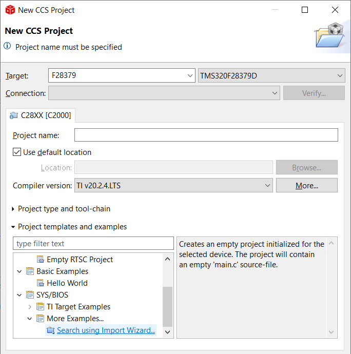

    SYS/BIOS and TI-RTOS examples can be found for supported devices in CCS by going to File -> New -> CCS Project, select your target, and see the "Project templates and examples" box. If you are looking for more than just an empty/template example, use the "More Examples…" -> "Search using Import Wizard" option.

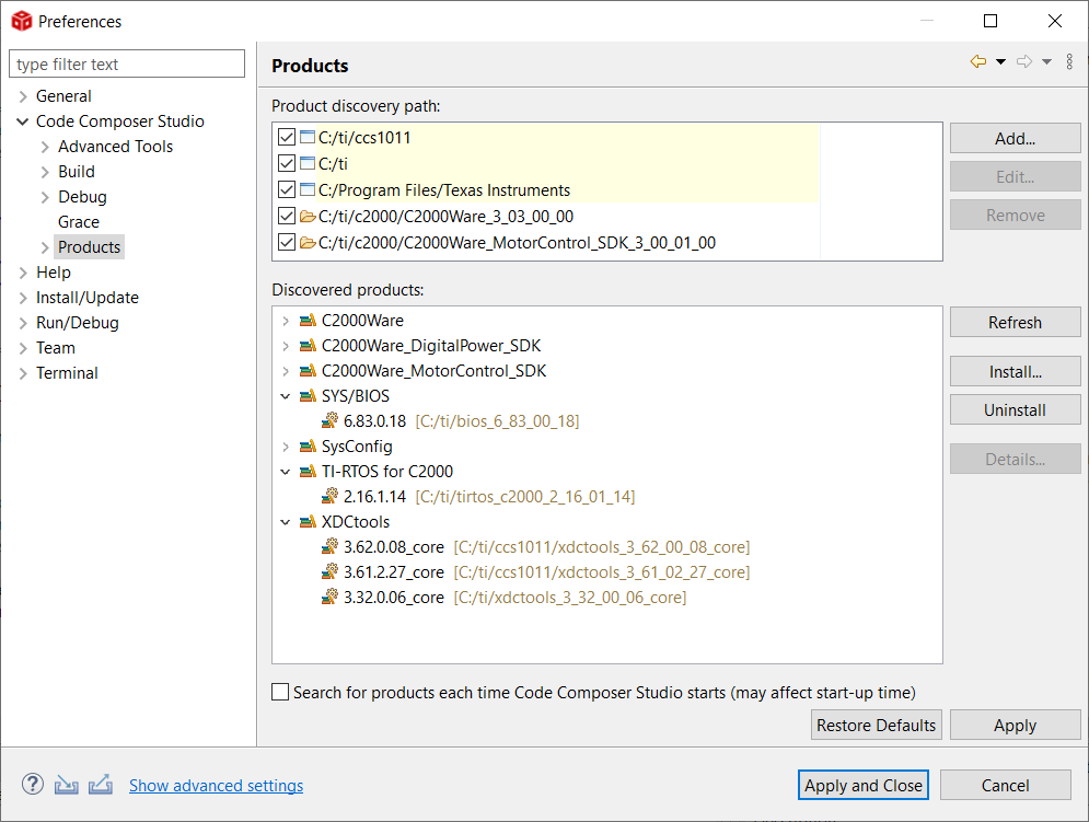

    Has CCS discovered the product? In CCS go to Window -> Preferences and then look under "Code Composer Studio" -> "Products". Is SYS/BIOS or TI-RTOS in the list of installed discovered products? If not, click the Refresh button to open a list of the discovered products available to be installed. Select the products you want to install in the list and click the Install button.
    If your product does not show up in the list, check the "Product discovery path" list; if you've installed it outside the default location, you may need to add the actual install location to the path and try Refresh again.
