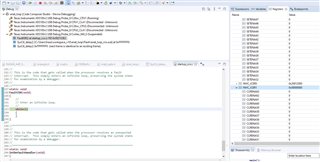

  • Hello Yashwant.
    I did what you suggested, however the program crashes on a FaultISR but I cannot find why.
    I just copied you the Registers state.

    R ERRORLOG_BUSFAULTFLG 0x0000000B 0x00000001
    R ERRORLOG_BUSFAULTCLR 0x0000000B 0x00000000
    R ERRORLOG_M4BUSFAULTADDR 0x0000000B 0x04F1ADB5

  • Have you tried increasing increasing the #define MEM_SIZE  in lwipopts.h. Can we put any limit to number of mqtt subscriptions?
    It is difficult for us to debug the cause without the whole system. We request you to debug it yourself and we will get back to you if we come into similar issue at our end.
    Yashwant
  • My mem_size is:
    #define MEM_SIZE                        (28 * 1024)  // default is 1600, was 16K
    I am finding that the program before failing, when it loses connection, spends a lot of time on the mem_malloc function of mem.c, which is called on f2838xif_transmit
    At the end, it seems a memory leak on the UDP and TCP /IP stack, I see the problem in both protocols.
    I think you need to review the driver about this. Sometimes get longer and sometimes shorter, but at the end it will fail, so I find it is not ready for a production environment.
  • Please, take a deep look at Tivaware LWIP port, in specific at file tiva-tm4c129.c in:
    C:\ti\tivaware_c_series_2_1_4_178\third_party\lwip-1.4.1\ports\tiva-tm4c129\netif
    I think it will save you a lot of work and effort.
    We did not have any problem with Tivaware lwip implementation during years, and I am seeing it with f28388D one.
    BR
  • We have tested today the system in a real-life environment and when any UDP or TCP protocol is enabled (via MQTT or just TCP alone) the memory degrades in time, making the device unusable in minutes (sometimes 5 min other times 20min, but it will fail).
    Please, check the driver and test it thoroughly. This device is not ready for production regarding Ethernet communications.
  • I have increased the MEM_SIZE up to 41 kB with no result. It takes a little longer but it dies at the end with both protocols: UDP and TCP.
  • Another issue i noticed with the lwip implementation.
    When a packet arrives, the application calls lwIPEthernetIntHandler() to handle the packet. If this function does not return fast enough, the data in this packet is overridden with newer packets that arrives, while you are handling the data. This happens because the DMA runs in background and it overrides the packet that is currently being handled with new data that it transfers from the PHY into the MCU.
    I noticed this issue while debugging and placing breakpoints where my application handles the incoming packet (UDP receive function). I solved it by halting the DMA interrupt while handling the packet (Ethernet_disableRxDMAReception). It might happen also during normal work.
    p.s. there is very low traffic on my net. i don't think its because i run out of packet buffer but im not sure. Anyway i think that new packets should be discarded rather then overrides packet that are currently being handled.
  • Ideally the Rx HW descriptor is owned by application while it is processing and the ownership is passed to DMA after processing in receiveISR only then the DMA can access the memory. But if the same memory region is shared across the packets then maybe there could be overwriting. We will look into this and will add Ethernet_disableRxDMAReception if necessary. Thanks for the suggestion.
  • Thank you Timor for the feedback. I do see the same behavior of lwIPEthernetIntHandler. Many times RX is not fast enough.
    I think this issue is overriding the pbufs, and at the end the MCU runs out of memory, because these overrided packets are never freed.
    Watch out about disabling DMA, because the process could be still running on the background and if not handled correctly, even launch a FaultISR interrupt.
    I hope Yashwant these leads could help you to find out the issue here. From my experience, tthe problems are happening with every protocol if you just give enough time to the program to run.
    I will wait for your feedback, but I would like to expect a long test from your side.
    Best Regards
  • Hello Timor. I have tried your proposal with no luck.
    Where are you placing your Ethernet_disableRxDMAReception calls? I am dong so in Ethernet_receivePacketCallbackCustom
    My code:
    Ethernet_Pkt_Desc* Ethernet_receivePacketCallbackCustom(
            Ethernet_Handle handleApplication,
            Ethernet_Pkt_Desc *pPacket)
    	Ethernet_Pkt_Desc* temp_eth_pkt;
        // Book-keeping to maintain number of callbacks received.
    #ifdef ETHERNET_DEBUG
        Ethernet_numRxCallbackCustom++;
    #endif
          //Pak test ERROR
          int i=0;
          for(i = 0U;i < Ethernet_device_struct.initConfig.numChannels;i++)
          	Ethernet_disableRxDMAReception(
                     Ethernet_device_struct.baseAddresses.enet_base,
                     i);
        // This is a placeholder for Application specific handling
        // We are replenishing the buffer received with another buffer
      //  return lwIPEthernetIntHandler(pPacket);
          temp_eth_pkt=lwIPEthernetIntHandler(pPacket);
          //Pak test ERROR
               Ethernet_enableRxDMAReception(
                     i);
          return temp_eth_pkt;
  • PAk, i have placed the calls at a higher level, in my UDP function. This is the function that is being called from udp_input. Its the receive function that you specify when you initialize the pcb using udp_new() and udp_recv(). But, for my understanding, placing the calls in Ethernet_receivePacketCallbackCustom() is the right place and i think it should work just as you did.
    I used a simpler calls:
    Ethernet_disableRxDMAReception(EMAC_BASE, 0);
    Ethernet_enableRxDMAReception(EMAC_BASE, 0);
    p.s. are you using any OS (RTOS)?
    I will try to move my calls to Ethernet_receivePacketCallbackCustom() and let you know.
  • Thank you Timor..
    No I am not using any OS.
    I have two setups, one using UDP as a server and another using UDP+ MQTT over TCP. In both of them the MCU is transmitting 1kB of data every 5ms through the UDP socket. Besides, a small MQTT message is sent if MQTT is enabled.
    At the end, it fails in both modes.
    Are you able to generate a scenario like that on your side to check that this is happening.
    I will wait for your test. Regards
  • Good Morning Yashwant.
    I would like to know if there is any advance on your side.
    Have you checked in medium time tests  (10 to 20 min) to debug this issue?
    I see the system crashes no matter the protocol used.
    Thank you
    Yes we were able to recreate your issue at memsize of 500 bytes. Still need to debug further on why the mem_free for those pkt descriptors is not being called in time by process_transmit(). Will try to add a recovery if mem_alloc fails transmit() function.
    Will get back to you in a day or so.
    Yashwant
  • PAk,
    Can you paste the lwip_stats value after transmitting 5-10 MQTT packets (lwip_stats.mem.used)? We want to see if this memory used value keeps on increasing or it gets reduced after successful transmission.
    In our case this value gets back to 0 after successful transmission of all packets be it tcp, icmp pkt.
    -Yashwant
  • I am trying to create an indepent project with both UDP and MQTT/TCP for you.
    Would you be able to provide me a example project (with other name different to enet_lwip) ready to import and modify on top of it?
    It could be useful if the files are local in src folder (not linked to C:\ti\c2000\C2000Ware_3_04_00_00\libraries\communications\Ethernet\third_party\lwip\examples\enet_lwip...., folder).
    Best regards
  • I have attached the latest enet_lwip project and linked files copied. You can use different workspace if name matches. As asked earlier, have you faced the memory leak issue with just the provided source code without any updates?
    If yes how did you recreate that issue? In my earlier reply 500 bytes of mem size is too low for the number of new packet descriptor being created in f2838xif_transmit() but at more than 5KB i see the (lwip_stats.mem.used) value going back to 0 after all packets are transmitted. So no memory leak is found.
    Can you also reply to this.
    enet_lwip_new.zip
    -Yashwant
  • Hello.
    With your code I am getting:
     undefined              first referenced
      symbol                    in file
     Ethernet_initRxChannel ./enet_lwip.obj
    Because on the file ethernet.c  the function is defined as:
    static uint32_t Ethernet_initRxChannel(Ethernet_ChInfo *chInfo)
    and not defined in ethernet.h, hence we need to add:
    //#include "driverlib_cm/ethernet.h"
    #include "driverlib_cm/ethernet.c"
  • Attached are latest ethernet driver files.
    ethernet.cethernet.h
    -Yashwant
  • Hello Yashwant. I am seeing the same error. Is it possitble that Driverlib_cm.lib has to be updated?
    I am seeing that ethernet.h is not detected but it is inclided and linked!! Quite strange. You can see my CCS screen.
  • Yes. You would have to import the f2838x/driverlib_cm project and rebuild it which will generate new driverlib_cm.lib after updating the ethernet files.

  • Hello again Yashwant.
    I have run a new test disabling MQTT and TCP, and enabling only UDP and the error happens in the same place. Here is the capture of the sequence with Lwip_stats.
    As you can see, this time instead of tcp_output, the mem overflow happens with a udp_sento call.
    All of the time, in lwip_stats is at 0 value (or just 1 packet), however, suddenly, the error is triggered and lwip_stats is full. I think the issue here is the driver stops working and memory get full quickly.
    This proves that the error comes from the driver and not from the application, since it is protocol independent.
    Best Regards
