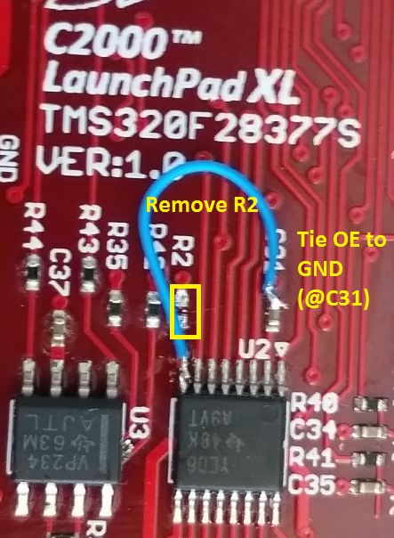

I have tried out some code on the bench. I see the same thing. At Frequencies faster than ~1.47MHz, these pulses would start to appear even when the SPI is not actively transmitting. I modified my board to tie OE to Ground by removing R2, then wiring the OE pin to the GND side of R31. This resolved the issue.
While this fixes the problem, for now, it does not explain why toggling the level shifter would cause a continuous train of runt pulses. I should note that I also saw it on the SPISIMO pin as well.
I will file a bug on the Launchpad and we will investigate the root cause and fix on the next revision.
Mark
(Here is an image of the modification)
