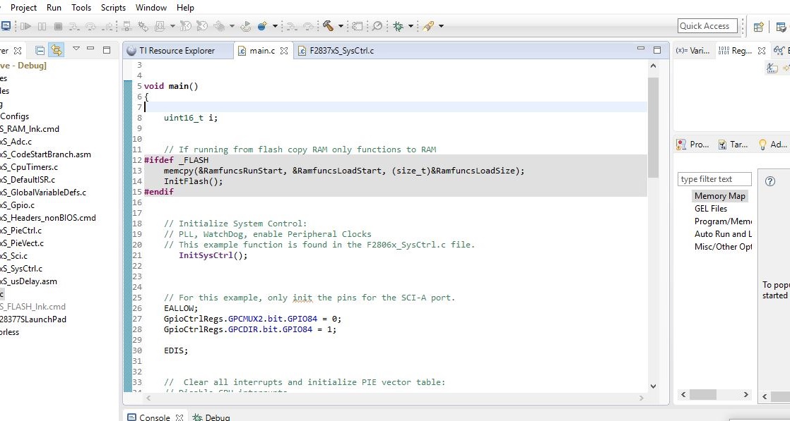

  • We have attached an image file of ccs screen which shows a different colour (grey).
    ​This part of the program is responsible for the flash. please look into this.

    If you haven't already, please start with the latest version of this demo located in C2000Ware (within device support examples).
    To run from flash, exclude the RAM linker and include the Flash linker. Go to project properties, Build->C2000 Compiler->Advanced options->Predefined Symbols and add "_FLASH" as a pre-define. You don't need to add "InitFlash()" within that #ifdef since it will be intialized within the InitSysCtrl(). When no longer debugging, set both switches to on to go to GetMode. Refer to the TRM ( http://www.ti.com/lit/spruhm8 ) for more info on boot modes.

    We tried to add _FLASH and thus the grey part turned normal and then as informed we kept the switches in respective positions for 'GetMode'.
    We tried to execute it through flash but the program didn't run.So, we tried executing it by stepping in by keeping the switches in WAIT mode.
    Here what we could observe was that, in 'SysCtrl.c', it got executed till 'InitFlash_Bank0'. But as soon as it entered the sub-routine 'void InitFlash_Bank0(void)', it showed error 'No source available for "0x3fe468" '.
    The image file of the error with the 'View Disassembly' file which shows this location "0x3fe468" is attached. We have also attached the folder of our program via google drive. Please look into this and kindly help us to get through this issue.​​
