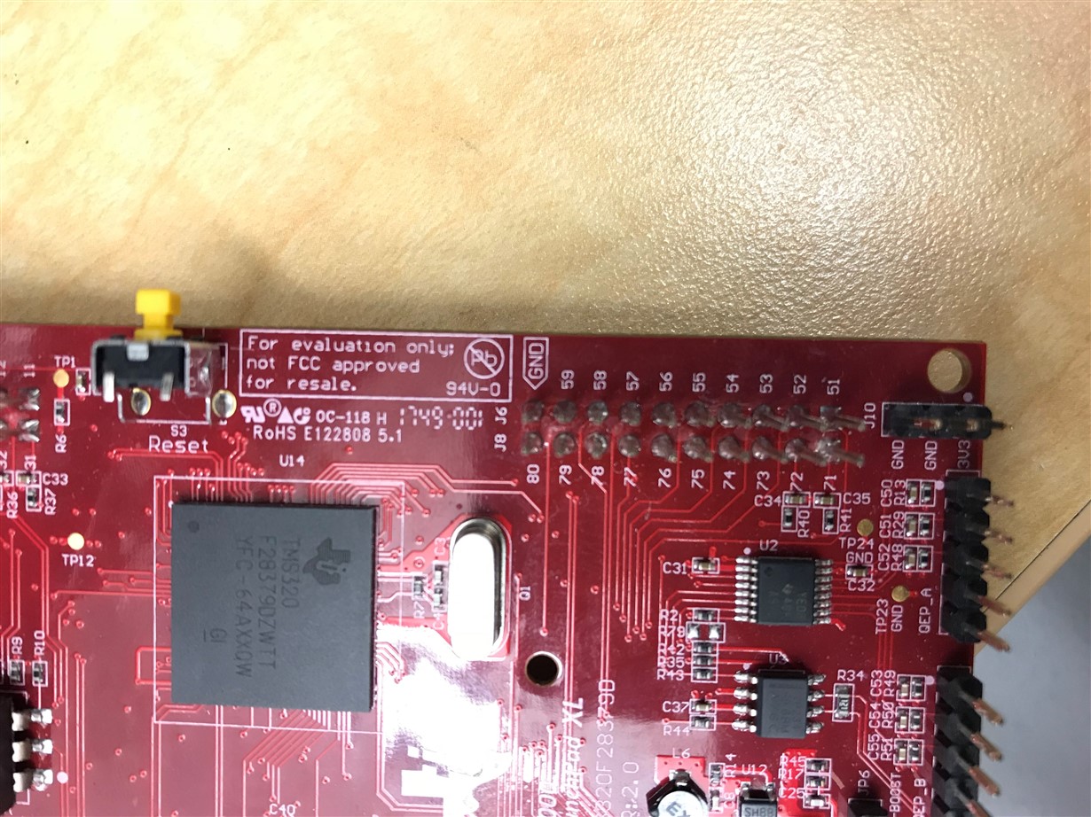

As shown in the above screenshot the physical board I am referring to is above one. As I was saying on schematic it shows GPIO 10 corresponds to 6th pin in J8 that means on the physical board it means pin 76. Is this understanding correct?
