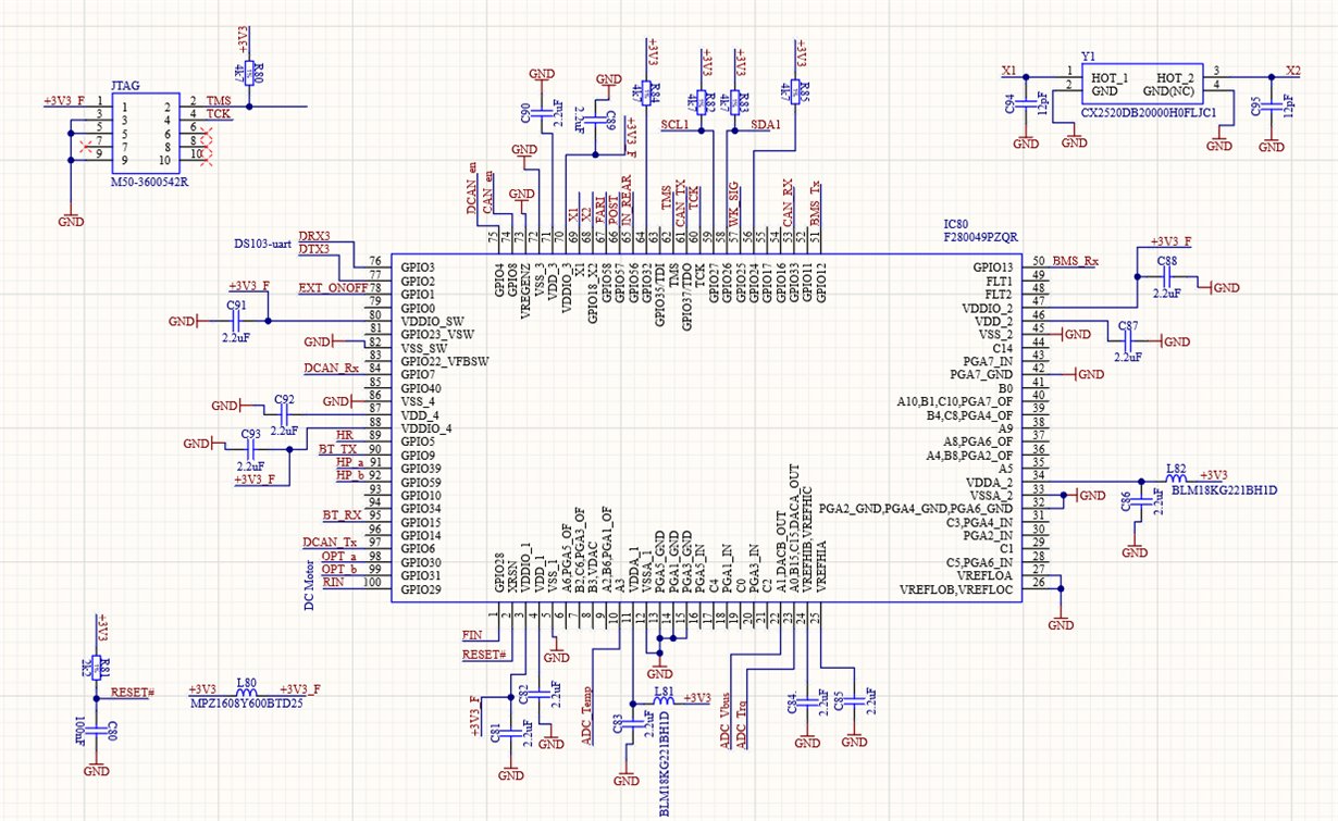

I'm working on a "powertrain" project (+48V battery supply). Six months ago, I had developed my custom board with F280049 MCU.
In this months of tests I had 2 times same failure. Yesterday last occourence. 3V3 power supply goes to GND and MCU become hotter without particular reason. No other components are broken.
After removing MCU I can see that VDDs pins are shorted to VSSs. If I replace MCU and reflash it, all the system restart to work without other issue.
I attach my schematic. Have I made connection errors? What can be the causes of a similar failure?
Stefano,
I check you power pin assignments - they look good. One possibility is that maybe one or more decoupling caps have been populated with a resistor. I understand that when you probe the failed MCU the VSS is shorted to VDD. Did you test the VSS and VDD on the board without the MCU?
Peter
Stefano,
Also from your schematic it is not clear if the VDD pins are interconnected on a single net (such as a power plane) - if not, they should be.
PEter
yes I tested VSS and VDD without MCU and they looks good.
When MCU fail 3v3 regulator goes to current limit state. If I remove MCU, all seems to be ok.
Yes, VDD come from single net after L80 ferrite.
Now my question is: What can cause the (only) MCU to break?
Stefano,
Some of the things that can cause the MCU to fail include providing voltage to power pins that is outside of spec and mishandling the chip/board where an electrostatic discharge can damage the device.
