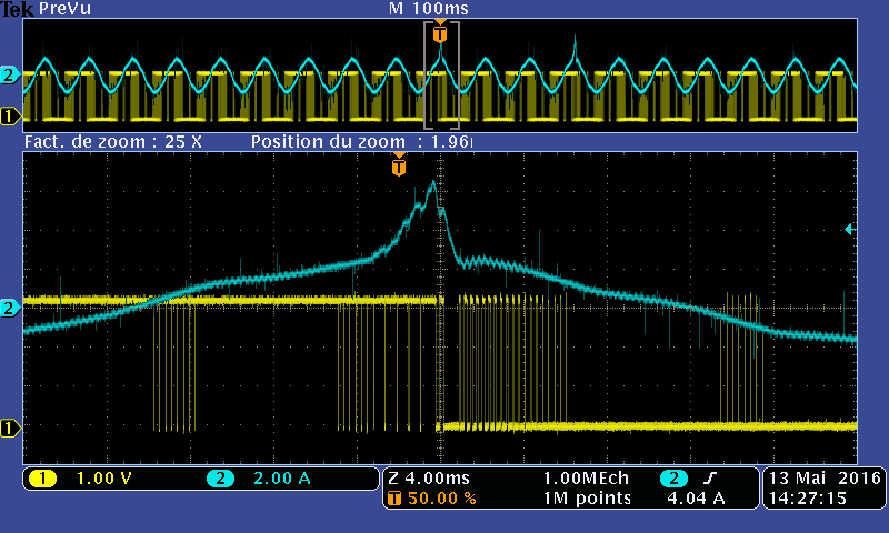

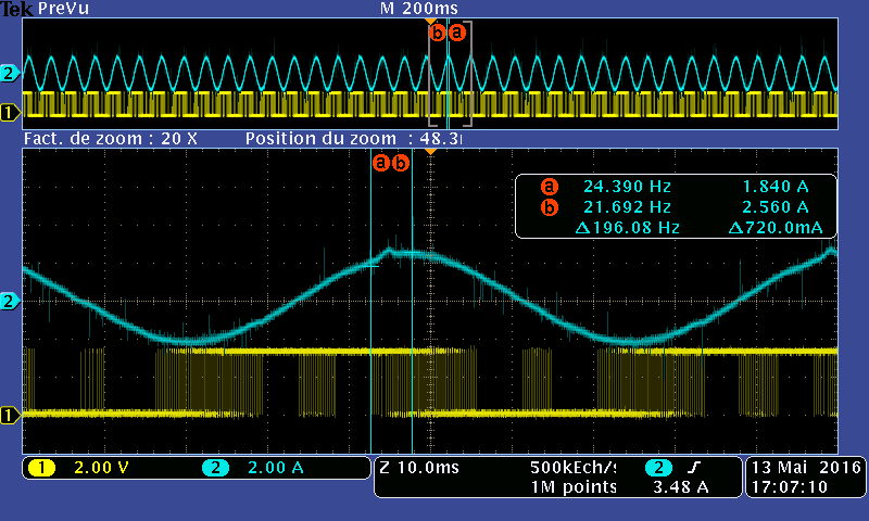

This configuration works with no issue until I increase gMotorVars.OverModulation around the value 0.61.
With this value sometime a "spike" appear always exactly on top of phase U current waveform (see zoom window below).
At the beginning I suspect the bootstrap capacitor to not be able to handle long pulses when the overmodulation enter in the trapezoidal phase.

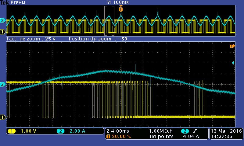

Channel 1: PWMHU.
Channel 2: Output Current on phase U.

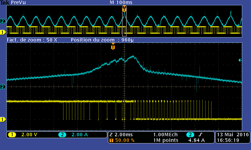

This capture show a zoom when the spike appear, I notice the PWMHU signal contain large pulse at that time compared to a "normal" waveform (check next scope capture below).

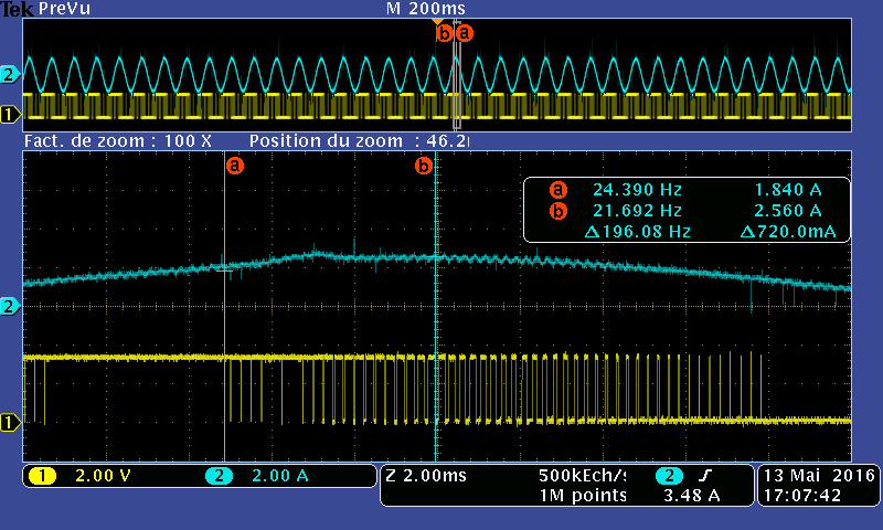

This capture show a zoom on a "normal" waveform.

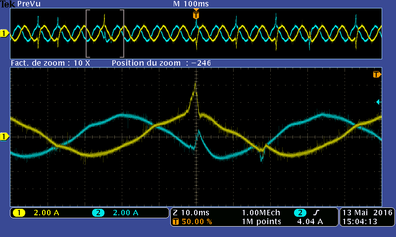

When I increase slightly the gMotorVars.OverModulation around the value 0.625 I can observe the same kind of spike on top of the phase V and W.
On the following capture, most of the spikes are on top of U phase (Channel 2 => Blue). Some spikes appears on top of V or W but less often (V phase => channel 1 => Yellow).
Because I suspect my custom hardware, I checked on the HvKit_rev1p1 and obtain the same behaviour with the kit.

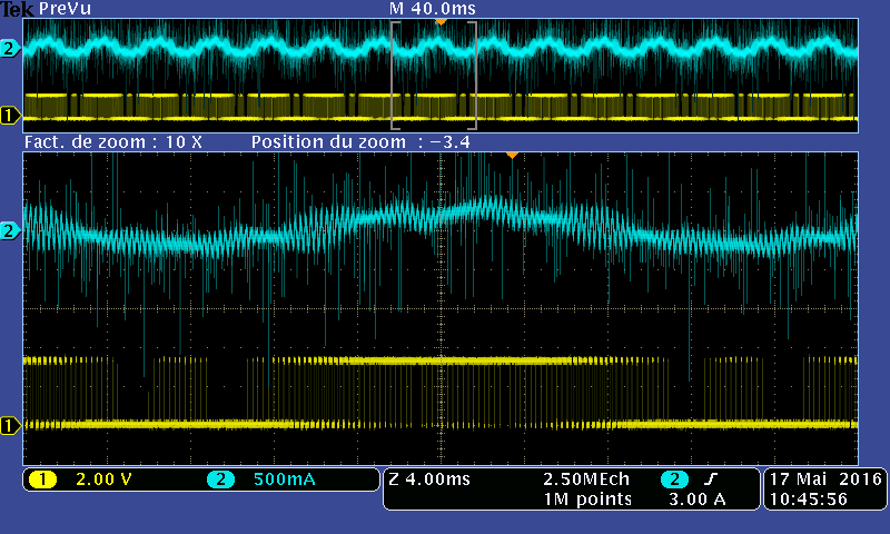

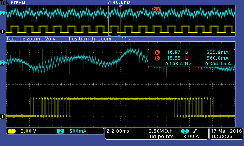

  • Chris,
    I found the same behavior with Motorware V14:
    I've install Motoware V14, make the change for my custom hardware and add the motor parameter.
    It's running fine (no acoustic noise) up to 1.19 in gMotorVars.OverModulation, but I still have large spike if I put 1.2 in gMotorVars.OverModulation.
    Channel 1 => PWMHU
    Channel 2 => Phase U Current
    With a value of 1.19 in gMotorVars.OverModulation even if there is no acoustic noise, I can see on the current waveform a very small overshoot with the same kind of pulse in the PWMHU signal.
    I can easily reproduce this on my configuration let me know if there is something else to check on that issue.

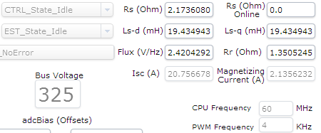

  • your rated flux is 3.75 V/Hz, but notice in the GUI you are only showing 2.42 V/Hz. Do you see the same when running the motor?
    You ID'd 2.13 A for magnetizing current. I would certainly lower to at least that level.
  • Hi Chris,
    Yes when the motor is running I see:
    - 2.12 V/Hz at nominal speed and light load.
    - 2.7 V/Hz at nominal speed and motor loaded near nominal electric power.
    I lower the magnetizing current to 2.13A as found during ID.

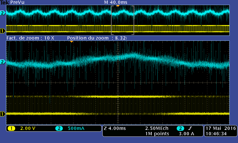

    I performed a test with the modified overmodulation algorithm of MotorWare 17.
    1/ When I compare MW15 Vs MW17 with Lab10a on the same test setup (TI HVkit + Motovario TBS80D4 ACIM on a DC power supply limited @80V 1Amp, this setup should be similar to what I did several month ago at the beginning of that post), but I cannot see a real difference between MW15 & MW17.
    I still have current spike with the same gMotorVars.OverModulation value (around 0.61 or 0.62).

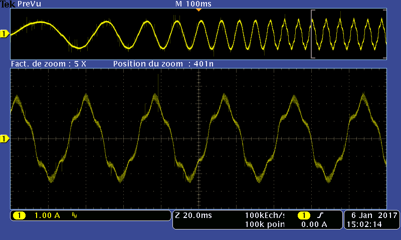

    2/ After several tests I discover that the Kp of PI Id / Iq current controller has a large impact on the current spikes I observe the ACIM output current.
    I'm able to push the overmodulation to the max value 0.6666, if Kp is small enough.
    In the following waveform, this is one phase current on the ACIM at startup. The low speed is in full sinus mode and and the end of the waveform the system works in 0.6666 overmodulation range.
    My question to TI InstaSpin dev team is about the workaround I did:
    Is it possible that the current regulator Kp (I just used the automatically compute value with the labs) is to high in overmodulation range?
    Did you observe or reproduce the same behavior on your side?
    Any other idea on that issue?
    Paul
  • Paul,
    timely, I was just replying to the private message you sent me. Your fix by decreasing the current control gains is correct.
    We confirmed MW17 OVM by using HV_Kit and ACIM and had good results. We have two pieces of guidance for OVM.
    1)      Decreasing current PI gains about half and below. Some current distortions at OVM range can be seen even with the new OVM (it depends on motor’s characteristic) and it can make the current controller unstable. So decreased current gains will help system’s stability.
    2)      PWM and the control frequency have to be same for getting the right trig point with HAL_setTrigger(). In other words, USER_NUM_PWM_TICKS_PER_ISR_TICK  should be (1) for OVM mode..
