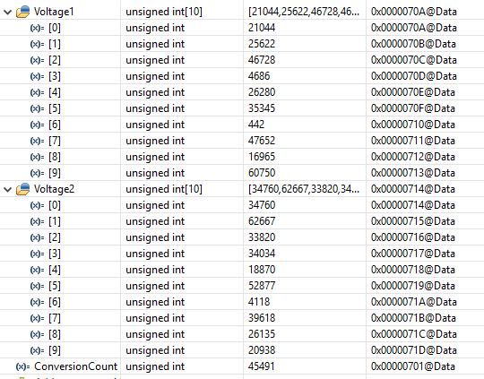

I have asked sevel times this question but haven't got satisfying reply....
I am using simple example of ADC_SOC  for ADC conversion. I have to use value of ADc that is read by MCU for external purpose by the help of if statement. as the value is being stored in  AdcResult.ADCRESULT1 which is then stored in voltage1[conversioncount] which is array. How to access the value of ADC as variables for further use in if statement. I have tried in many ways but the error 'statemenet unreachable' is written.
I have merged ADc_SOC and HRPWM example and with the specific value of ADc i will generate specific PWM. After merging both examples, AdcResult.RESULT1 is showing some problem. At the side bar occurence with silver indication is written on it.
The example is given below with the highlighted error points...

  • Tommy,
    I have removed return statement now there si no erroe with the building in program. But value of ADC is not being read poperly. I am using simple examples of SOC_ADC. And I have changed the EPWM1 to EPWM2 as I will be using EPWM1 for my application. The values read by Voltage1 and Voltage2 is given as:
    Can you verify that the original, unmodified adc_soc example works?
    Did you change the ADC trigger source from EPWM1 to EPWM2? Please see the TRM if you require technical details.
    The original example is working well. Just after replacing Epwm2 with EPwm 1, the results are not proper.
  • The TRIGSEL had also to be changed to properly configure trigerring selection. I have resolved that problem.
